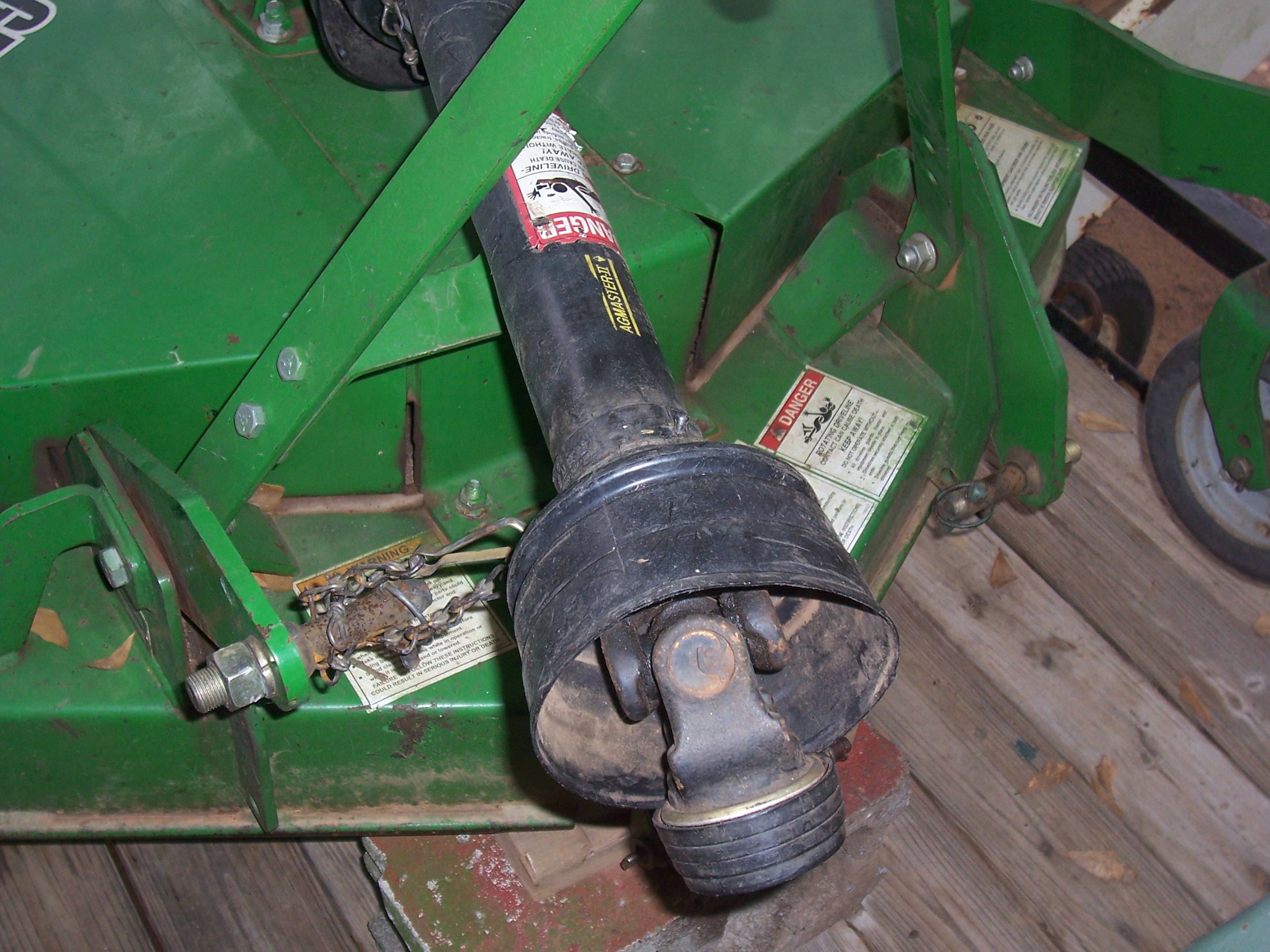

I been using a 5Ft. JD. FM for over 5yrs with a Ym2000 and never had a problem. I just pulled out the owners manual from curiousity to see if there is Shear Pin. Nope? I do Have one on a new to me Bush Hog thats located were the Dr.shaft and Gear Box connect. That is a Large Bolt. I would think it to be rather difficult to break that with a FM. Something don't seem right?

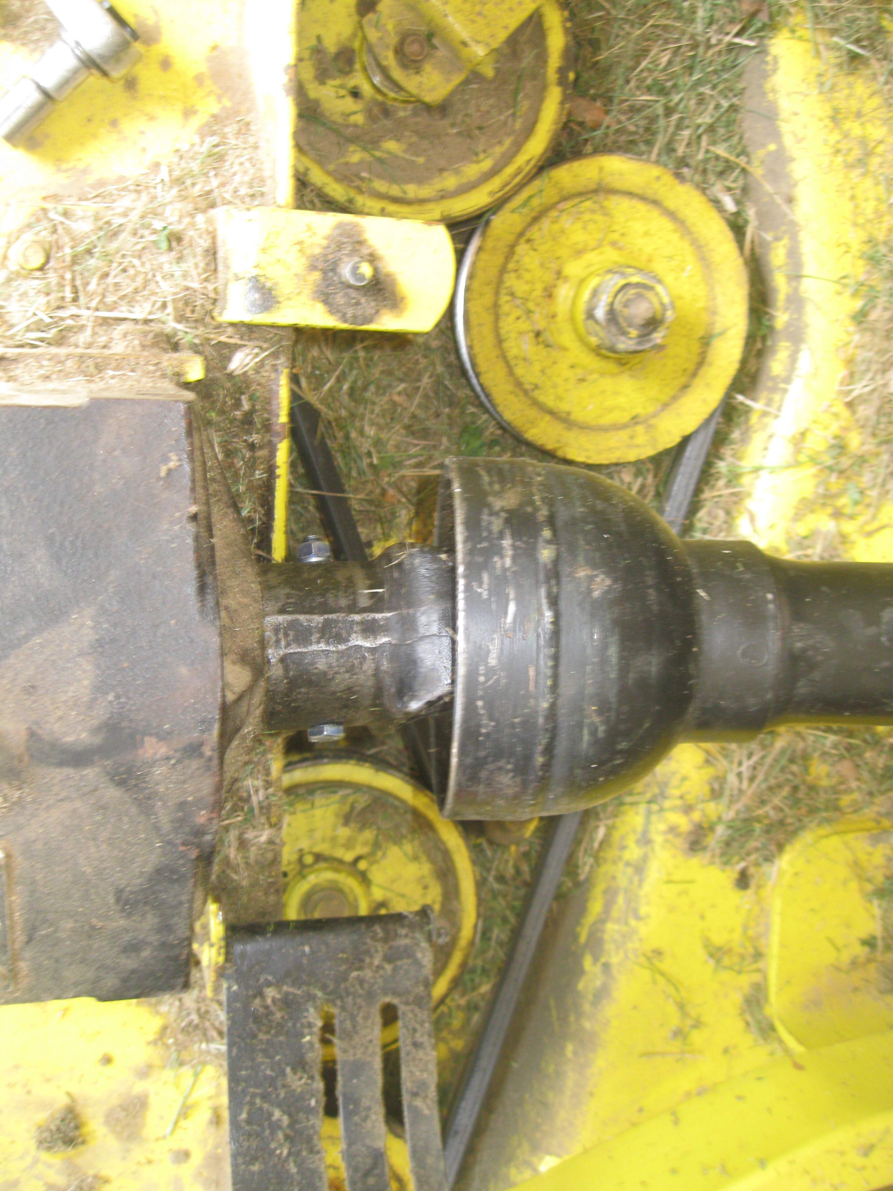

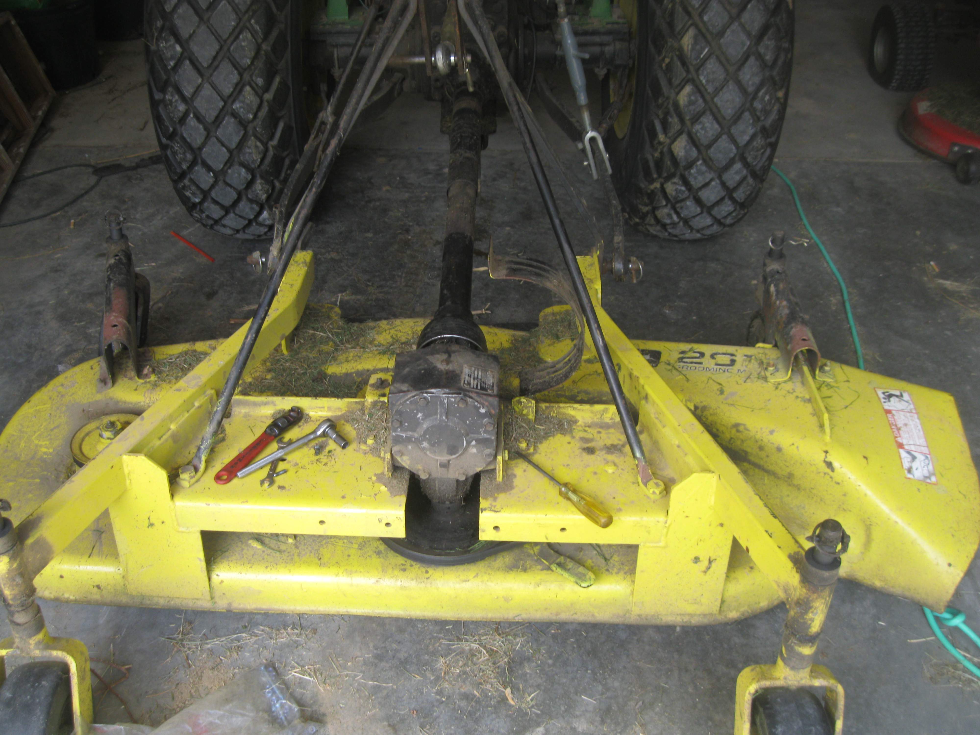

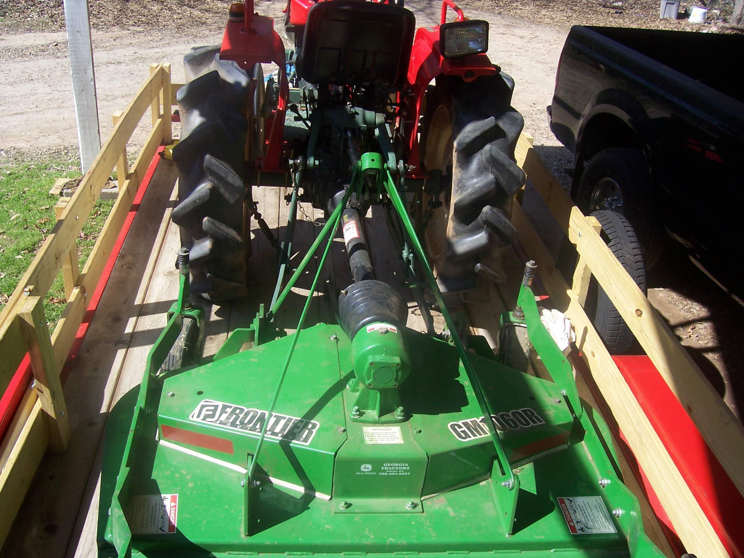

The mower is a JD 261 Grooming Mower, not a finish mower like I stated earlier, my bad. The shear pin breaks occur when I'm mowing and engage the clutch at normal cutting speed and release it without throttling down first and slowly re-engaging the clutch. It most often happens when I try to maintain my position on a hill by using the clutch rather than the brakes or when cutting in tight areas when I use the clutch rather than the throttle to slow down when turning. This is the first time I've used a tractor with a manual clutch and standard transmission so it may be user error, it may be that I'm releasing the clutch too fast and also that I shouldn't use the clutch for either of these circumstances. The mower belt and blades move freely and the belt does not appear to be too tight. I use the 540 rpm pto setting for mowing. The shear pin bolt is small, it's 1/4''x 2.5''. Thanks for all the great suggestion, it's not a huge deal and it is happening less often as I get more familiar with using it.

/ Breaking shear pins on my mower #13
you dont want to use your clutch to slow your progression or to do anything other than stop. That putting way to much wear on it and will cause it to fail earlier.
What you should do is use the foot throttle. WHen i am changing speed frequently or turning and want to vary my speed i will set the hand throttle at the slowest that i want to go, say in the turns, i will set it that speed. Then i will use the foot throttle to speed up inbetween the points i want to slow, once i take my foot off the throttle it will slow to the perfect speed for the turn or just my predetermined slow speed. I only clutch a few times a session. TO start out and to change gears then each time i get off, in bwtween i just vary my speed with the throttle which is what you want to do.

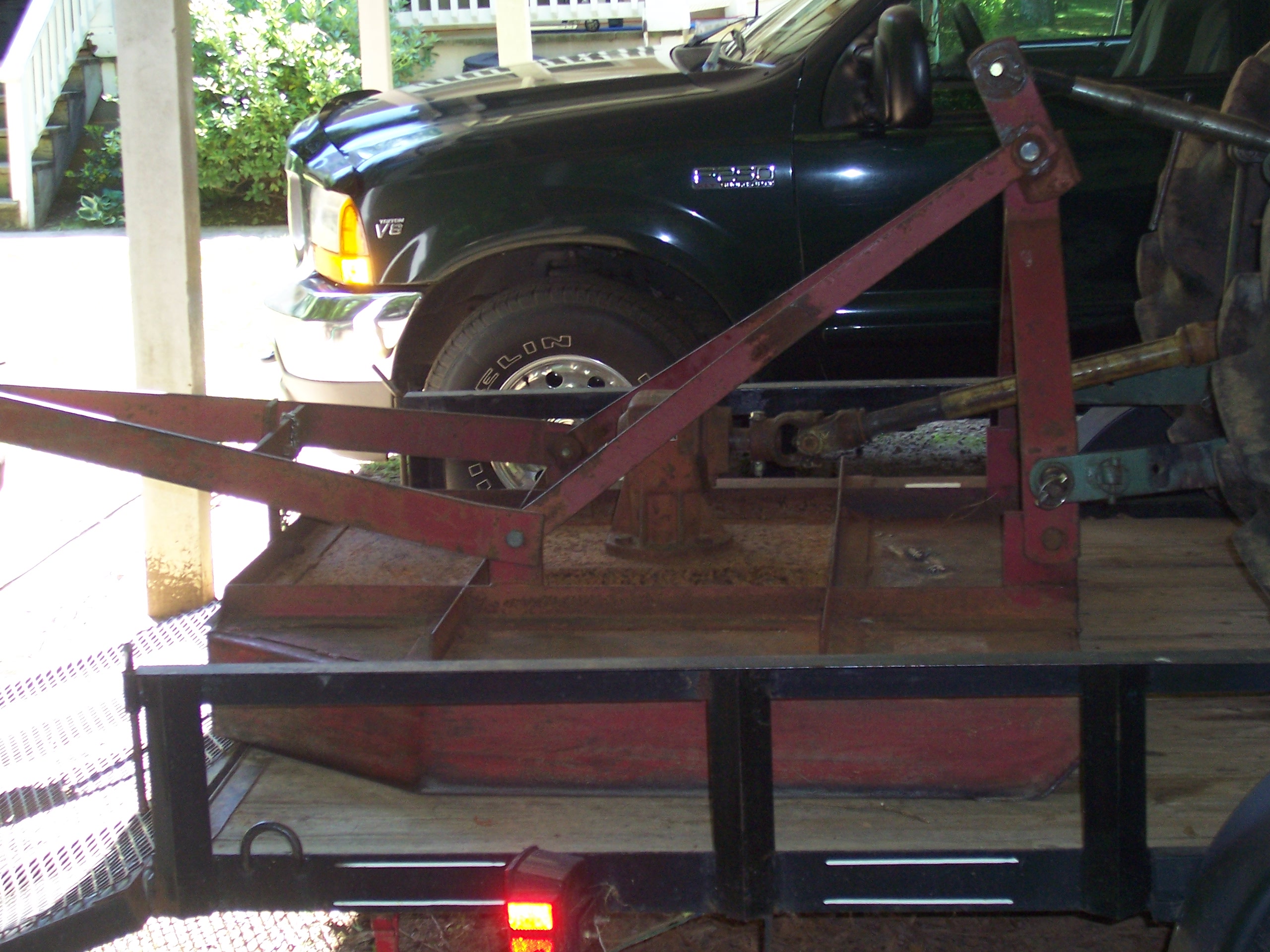

Cardoc that mower in the pic looks very similar to the one my friend had that he just traded away. He told me i could ahve it but i did not want to weld on it and he really called it junk. He said every time that it got the silightest amount of tall grass it would break #2, and 5's. He finially put 8s in it and it would work. I cringed when he told me that but its his stuff. I dont think he had used it in like 5 years he now mows with a BH rear discharge 720. He uses whatever is factory in it and no problem, i think JD has a design flaw in that thing?
