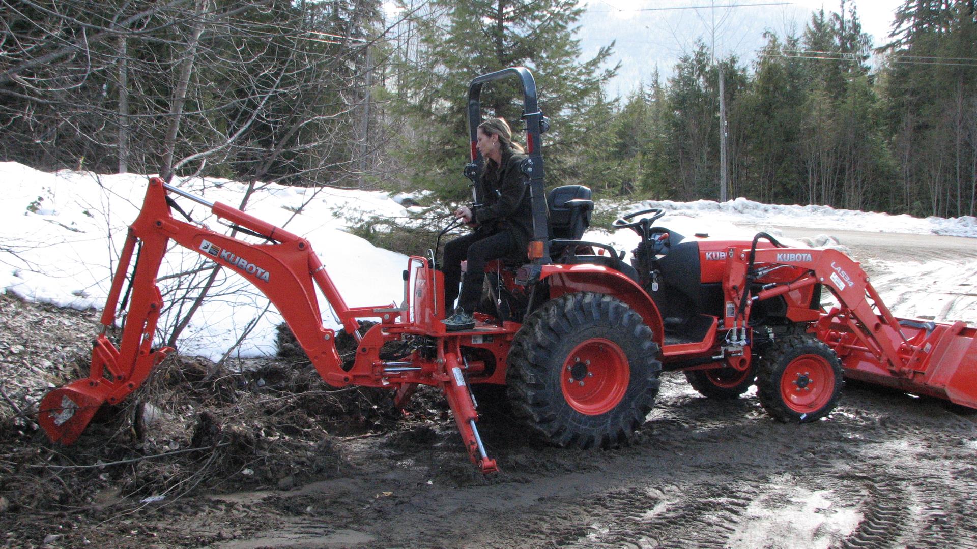

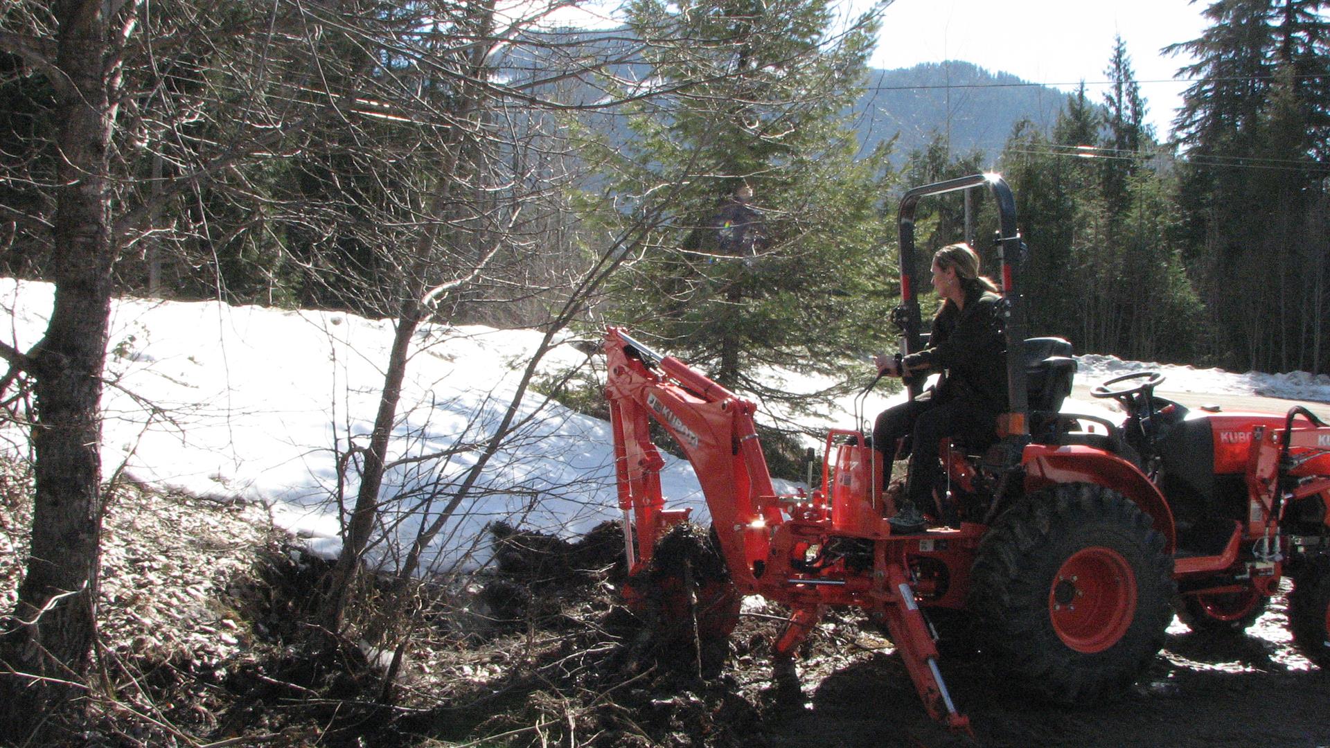

Here are a couple pics of the new machine...
I had the wife try it out... might not get to use it anymore... lol

Lol... I will be on the little John Deere 425 with the wagon getting rid of the trees... lol
Sure did a number on the 2 little Cottonwoods. I think I will be getting a lot of use out this one.
Been running the rpm's about 2000ish when using the hoe and seems pretty good. If anyone else has experience on close to the same machine always appreciate anything else to watch out for.
