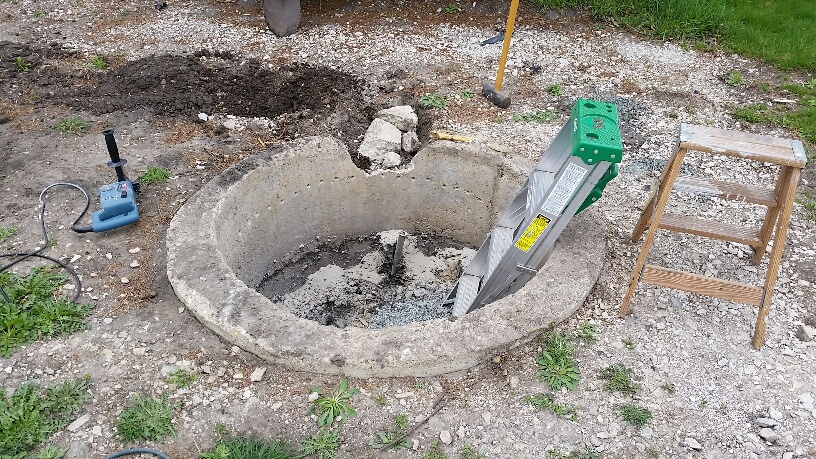

I have an update.
I drilled a few holes in the thinnest area of the tile and hit it with an 8lb sledge. 4 whacks and I had an opening.
Then I dug around it with the loader, drilled a few more holes and swung the big hammer some more. I was using a 1/2" bit that is 3" long. I quit drilling holes when I got into the thick stuff. But I kept swinging the sledge.
After 3 hours, a lot of heavy breathing and a few breaks, it is done!
We knew you could do it. If you had an 13 lb sledge, it would have been even easier. Good job.
   / Breaking Concrete #44
Nice job and thank you for assuring the well was plugged properly. To many are not and they can create a real hazard.
