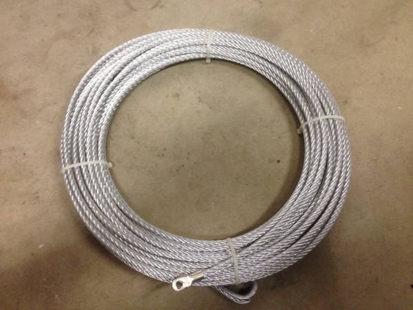

I need to attach a terminal lug to the end of a new 1/2" winch cable and the end result should be as pictured. Any concerns with brazing the lug on with a brass rod? Can I just use my cutting torch (sans blast) to heat it up without damaging the cable? It has been 35 years since I last brazed so I won't be insulted with the basics. Thanks.

Why not just crimp it on like in the photo. Depending on the amount of force being exerted on it, that should work. I think if I were to try brazing, I would use silver solder to do it rather than brass. I think it would adhere better to the SS cable.

Crimpers for this size lugs AWG 4/0 run over $100, based on my research simply crushing the lug with a vise or hammer does not provide a reliable connection.

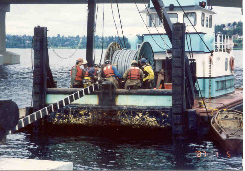

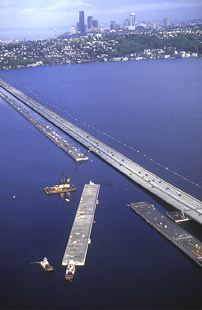

I've been involved in putting eyes on wire rope. But the wire rope was 3-inches in diameter. We slide the eye on the wire rope. Unwrapped the strands of the wire rope. Had a mold that went around the wire rope. Then we poured an epoxy resin in the mold. This was for the anchor wires on floating bridges.
I'm sure you know those are called spelter sockets, and can be zinc, babbit or epoxy. I grabbed one that Ben at Sunnen Crane in Tacoma had just poured, you don't want to do that.

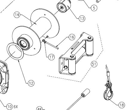

I get that. But I doubt that that lug is the correct one. In fact, I doubt that the end connection is even simply bolted. My money is that there is a socket and a couple of set screws. Have a pic of the drum?
The cable pictured is stock WARN engineering, I believe they have been in business long enough to have developed a suitable solution. The cable I have is aftermarket and did not come with eyelet, I was hoping for some advise on an alternate solution to crimping an eye on the cable.

Your not going to braze it, not stainless. Silver solder your best bet. I wouldnt hesitate to crimp it if it was mine, your not going to winch anything with just the lug bolted to the drum. I have used winch drums where the cable had a UBolt to hold the first wrap and had it pull out under load. The number of wraps will determine how much you can winch, not the lug or how its attached.
