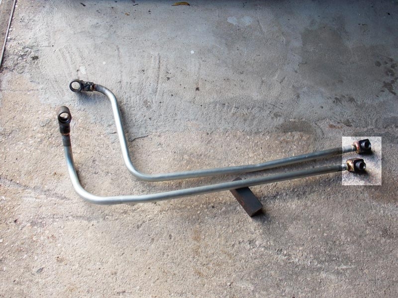

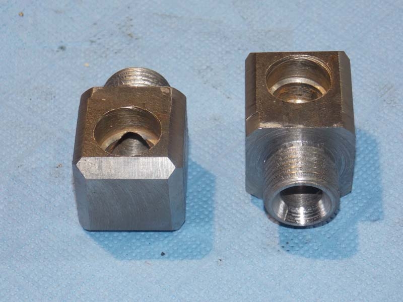

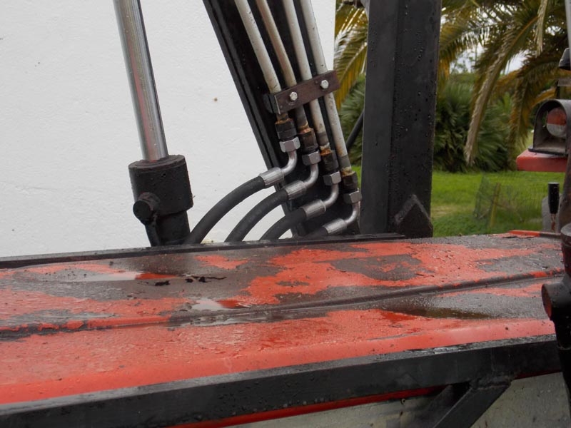

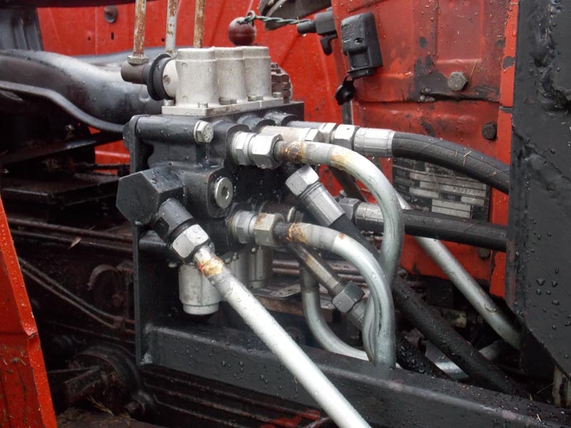

I brazed many hydraulic fittings on my tractor; mostly I made the fittings to be brazed.
I use oxygen / propane.
The torch has a big cutting head which can be swapped for smaller tips for welding and brazing.
