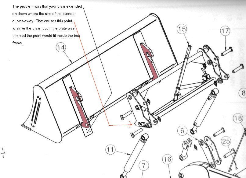

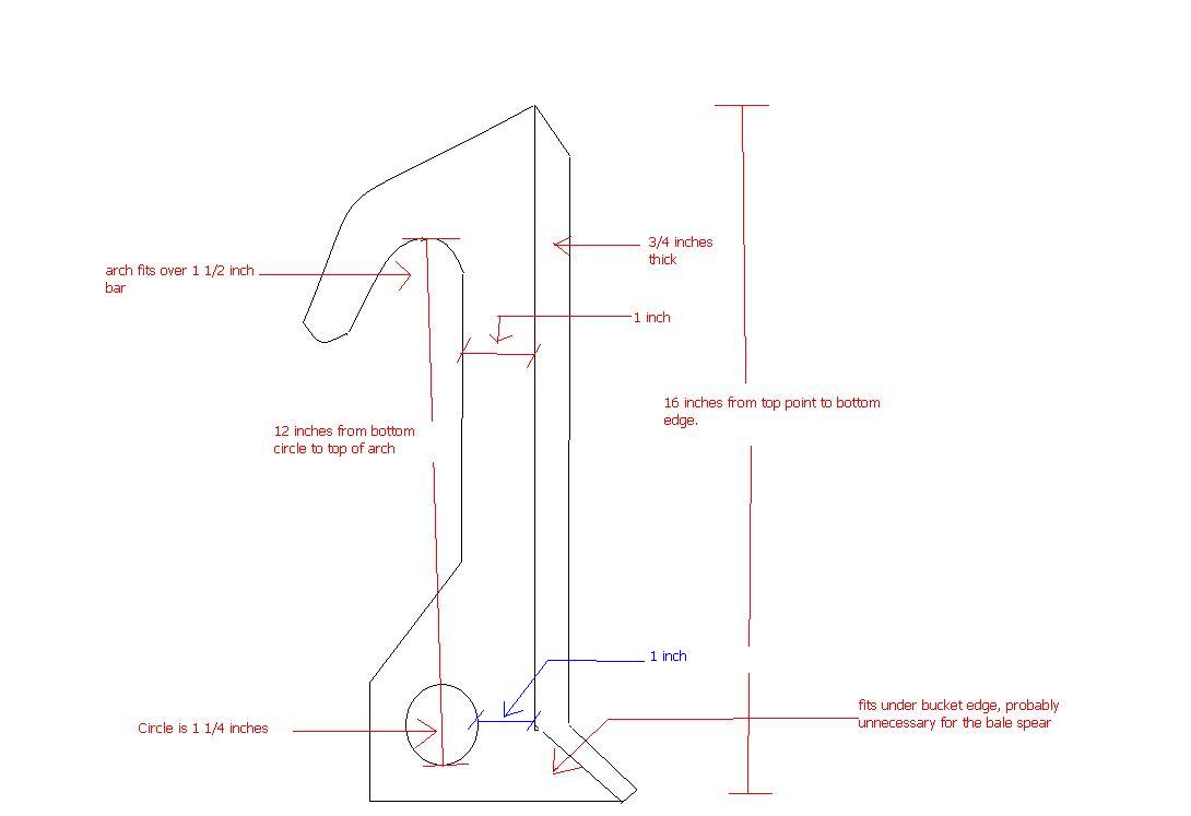

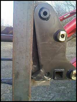

Saul,
Here's the info used and some photos. It'll be WAY more info than you'll ever need but if you start with the fel bracket sketch you'll see the dimensions of the bracket needed for a Branson attachment. The FEL quick attach 2 shows the problem we worked thru. Basically, the welder built a frame out of 2 inch box metal, then attached the fabricated brackets--but instead of welding the brackets directly to the box metal frame, he welded them onto a flat plate about 4 inches wide and then welded THAT onto the box frame. That meant the lower points of the fel attachment hit the flat plate (see bale spear 5). All that was required was to cut the flat plate back even with the box frame and it all fit.
Ken

So, it is still a Euro connector, but it now fits a Euro implement.
Seems it would have been better to change it out for a skid steer style one and save on all future implements - or have a welder make up a Euro implement to Skid Steer connector "converter" so you could use BOTH types.
