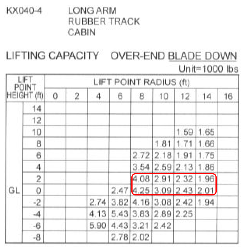

Lift capacity depends heavily on the geometry. In particular, the further out the centre of mass of your load is, the lower the actual capacity. If your cinder blocks were centred 2-3 feet out from the QA face, I'd expect a significant decrease vs the rated capacity.

I poked around the BL200 loader manual (I think the 5520 uses that as well as my 4225 does) hoping for a lift capacity by lift height and distance-to-pivot-point chart, but I couldn't find one there. I think that's an oversight; this information should be shared with operators.
As an illustrative example, here's the corresponding chart for my KX040 mini-excavator. Of course, the boom geometry and overall dimensions are different from a tractor loader, but the underlying physics is the same. You can see how the lift capacity gets tremendously reduced as you move the load further out.
