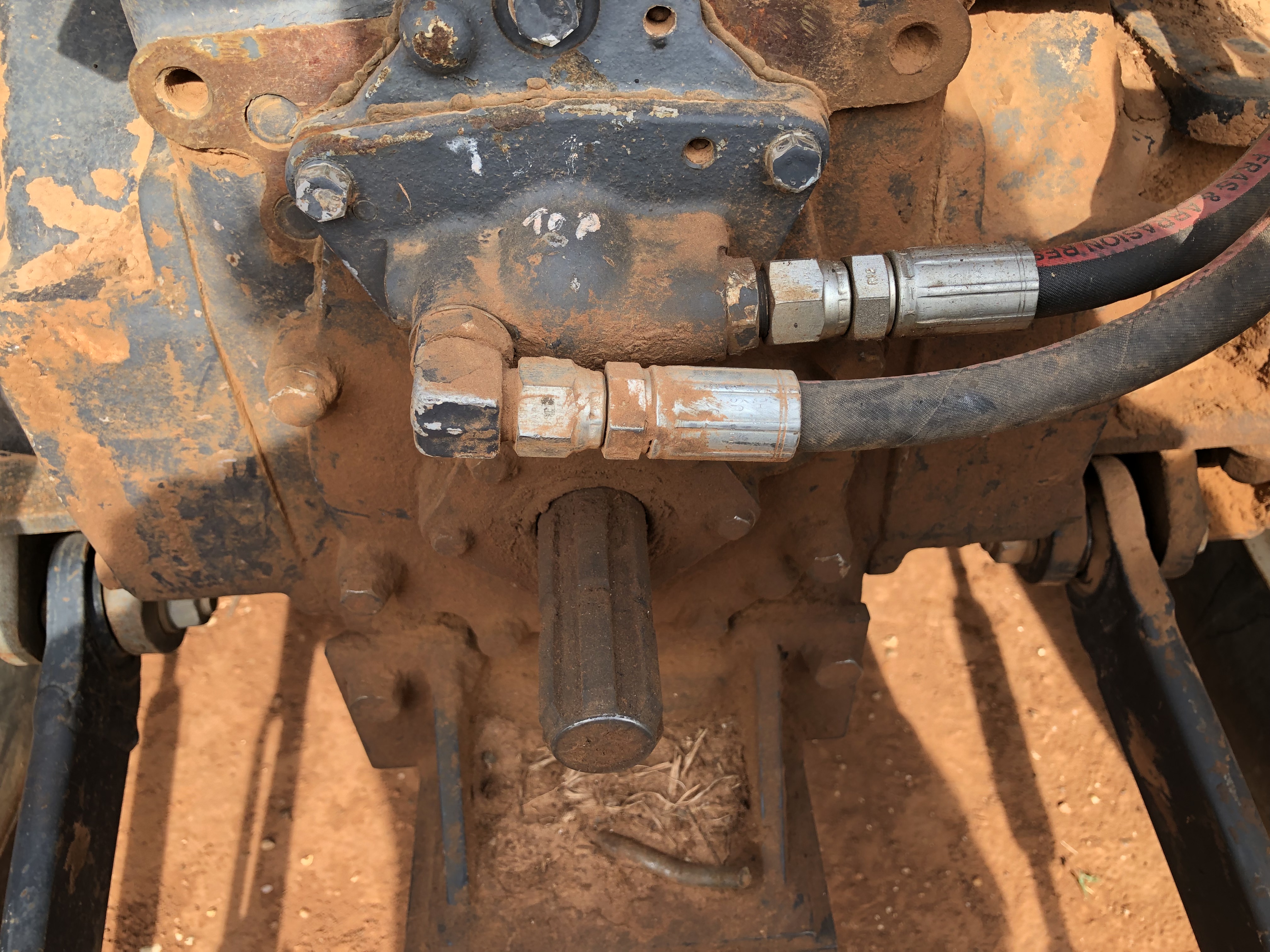

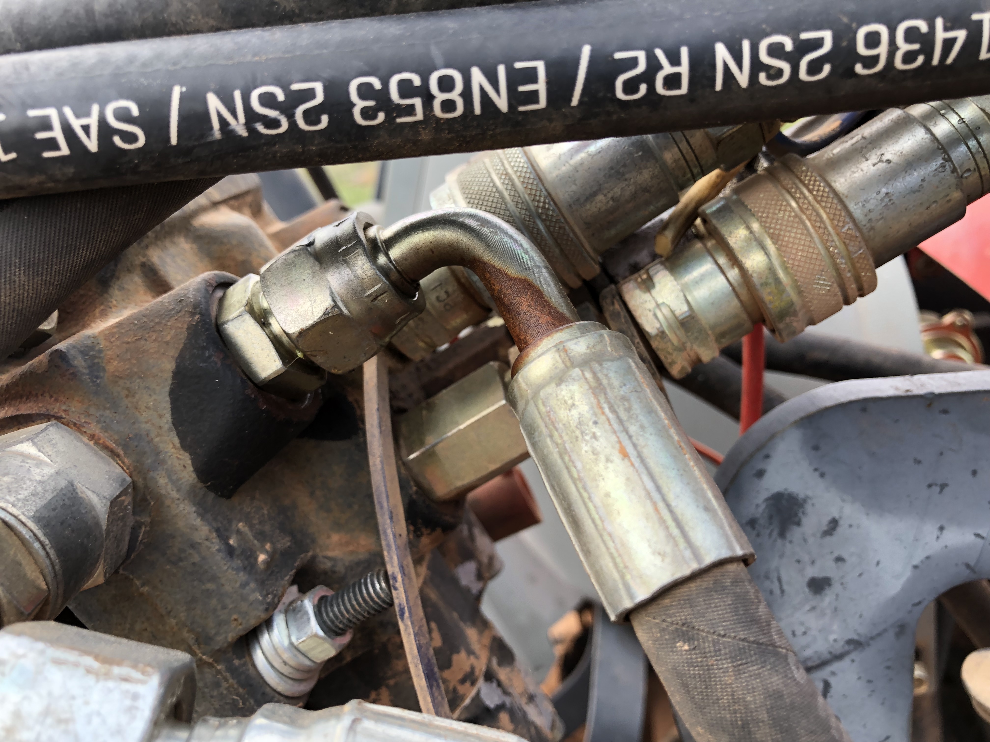

Sorry behind in posting, eye doesn't seem to want to heal,so please forgive mistakes.View attachment 618295View attachment 618295 POWER BEYOND TANK RIGHT SIDE UP DOWN BOOM.JPG

Hydraulic Hose connections NOW: (1) High Side from (New) Gear Pump to Power side joy stick control valve. (2) Tank Hose from Joy Stick Control Valve to Tank. (3) Power Beyond on Joy Stick to Return UNDER SEAT. Hoses to Boom and bucket disconnected to isolate and try 3point as you suggested, I can push arms down by hand. I had diverter connected as follows( hoses from joy stick control that is coming from left side of control that controls tilt and curl into P1 and P2). Hoses from Bucket connected to Diverter Ports C1 and C4. And Hoses Connected to Thumb Hoses on Diverter C2 and C3. !2 Volt wiring connected to fuel shut off solenoid, so that it was no when tractor was running and disengaged when motor turned off. I am going to cool at filters and strainer again, could be trash was at bottom of tank and now has go to system again? Will be awhile don't know when dr. will ok lifting or laying head down. Thank You.
