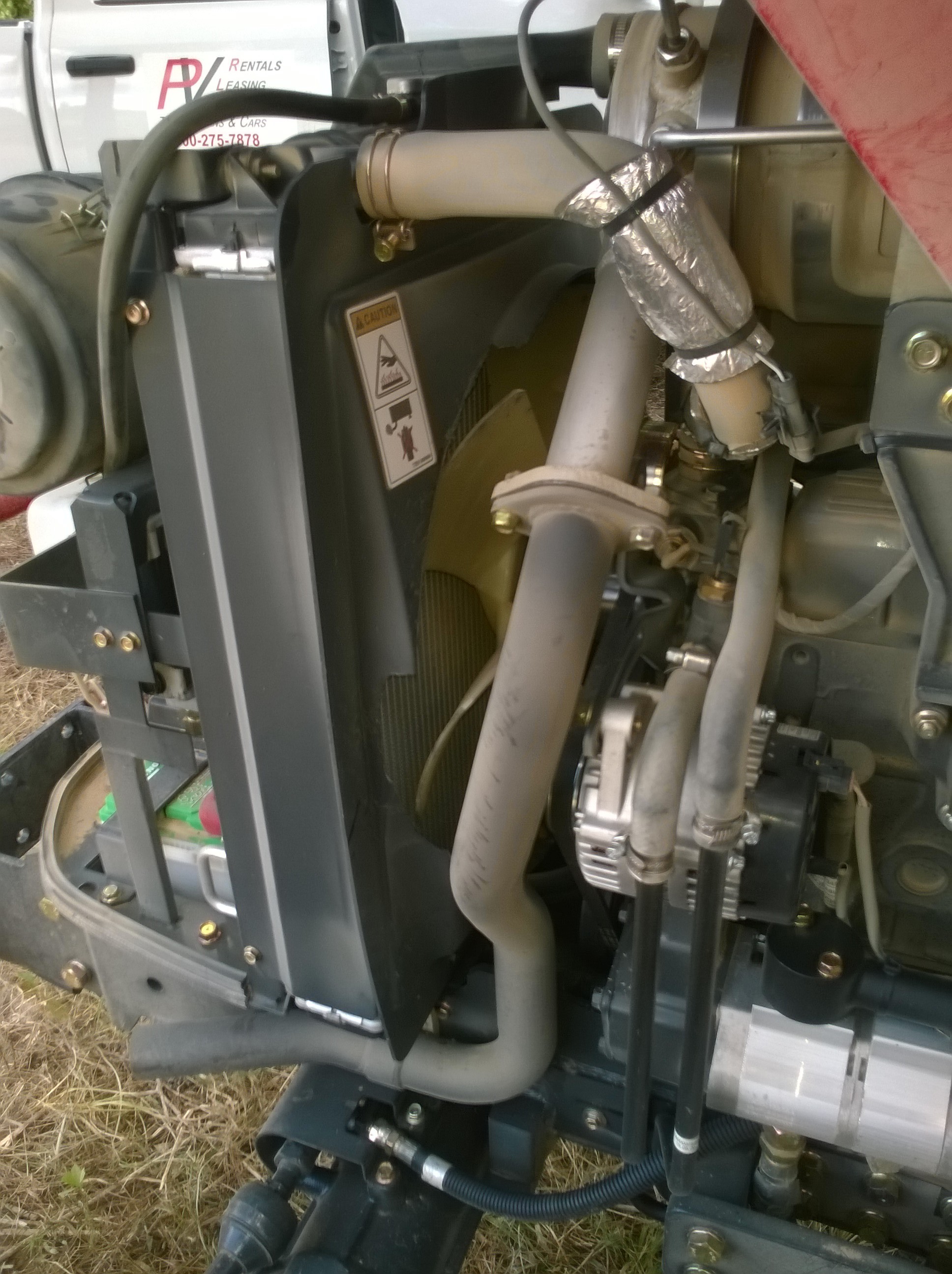

My 2016 4720Ch did the same thing. I am concerned, but service dealer is so far away, I would rather fix it my self. My problem is all parts dealers are useless, can't get a call back from anyone to get parts. Anyone having luck ordering parts from a specific dealer?
/ Branson 4720 fan shroud #6
Text me (701)214-8403. I'll get you parts
Mr. Bitz
If that isn't the twin to mine it sure did miss it's calling. Looks exactly like that.
