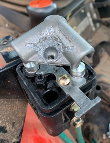

So, I was out moving dirt with my FEL and the joystick came off in my hand. Completely disconnected, just hanging on by the boot. I managed to move the bucket enough to be able to drive the tractor back to the house and started looking to see what was wrong.
I pulled the cover and the boot and found this:
The piece of pot metal crap that they are using for the joystick valve selector broke off where the stick was attached.
Branson doesn't sell the part but they do have the whole joystick assembly for about $500.00. That's ridiculous so I did some research and found this on ebay and took a chance:
Too late, I found this which is the only part I needed:
But I can't complain since I saved over $400.00 anyway. Works great!
So here's what I did to change it out;
  • Repair_joystick.pdf

Thanks for the detailed photos and description. I was expecting to see 4... "slots?" for the 4 functions. It didn't occur to me that because we're only dealing with 2 planes (left-right, forward-backward) that you can kills 2 birds with 1 stone on the functions. From your photo it now makes sense to me because there are times where I'm feeling around for the proper function and I wonder if I'm in the right spot. In other words sometimes when I'm feeling for 6 o'clock (raise loader) I'm not sure if I'm in 6 o'clock or 9 o'clock (curl). This is usually when I'm operating the loader controls from outside the operator station (I know, I know). At those times it sometimes feels like it's in 7:30 position.
/ Branson 4520C Joystick Repair #4
I should probably lube that triangle piece periodically, and maybe get one as a spare since they are hard to find.
