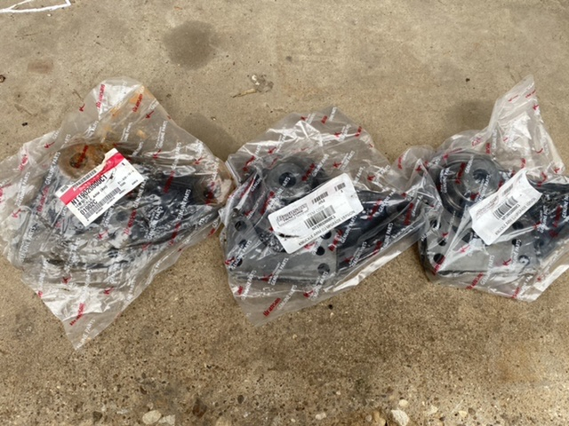

Project still on hold. I finally talked the parts guy into opening another tie rod upgrade kit and send me the right side knuckle arm. I received it and went to install today and low and behold it is a left side in a right side package. I now have a total of 3 left side knuckle arms and 0 right hand.
We are back in the cycle of waiting on him to get with Branson on Tuesday so they can reimburse him to reimburse me. Lol
At least the part number was correct so at least there is progress.

How about just turning the left knuckle upside down for the right side? LOL Don't you wish it were that easy?

Thanks jjeff I am trying my best to keep the mods to a minimum but very well may be the only option I have.
FastEddie, I sure do wish it was that easy.
The latest update is Branson is sending UPS to pickup the knuckle arm that was packaged wrong and when the correct one is back in stock they will send it to me. I have my doubts but I will give them a chance before I send it all back and try a different way.

Well Branson finally sent a label for me to send back the wrong part. It has only taken a couple weeks to get a label. I will be 90 before the actual part arrives. Lol Anyway I took the old knuckle arm to a machine shop to resize and taper the hole. That way I can continue going back together and change it later if a new one ever arrives.

I have sorted out the steering issues. I still have not received the right hand knuckle arm but I was able to have the original one resized to work with the updated tie rod end.
