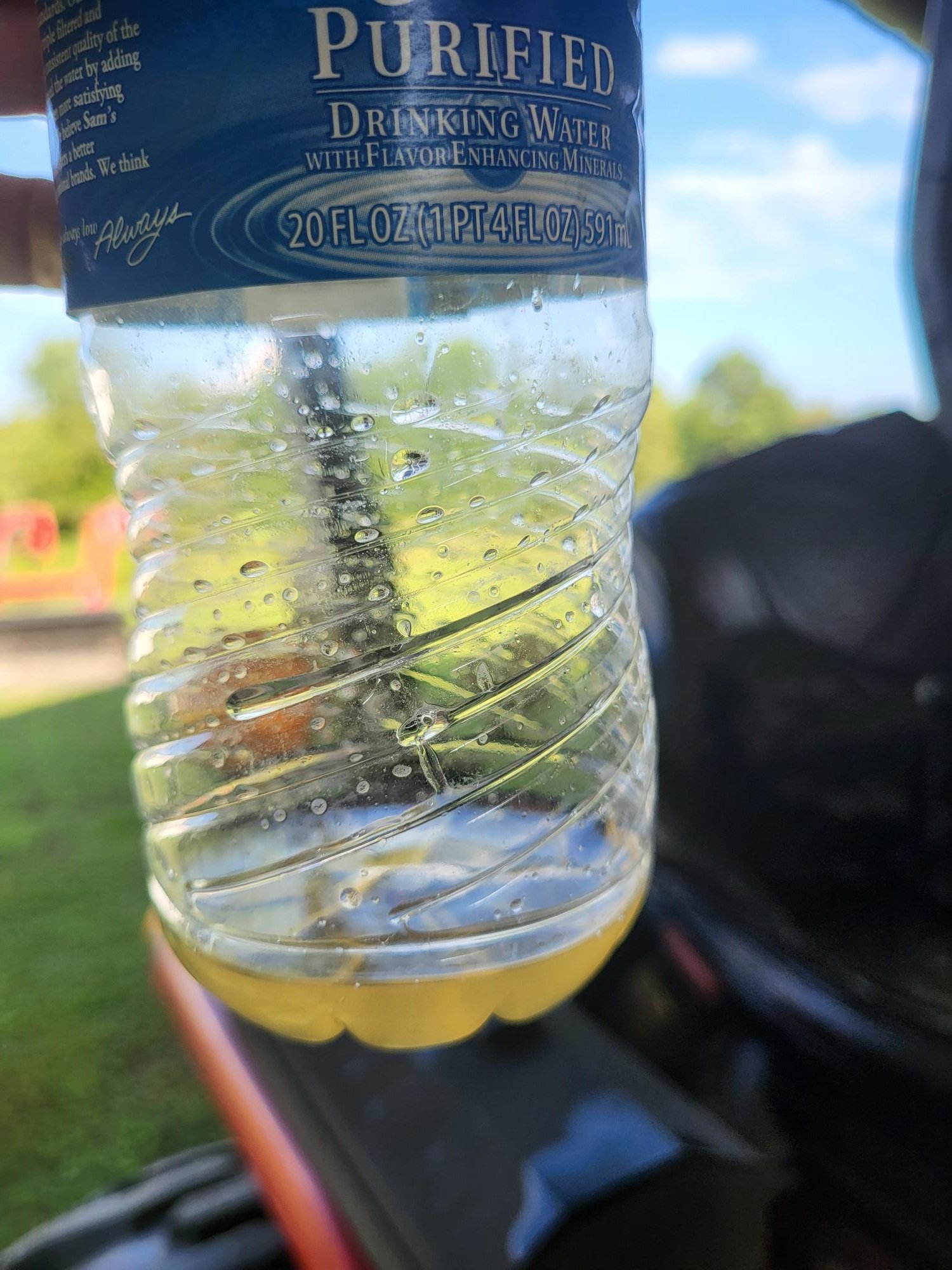

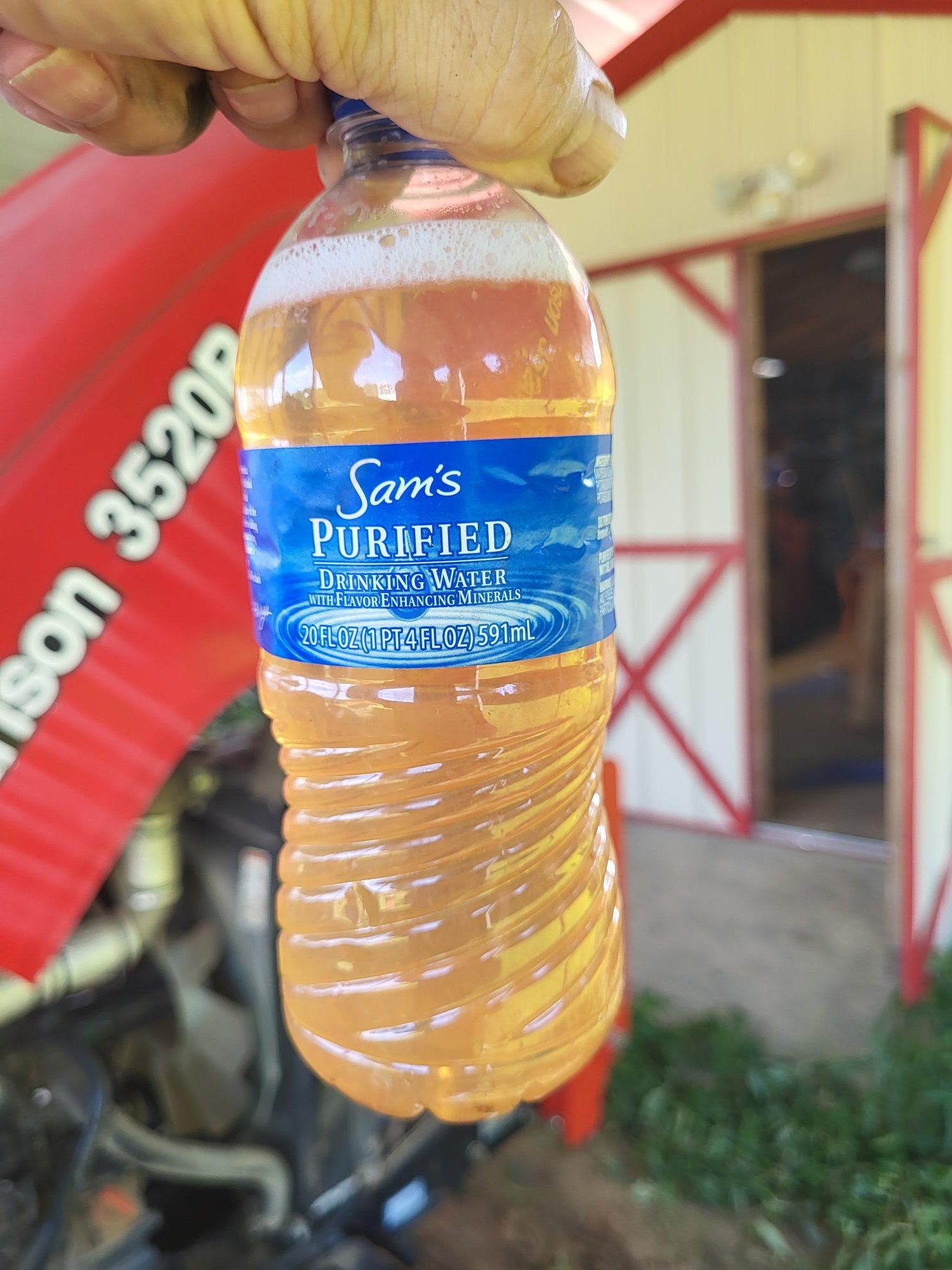

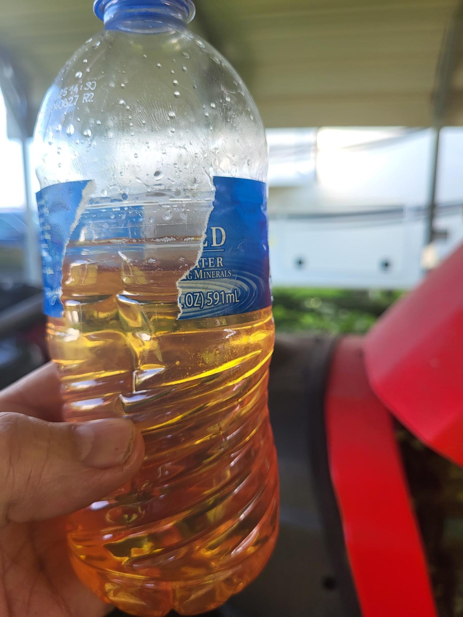

   / Branson 3520r power loss
#13
follow up , after replaced pump , still no power- finally got a chance to troubleshoot it, all pics was flow rate for 15seconds 1st pic is before filter , 2nd pic is going through filter and third is with no filter in it, problem I believe problem is filter, order new one same as original online be here Tuesday hope it fixes it, got 14 acres to mow.

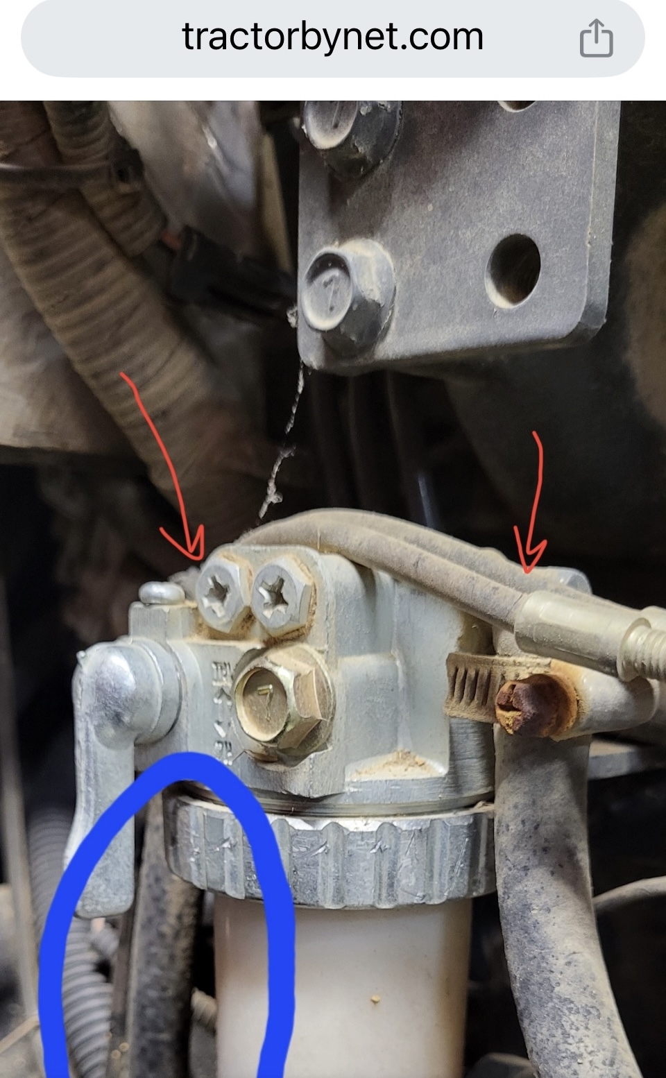

   / Branson 3520r power loss #14
Some of those housing had an inlet screen built into them. You may have some garbage in the inlet of the housing.
   / Branson 3520r power loss #15
I removed my OEM filter assembly on my 3520 - same as your picture- because the hose fitting was leaking and after examination I discovered that the hose fittings were only glued into the housing. So I replaced it with a clear inline auto type. Additionally, the OEM fuel pump has tight tolerances and my pump stopped due to a tiny spec of debris- so I installed the same clear inline auto filter before the pump and haven’t had a problem since.
