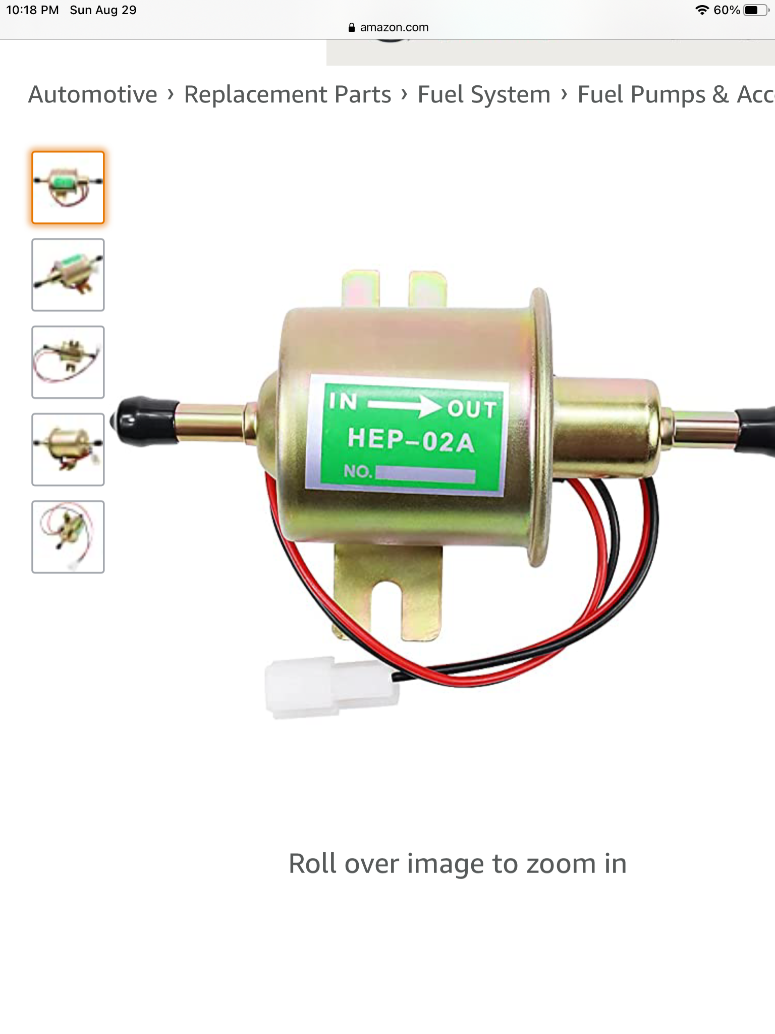

I also have an older 3510 (2004) when my pump died I replaced it with a hep-02a fuel pump, (they are not expensive probably $15) that was several years ago.
I agree with you on the crazy high prices for Branson parts, I‘m about $1200 into hydraulic gear and pump replacement on mine right now.
Mike
/ Branson 3510 fuel pump advice #12
Mike
Mike, nice find! they are only 12.00 on Ebay
