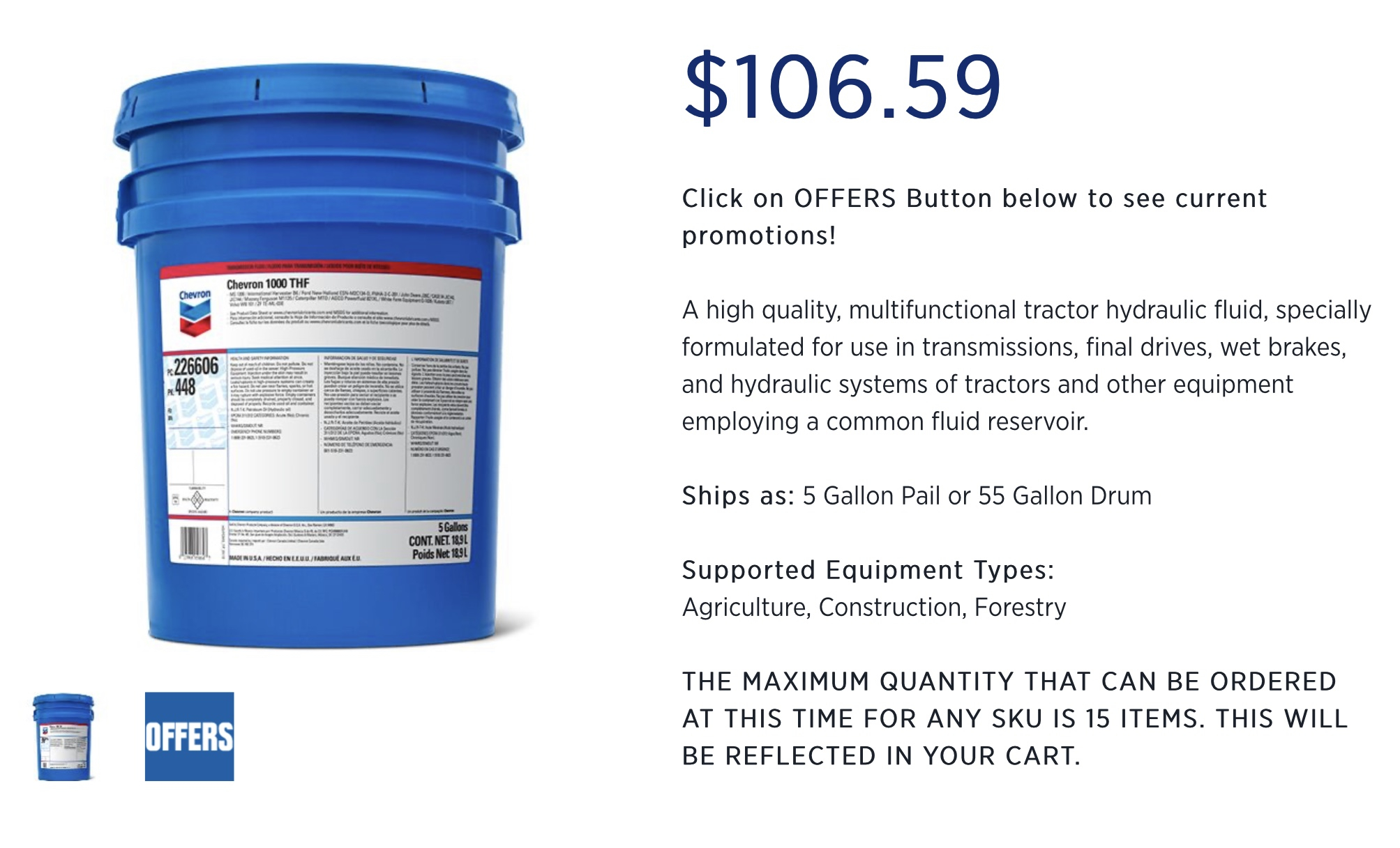

I use a synthetic engine oil, and I don't recall what hydro oil was put in last time. I think this time I'm either going with the premium Napa or the cold temp rated Chevron stuff.
