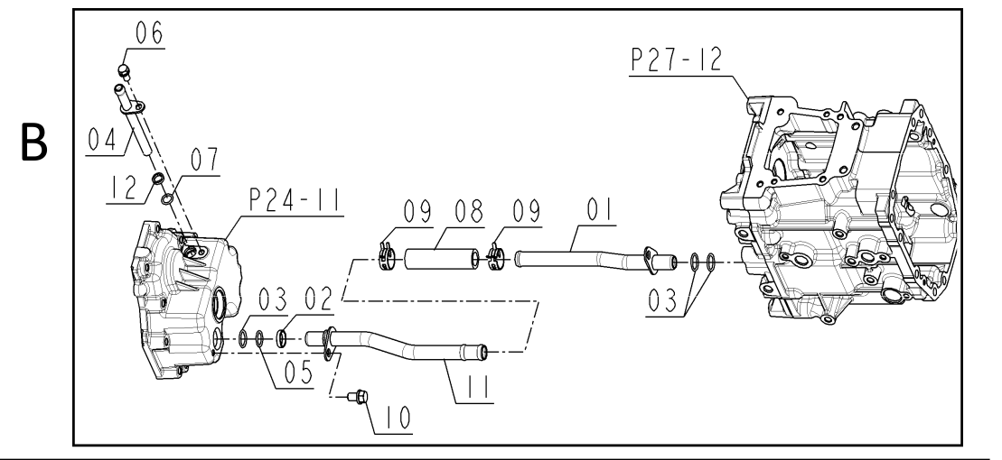

Found the leak underneath, it was probably, as K5lwq said, caused by something striking it. It steel line connection to transfer case. What a bugger to get to. I loosened the bolt and am going to put some sealant and hope for the best.

John, glad you found the leak but I am curious about that line. Do you have a picture of where the leak is coming from? Also, when you say sealant are you talking thread sealer?
/ Branson 2800H Hyd leaks
K5lwq,
Here is a picture from the parts breakdown. It at the left end of pipe (11) right around the flange. The loosened bolt (10) and I can wiggle the pipe. I plan on lightly prying on the flange and putting RTV at the connection. I will let it seal for awhile and then try it out. If it still leaks I will have to remove rubber hose (8) to remove the tube to investigate further.
/ Branson 2800H Hyd leaks #11
RTV on the outside is unlikely to fix it but it won't hurt to try. If you can clean all the oil off with solvent first that will help.
From the the diagram it looks like there are two o-rings and seal or spacer on the pipe. Which is kind of unusual. But I bet they need replacing.
This is what I was thinking.

Update: The front hyd leak was definitely the front hub seals. Replaced and all good. The RTV is holding good on the supply line so far. No spots under tractor!!! Good day.
