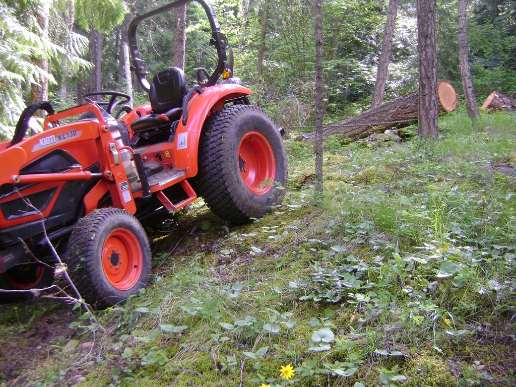

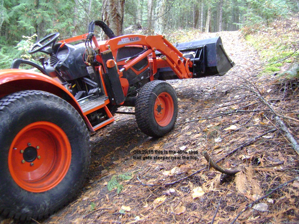

Living on the side of a mountain I often find myself stopping on a grade requiring using the pedal lock.
Always feels like it positively locks and never had a problem.
It does make you think though if you are working around it. Has the HST so I cant leave it in gear but shut off there is always resistance keeping it from free-wheeling.

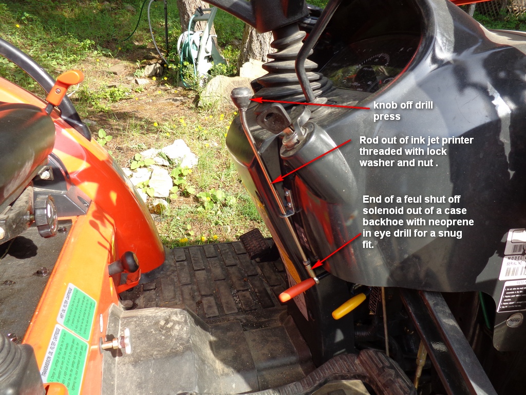

For ease of use I made this mod no bending over which is not convenient for something used dozens of times a day.

Tractors and hills make me nervous to, so when on a bank I always set FEL down fully on ground, plus I also have a pto winch, I always set that down but thats only good to stop rolling backwards which is very important, and then if I'm not climbing right back on I also set the brakes. So between FEL, brakes and pto winch my tractor is staying put while running, then if I shut the tractor off in gear that makes 4 things holding.
   / Brake pedal lock ever fail? #5
You'll never be sorry for being care full Oldpath05 . One other thing I do is turn the steering wheel so if it does roll it will come up against the nearest tree. If I have some thing I wish to do on the down hill side of the tractor I'll stick a rock in front of the wheel.
