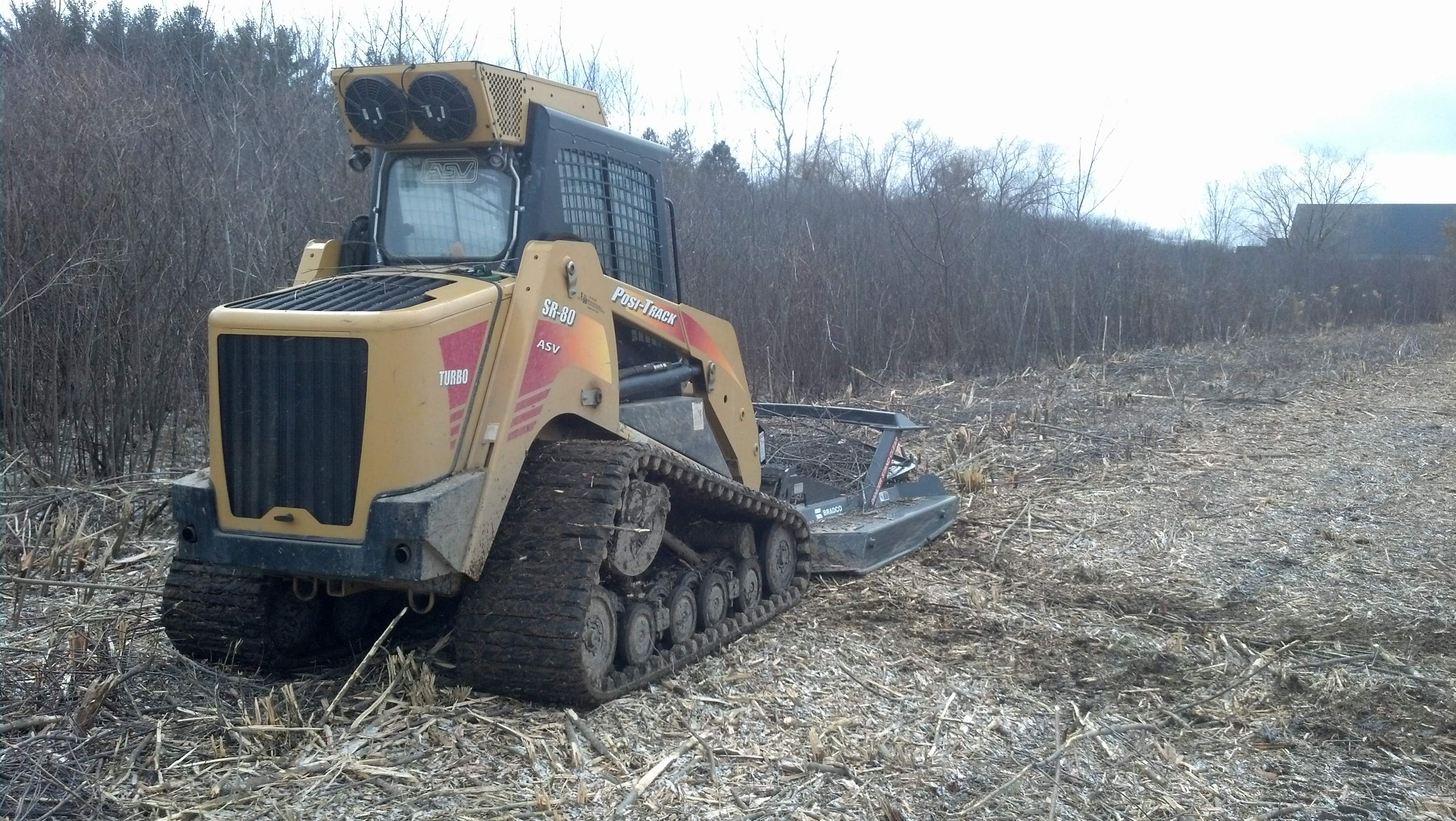

What sold me on the Ground Shark was the stump grinder teeth inserts across the bottom of the disc. You don't need to curl out the mower and drag the knives to help pick up material. The stump teeth just graze the ground and throw material around and help to mulch loose material. They are also more affective at processing rotten logs laying on the ground than by beating them with the knives. As long as I don't hit any push mowers, bed frames or boulders hiding in wait, I can get 3 days out of the knives before I touch them up with a 7 inch grinder. Like I said in one of my other posts, this mower is heavy. At 2000 pounds, you need a decent sized machine to run it. The hydraulic motor is rated at 30 to 45 gallons a minute. My ASV puts out 30 gallons a minute, and that's just enough to run it. If I get too greedy tracking back and forth too hard, you can hear the machine lug pretty good.

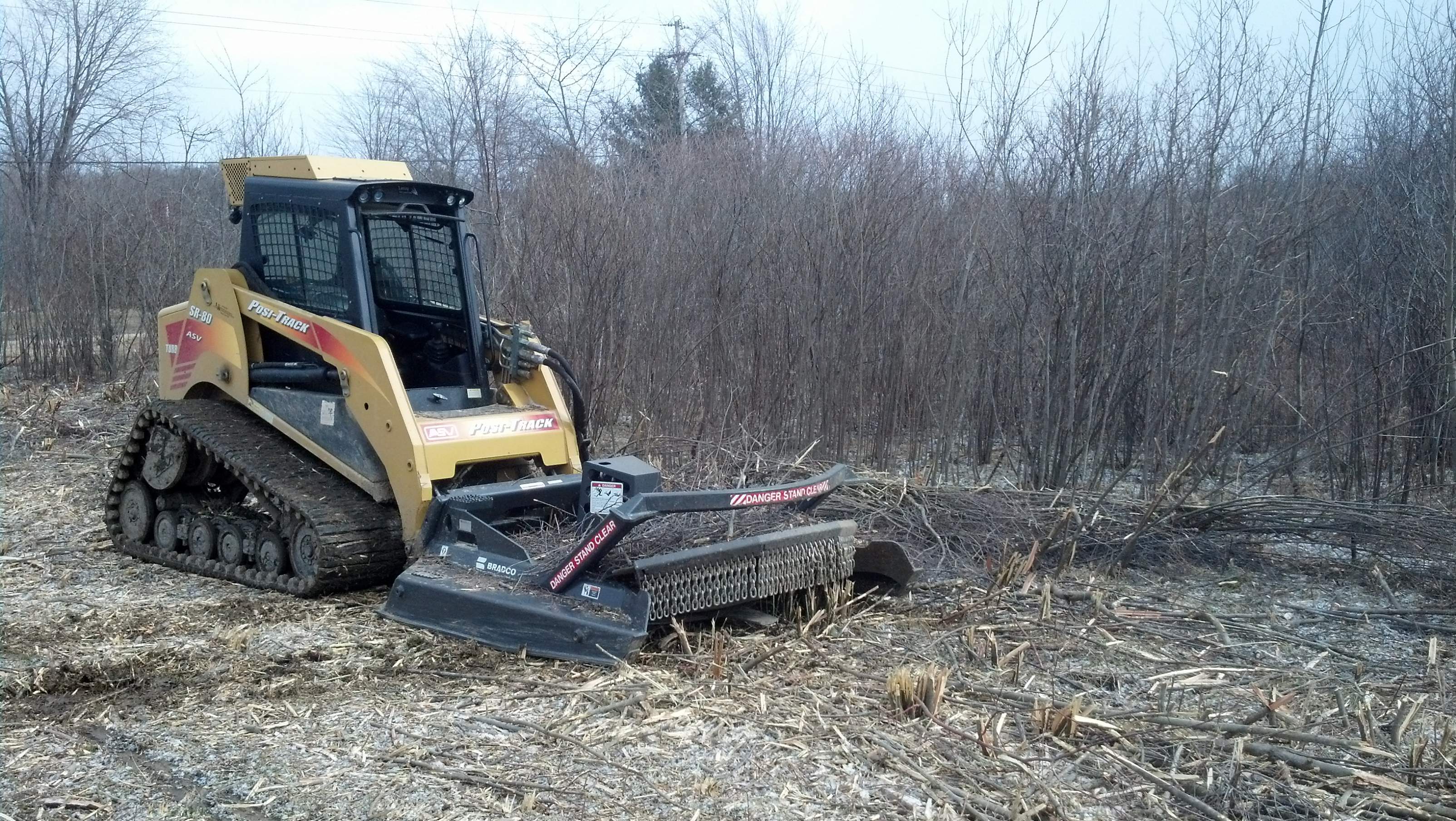

I had an "issue," or perhaps "conflict" is the better word, with the safety chain that fouled the blades pretty well. I took care of that issue.
The knives are nearly as sharp as chipper knives, roughly. The mowing in the video didn't appreciably wear the blades.
Any more detail on the safety chain blade "conflict" that resulted in premature blade dulling that others may learn from to avoid in the future, that you are willing to share.
Being totally self centered about this, as I am looking at the Bradco and want to avoid the same "issue" if I do get it.
/ bradco ground shark #36
As and end user I can say I have absolutely no need or desire for the height limiting chain on the back of the mower.
My course of action was to take the torch and remove it. I can report the operation was a complete success, it hasn't fouled the blades any more!
