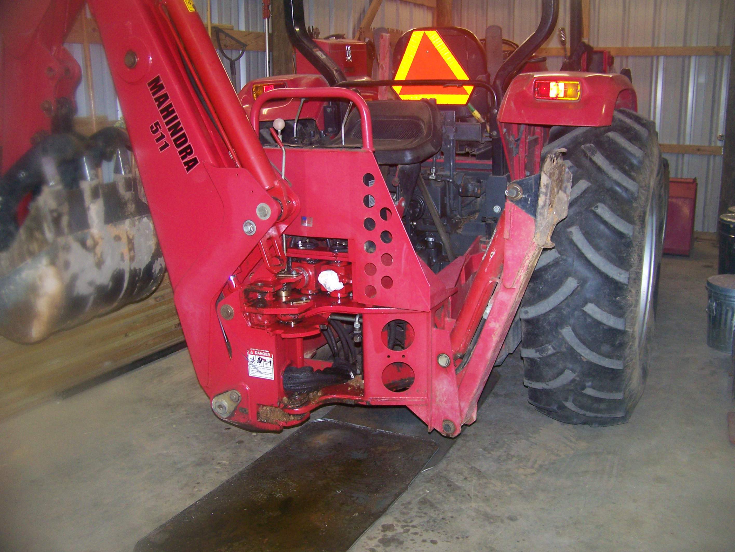

My 2007 511 BH has a leaking swing cylinder. Anyone have any experience with removing one? Or can it be rebuilt while installed on the backhoe?

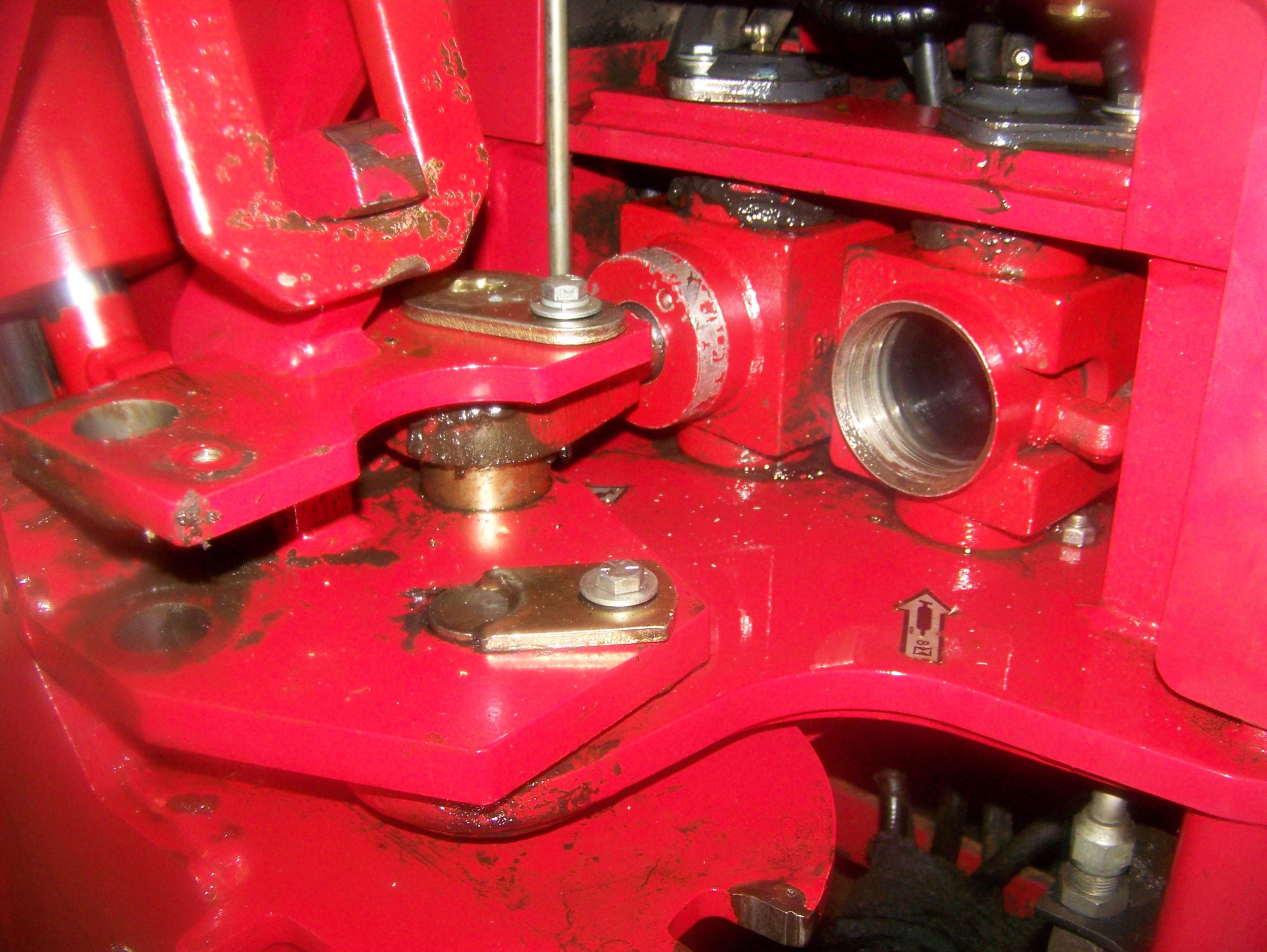

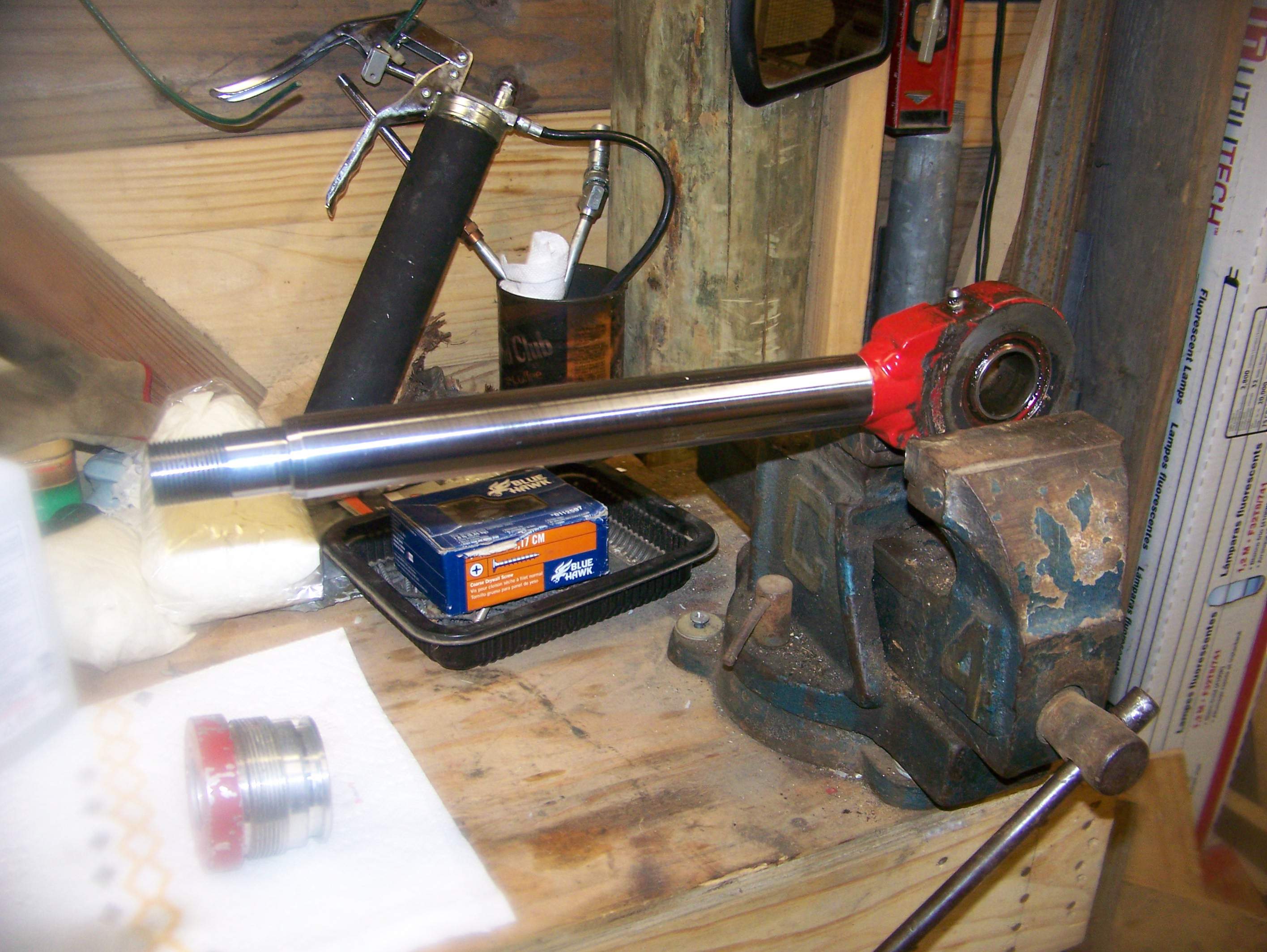

Well, I never continued this thread. I bought a swing cylinder rebuild kit and rebuilt the left cylinder. Fast Forward to September, 2015. My right swing cylinder started seeping. Instead of buying a kit, I took the seals and orings to my local hydraulic shop and bought replacements. Mahindra/Bradco kit was $80 something dollars. Hyd. shop price was $24. A big difference. This time I took photos, but forgot to take photos of the assembled rod before installing it. Total time was about 2.5 hours. 9-5-15 Steering Cylinder Rod.jpg9-5-15 Steering Cylinder Rebuild.jpg9-5-15 Steering Cylinder Rebuild Finished.jpg9-5-15 Steering Cylinder Guts.jpg9-5-15 Steering Cylinder Bore Open.jpg
My gland nut wrench is hard to use, as your really need 3 hands.9-5-15 Gland Nut Wrench.jpg So after I break the nut loose, I use large channel lock pliers to turn the nut on and off. Thus the roughed up paint.

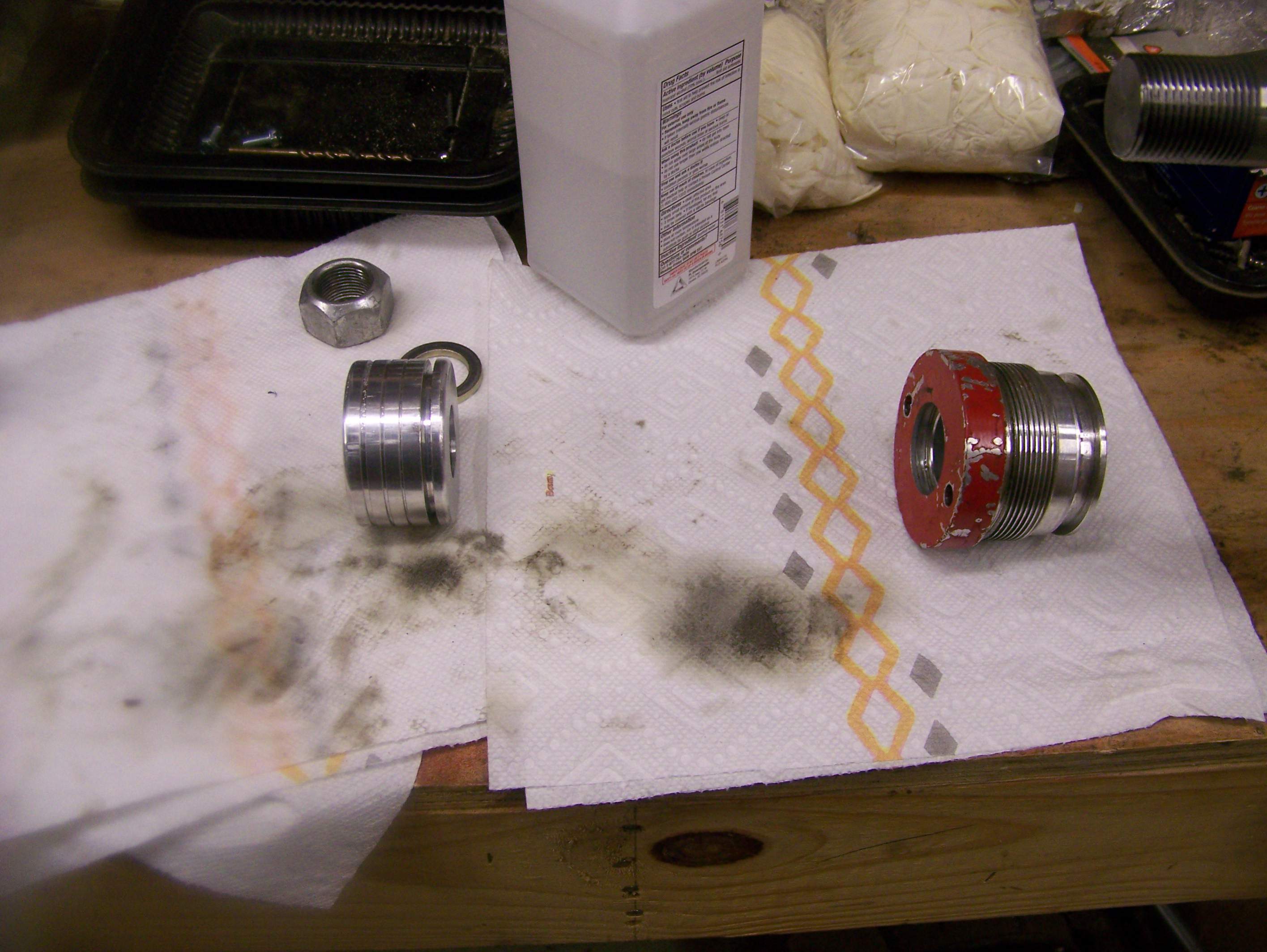

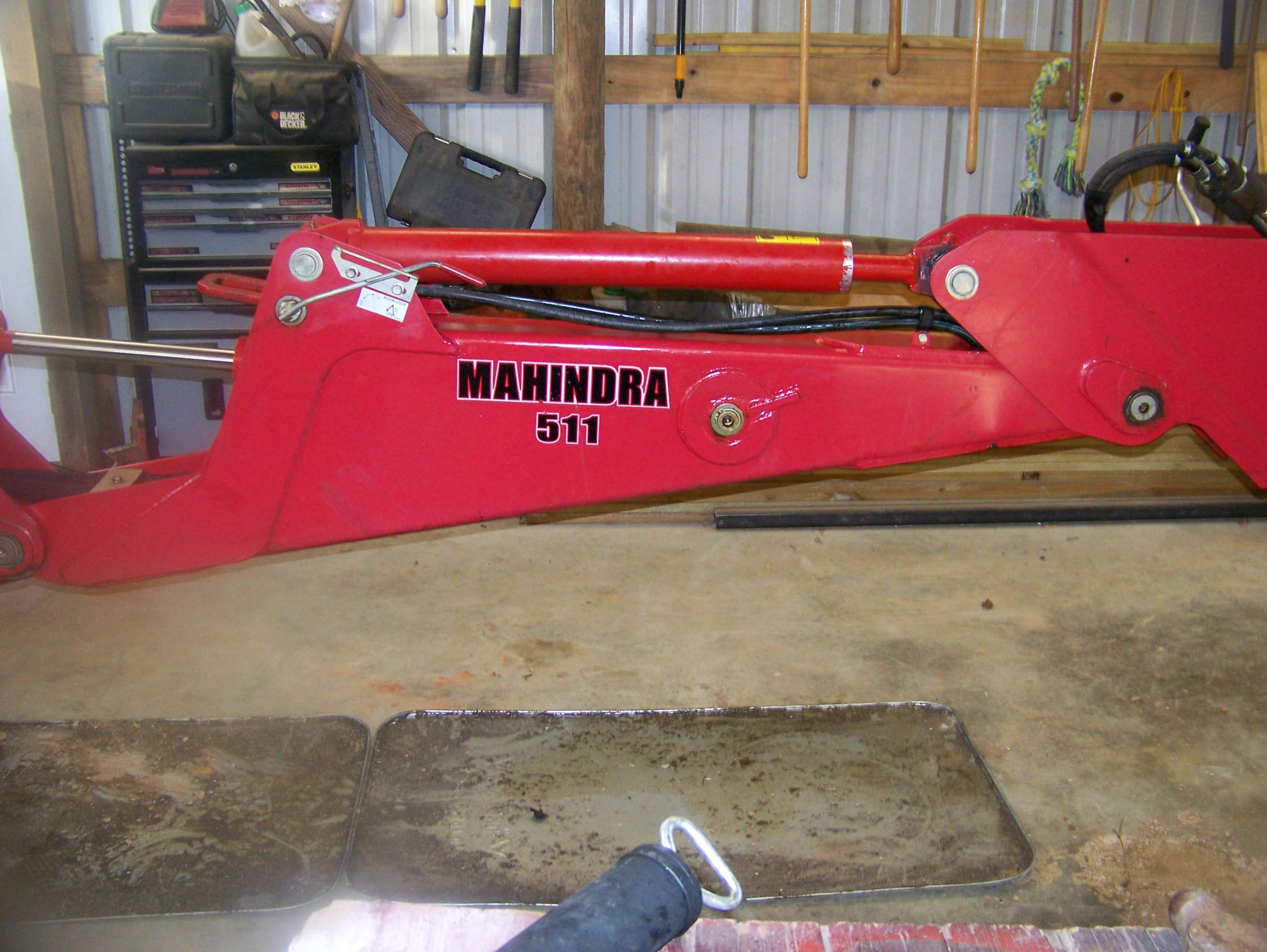

A few weeks before rebuilding the swing cylinder, I rebuilt the dipper stick cylinder. It was a lot easier to rebuild, as the larger bore made it easier to install the new poly pak seals inside the gland nut. I messed up the poly pak seal on the swing cylinder and almost got it in, when the inner o ring popped out. I took the gland nut to the hyd. shop and the owner straightened up what I messed up. Anyway, I forgot to take a few rebuild photos of the dipper stick cylinder rebuild also..........8-22-15 Old Dipper Stick Cylinder Orings & Seals.jpg8-22-15 Dipper Stick Gland Nut.jpg8-22-15 Dipper Stick Cylinder After Rebuild.jpg8-22-15 Bad Dipper Stick Cylinder Wiper Seal.jpg
These seals and o rings cost $36. I also needed help installing the rebuild rod and gland nut assembly into the bore.
