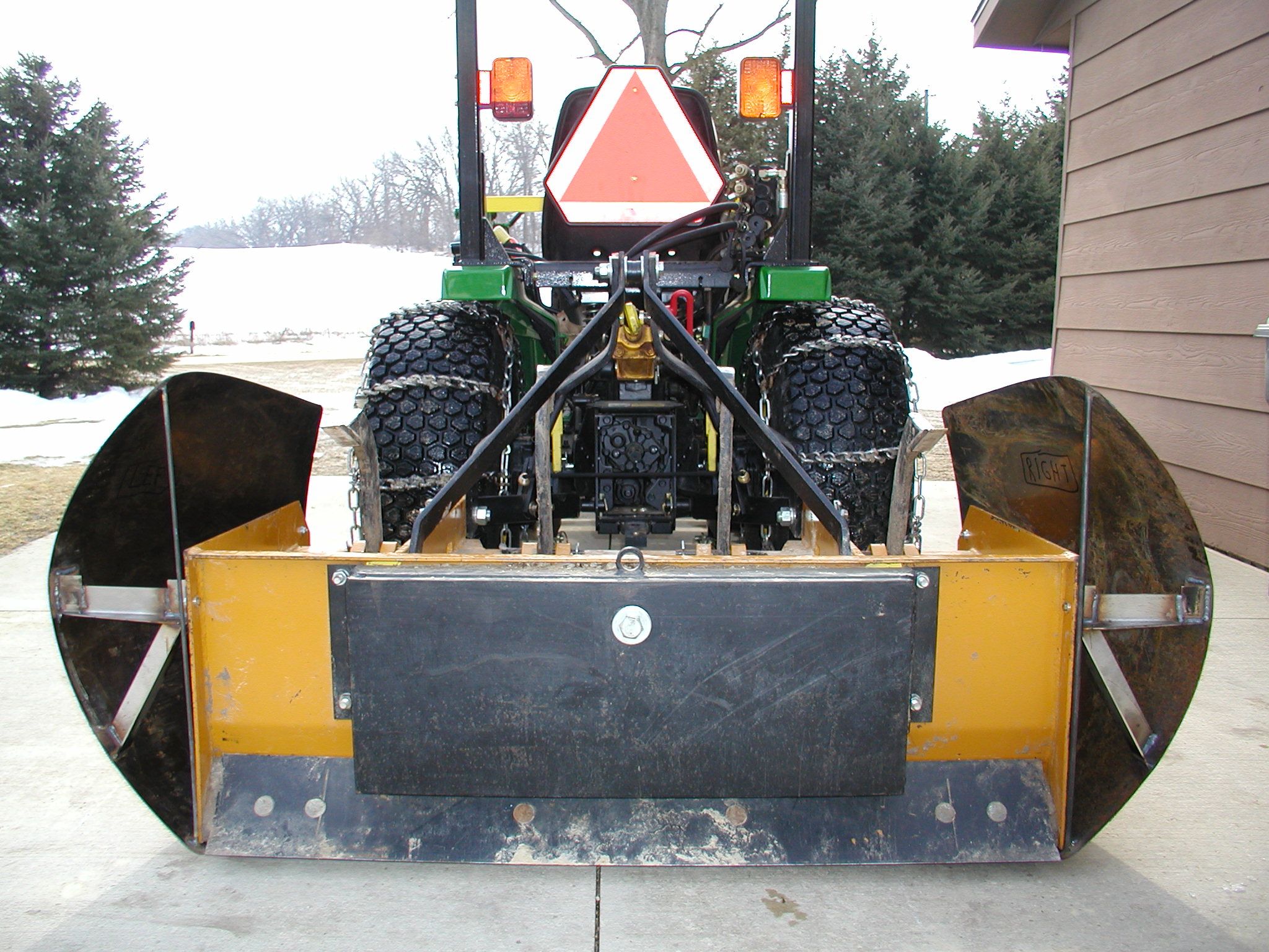

Glenn, you have gotten quite good response to your "survey". I will add:
I bought an inexpensive boxblade as soon as I got my tractor. I then added 300 pounds to the back wall of it with a slab of steel from the scrapyard. Now, at about 625 pounds it makes a very efficient counterweight. Also, the extra weight helps the penetrating action into the soil when scraping. I used the BB to landscape a nice flat area for a new pole building a few years ago. I dug into the ground about 2 feet at the back and filled a foot at the front. I started very early in the Spring and actually scarifier-ripped thru about 4 inches of remaining frost. My soil is about 6 inches black, then clay and rock, and the BB worked great. There were four trees, about 8 inches trunck diameter, in the way of the construction, and I used the scarfiers to dig around the roots. If I came to a root that was too big (stopping the tractor motion), with the scarifier tooth hooked under it I extended the toplink cylinder as far as it would go. This pryed the root till it snapped. Roots as big as 3.5 inches diameter were snapped off with this method. then I pushed the tree over with the loader and rolled the root ball around to get the dirt off. In winter, the BB works great to counterweight the front snowblower, and will also work to nicely sheer off the ice ridges that sometimes form on the cement slab in front of the garage. If leveling loose material, backing up with the BB lowered almost to ground level will make it perfect in one pass usually. I used to till the garden with the scarfiers, but now have a little field digger for that job.
I built a couple of stainless "wings" that bolt to the sides of the BB, I use that contraption when we get very deep snow, to form half-pipes for sledding and snowboarding. With the loader bucket full of snow and carried one foot off the ground (leaving one foot of snow), and the boxblade lowered to about six inches off the ground and of course it fills right up, the pipe is formed as I drive along. Overnight it freezes and the next day the pipe is useable. Here's a pic:

Now that is cool!! Of course we only get that kind of snow once a decade, but that is awesome. Very creative.
