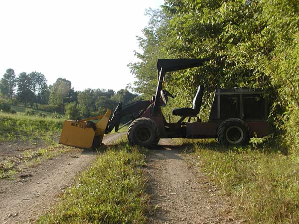

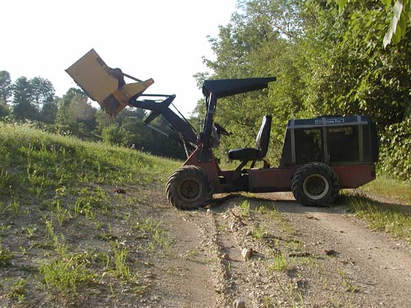

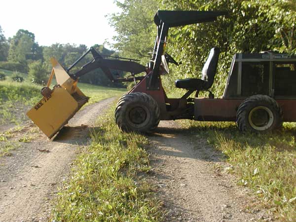

I took a few pictures of the PT box scraper. Here is the thought on this. PT connects the quick attach plate (QA)to the back of the box scraper. Clint Blake and my thoughts are to connect the QA to the front of the scraper and then add some reinforcement connecting the bottom of the box scraper to the top of the quick attach plate. Why you ask? A box scraper, as we understand it, does its job because the distance from the front wheels of the PT and the box scraper is less than the wheel to wheel distance. This way when you go over uneven ground the box scraper moves up and down less than the wheels. So each time you make a pass the ground becomes a little more even. By moving the front of the box scraper back about 16 inches you shorten the front wheel to box scraper blade distance, hopefully enhancing this situation. So hopefully you don't have to make as many passes.
Also since most of the forces are on the front of the box scraper, by making the front connnect to the QA plate you may save a little on the metal in the box scraper. Does anyone have any comments on this? Speak now before I build the thing. I have attached a picture of the PT box scraper for reference.

If you look you at the previous picture you may see that the scraper blade is actually angle iron with the point facing up. I have attached a picture of the angle iron that I will be using. It is about 3 inches wide. I have cut four pieces to four inches long and these will be used as extensions and as weld reinforcement pieces to attach the extensions to the 44 inch pieces for a total length of 48 inches. The same as the PT scraper. I will also use a piece of angle iron for the top of the front blade assembly with 5/16 inch plate between the blade and the top piece. The bottom of the QA plate will then be welded to the top angle iron. The QA plate will be tilted forward to about 60 degress (just like the PT version). Another piece of angle iron will be welded from the scraper angle iron to the front top of the QA plate. Other reinforcements will be added as I figure it out. I am sure this will be clearer when I build it. See attached picture of the angle iron.
