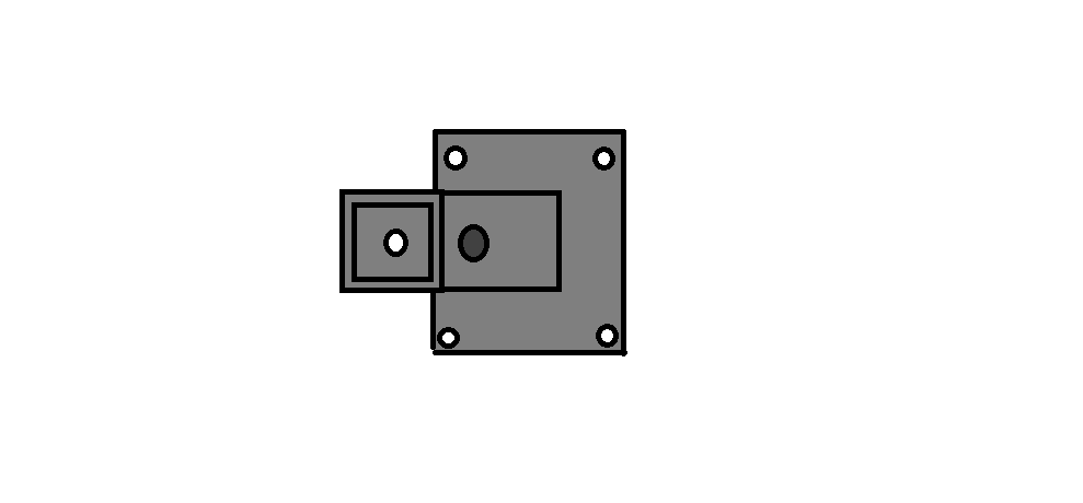

well, if you use a pintle hitch, just take some box tubing, cut to length of end of hitch, and weld it to a plate of steel. Drill 4 holes in both the corners of the steel and in the area that you will put it on the boxblade. Then you can easily remove it when needed and simply bolt it on for use. Like my gauge wheels on my grading blade. :thumbsup:

   / Box scraper add on #6
Like this RT. :thumbsup: But paint to match. :thumbsup:
yeah BUT that extends the end of the fulcrum point farther back from the box and even 2 inches could be bad...
I think bolting it directly to the box blade would be good enough....
J

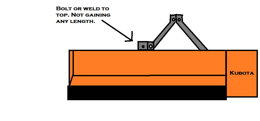

   / Box scraper add on #8
what about this?
   / Box scraper add on #10
I don't want to weld anything to it...
if I can help it...
I have a cheap box and that metal just did not take well to welding..
J
what if you just drill two holes and bolt it on? and maybe for added strength, cut two triangles and weld them under that lip for better strength.
