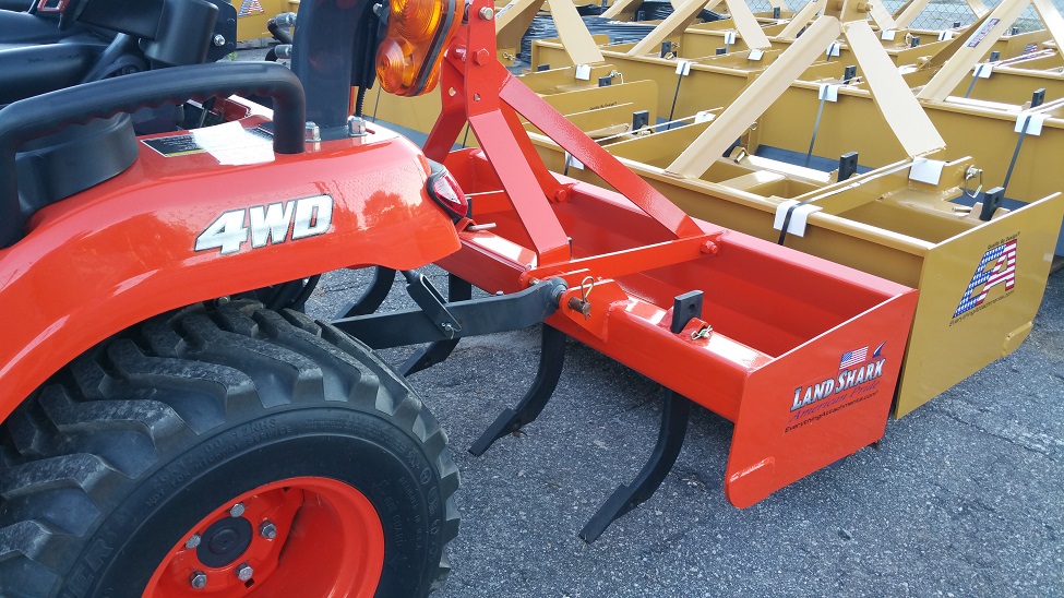

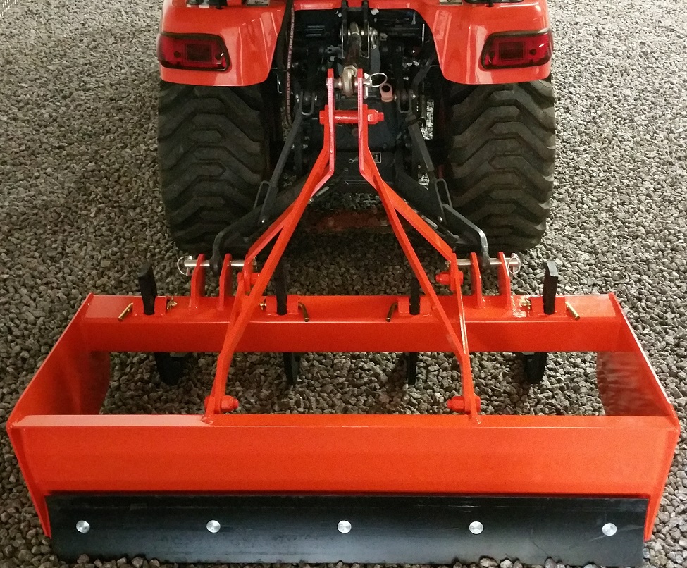

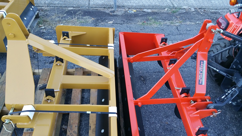

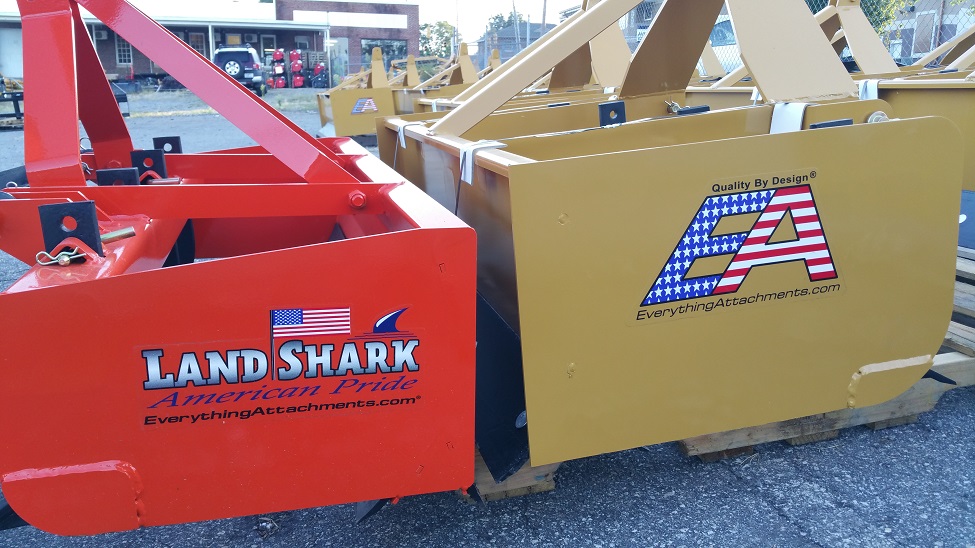

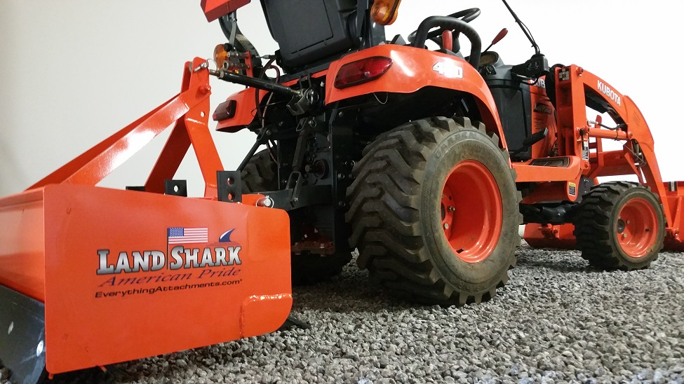

The best match for a subcompact is a box blade made for a subcompact. The geometry is correct, so the tractor will be working the box blade, not the other way around.
We make our Land Shark Subcompact box blade in 48" and 54" widths. Either would be great on your tractor.
