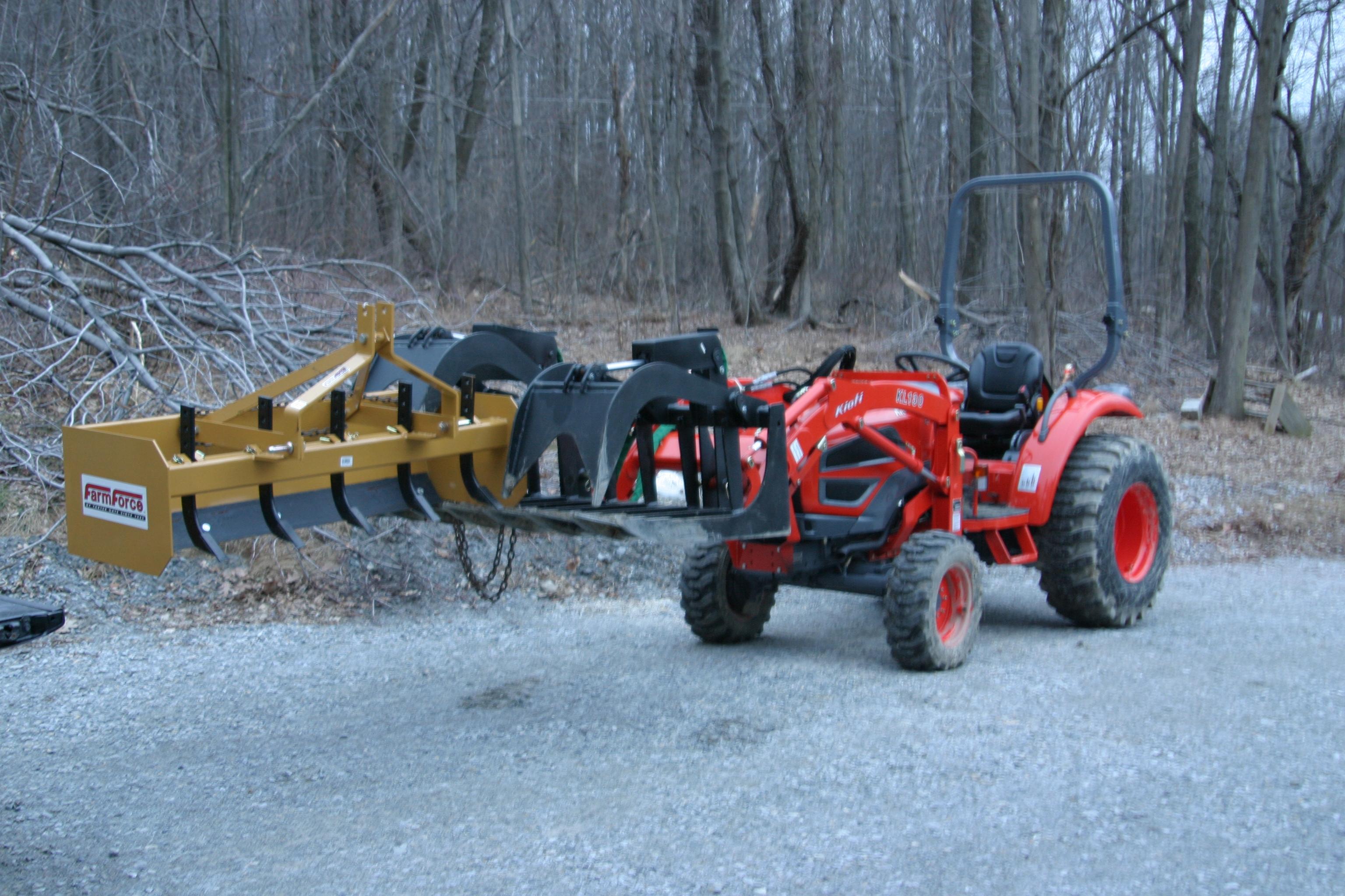

My box blade started working 100% better after I added a few hundred pounds extra weight to it. I used barbell plates from the sporting goods store since they were easy to bolt on and cheaper than anything at the tractor dealer.
