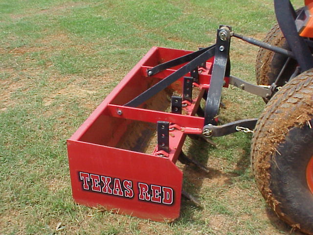

I agree, I got this one for $350 out the door at the local COOP. 5' and works fine for me.
