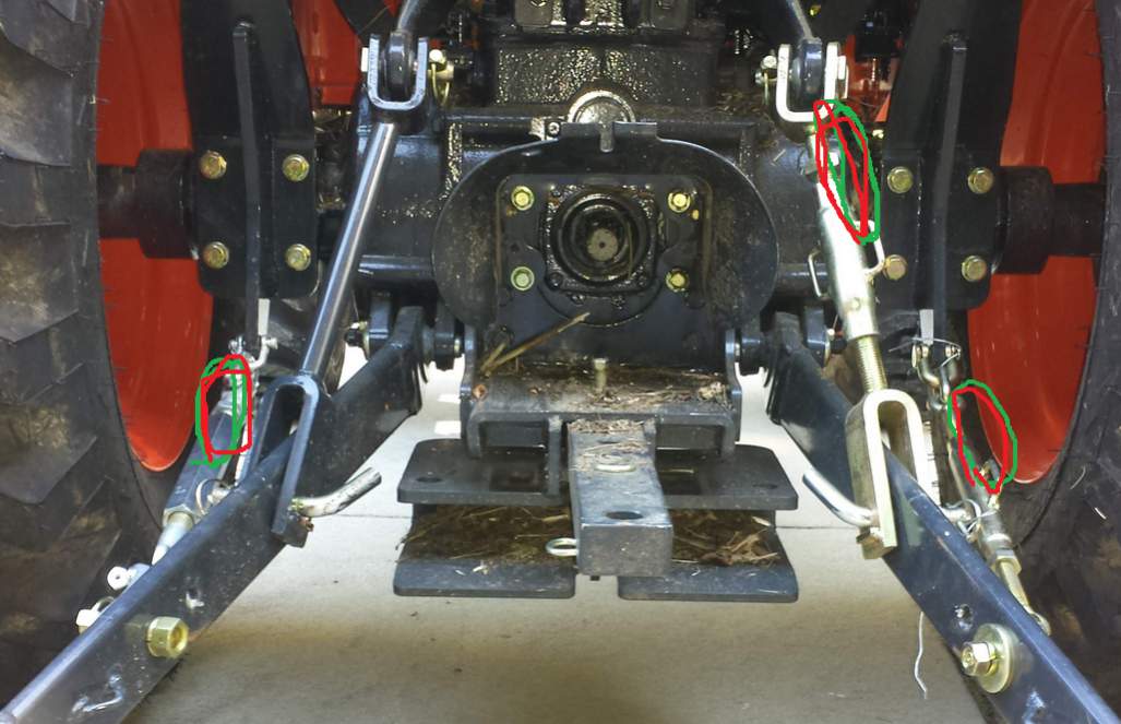

I noticed some wire to safety some pins etc.
Good suggestion as I once lost a turnbuckle barrel on a sway chain on my tractor.
Dang thin simply loosened and fell off. Guess vibration is to blame.
Lesson learned so every t-buckle now sports some safety wire.
/ Box blade will not completely lower #42

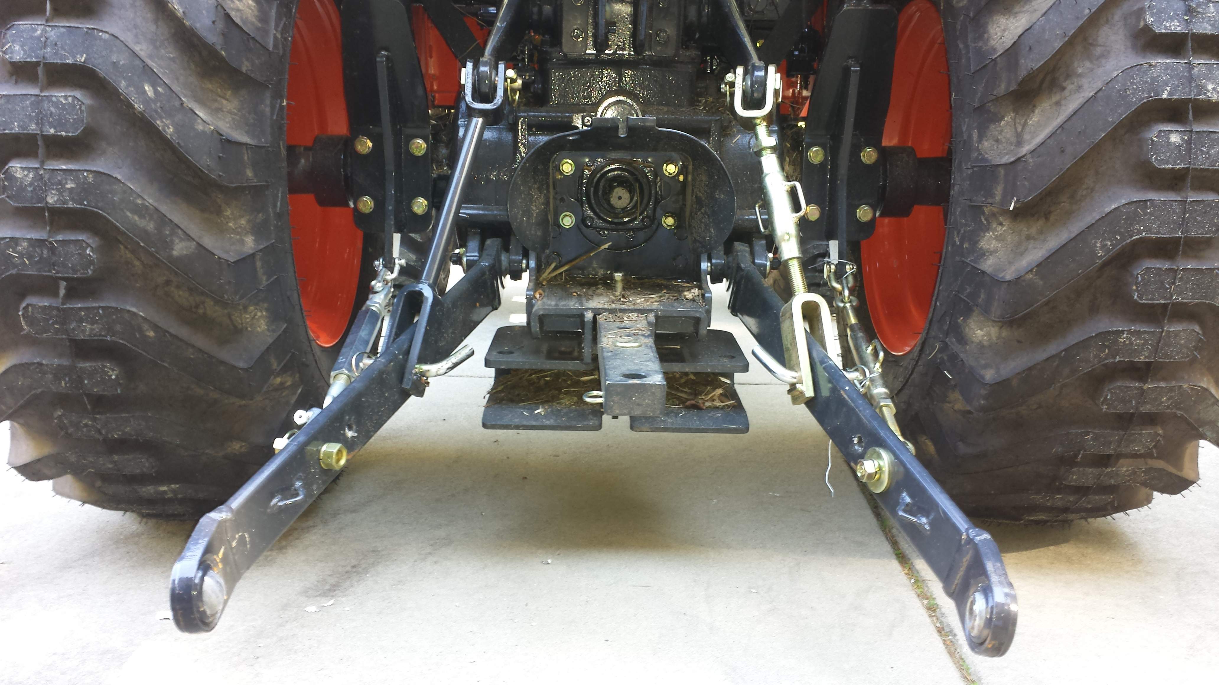

Stumbled on to this thread by looking for replacement sway links for my new Kioti 3510. Mine were loose and ended up falling off during first few hours. Whoever noticed wrong sway link and lift rod bar placement - GOOD JOB. Turns out my tractor came with it backwards as well, it worked fine for Bush Hog but with sway links lost it is moving side to side way too much. Manual does show turn buckle attached in the further hole than the lift rod. I will swap holes and order new links, hopefully it will make things better. Anybody knows good place to order replacement sets of sway links?
