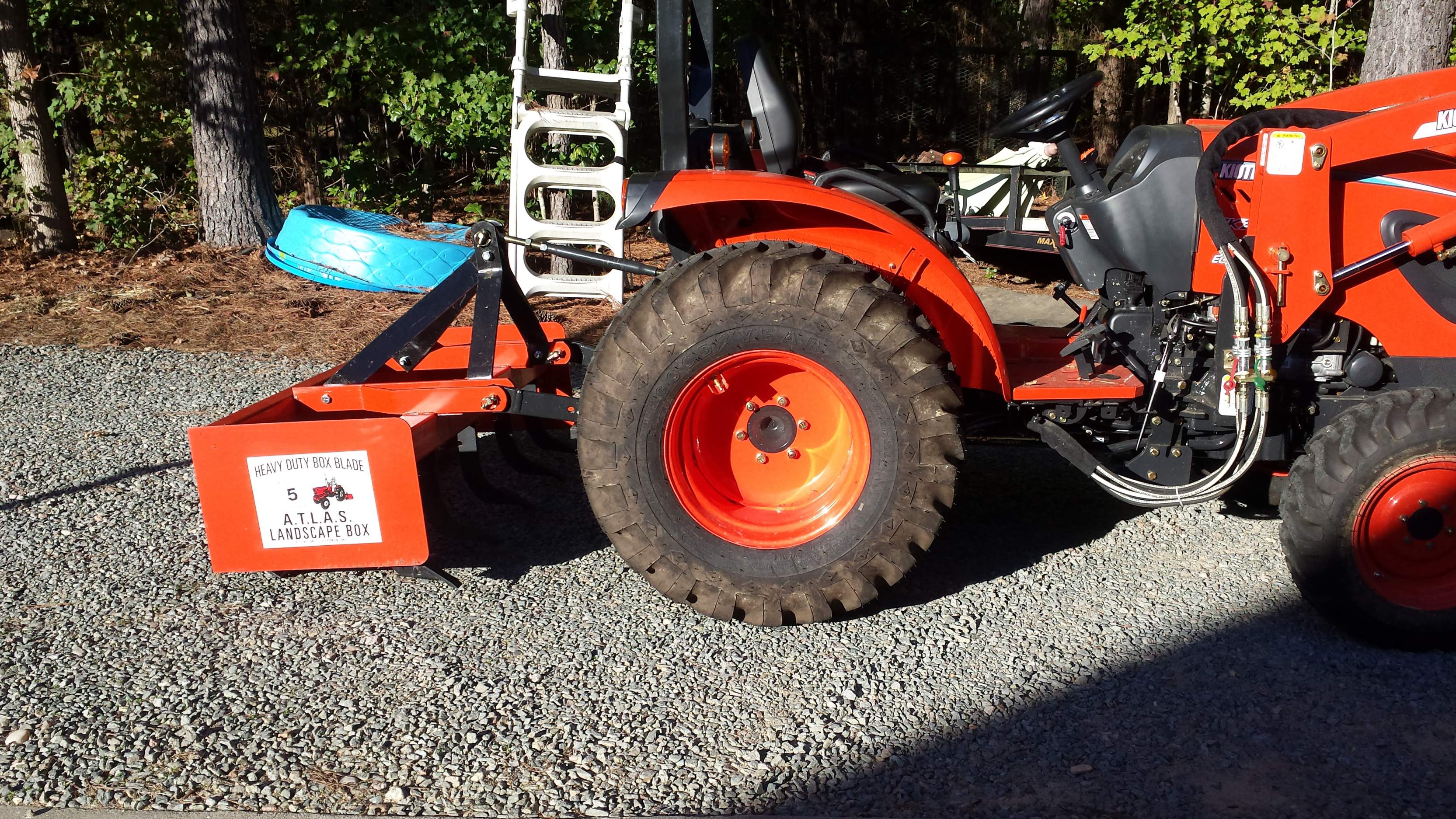

Box blade will not completely lower

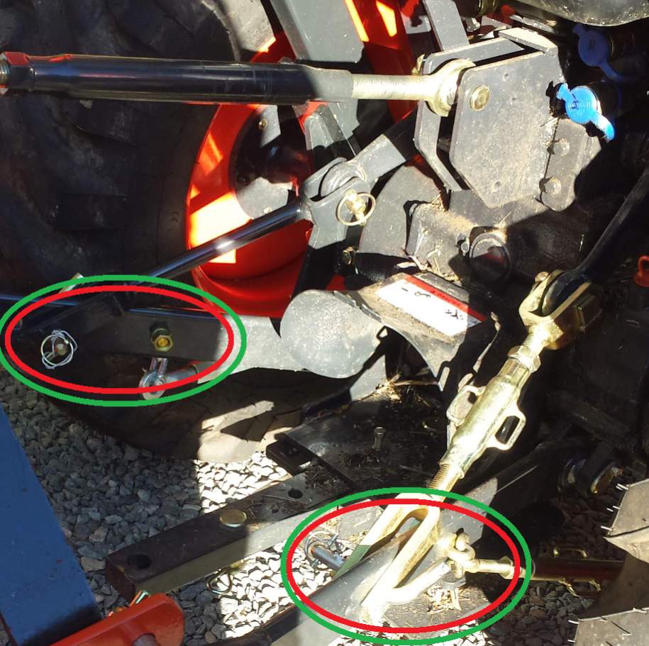

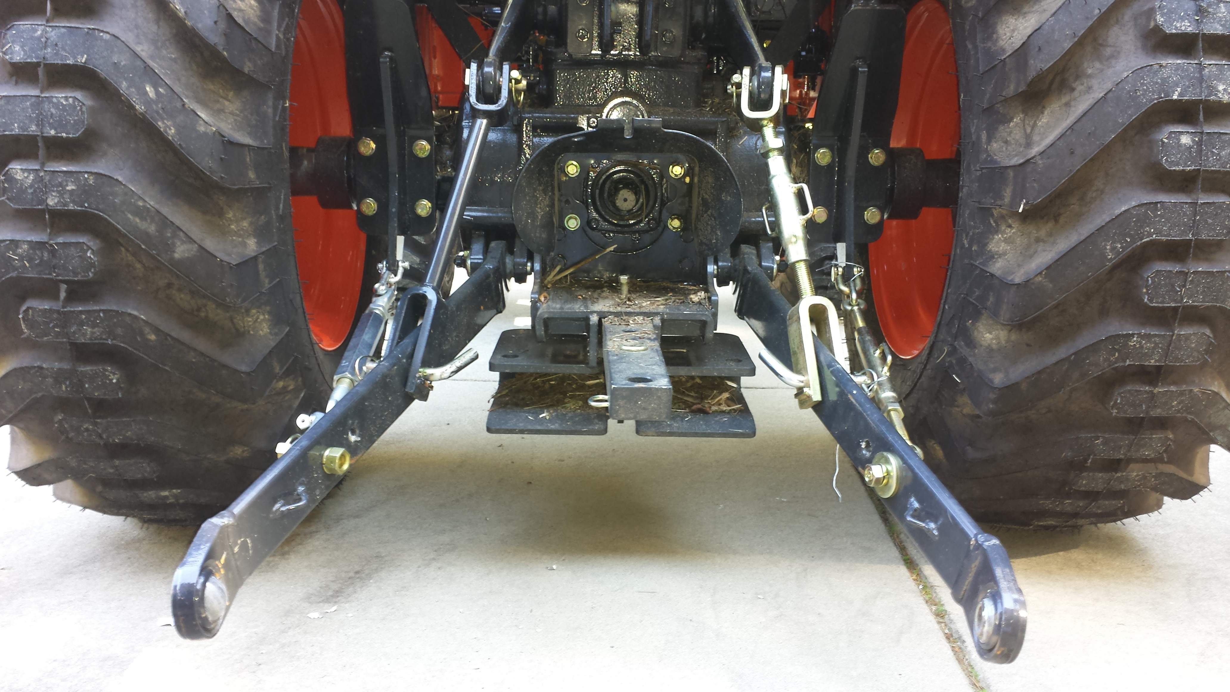

This is what yours should look like. Also shorten the top link so that the front cutting edge is just about 1/2" lower than the rear cutting edge for your work tomorrow.;)
Nice one Brian!:thumbsup: Did you get yourself a Kioti? Here's hoping....:)
Good description for the OP.
To the OP, hopefully your dealer's techs have better skills than whoever set up your 3PT hitch assembly.
If it were my tractor, I'd go over it with a fine tooth comb, to make sure everything is as it's supposed to be.

No new tractor, just one of many pics that I have from my tractor research.

you have 4 connections backwards (2 on each side)
just swap your connection points and all should be good.
the bars / turnbuckles are all good. just you have them connected in the wrong holes in the lower lift arms.
swaping them around should also tighen up the "sway bar/chain" on each side as well.

Swapping the connections as you mentioned is right. I still think the left lift arm is on backwards though. Mine has the left lift arm mounted with those three holes in a row, third picture, inwards to the tractor case pivot mounting. This allows me to mount the non-adjustable side like in more than one location which allows the lift range to change. Then I use the adjustable right side link to match or adjust as needed.

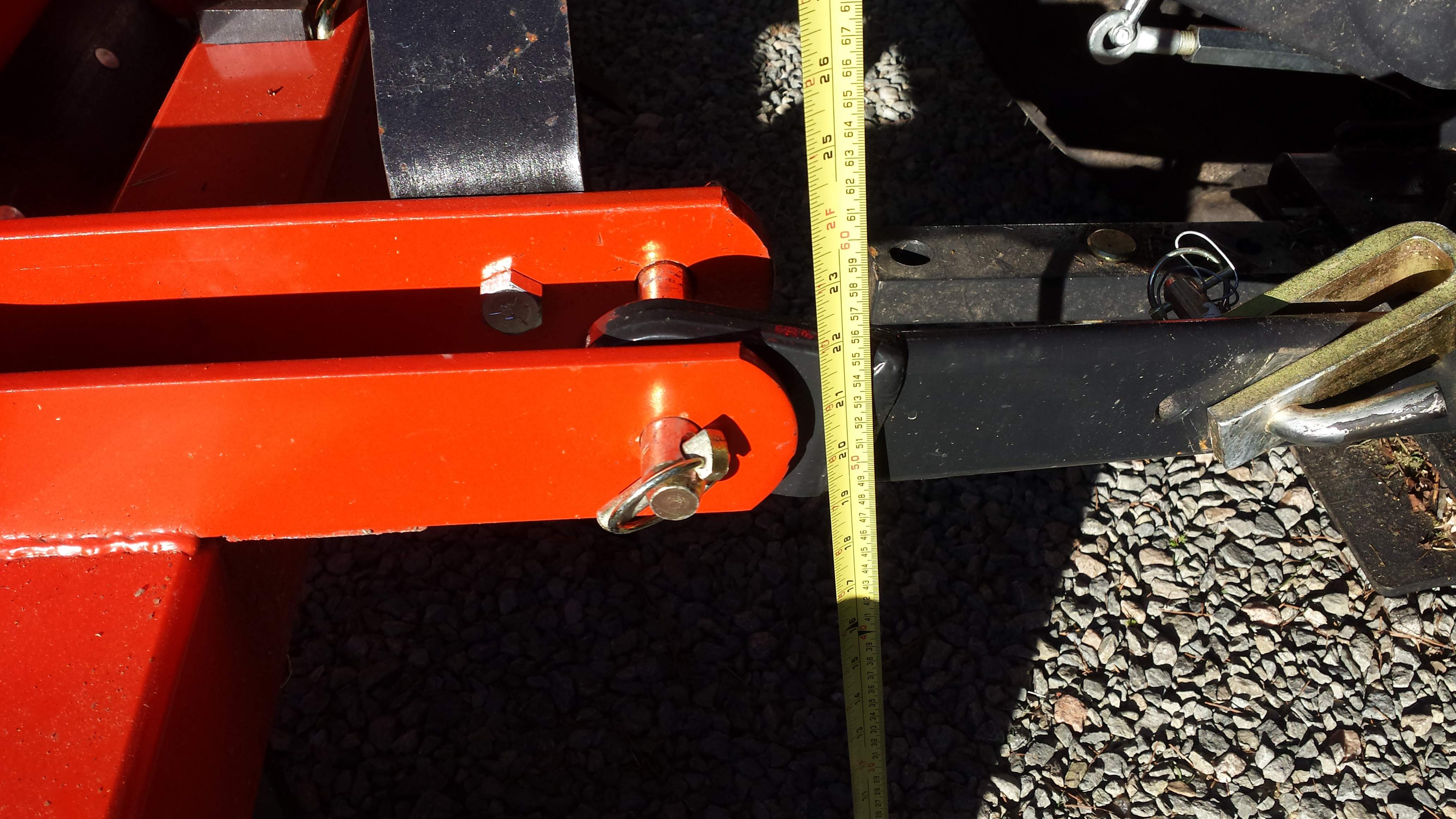

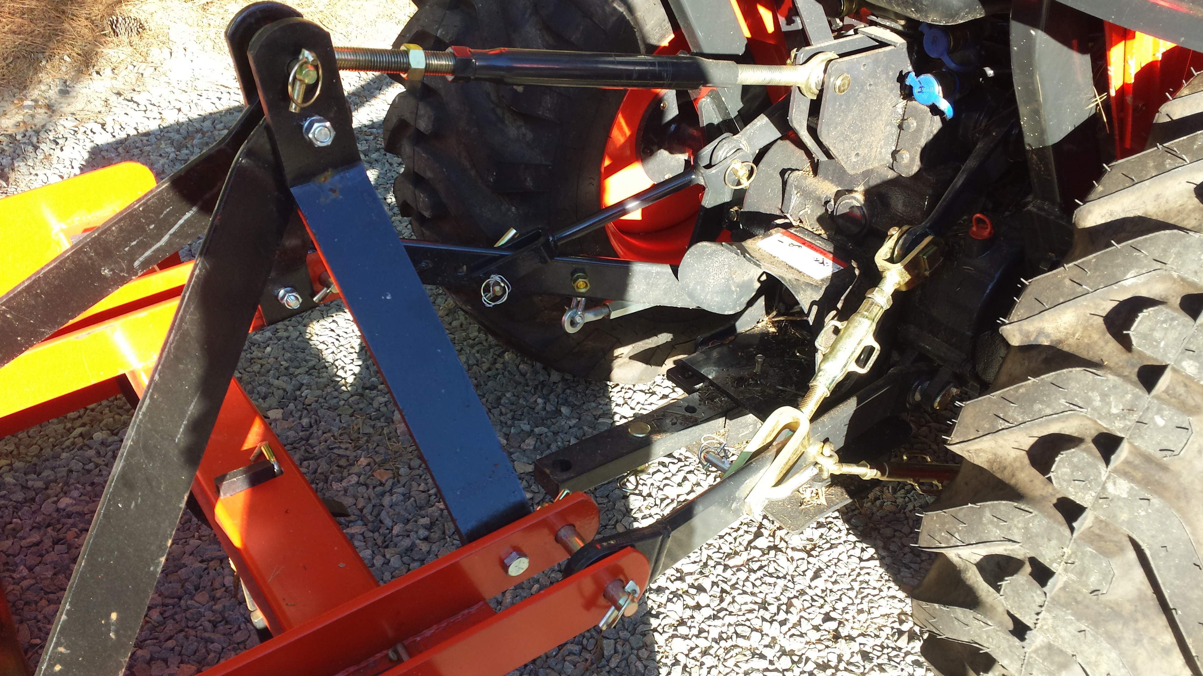

Thanks for all the help. I moved the connections and everything works much better. I can't believe that the 3PH was set up wrong from the dealer. This is one of the few kioti dealers in the state and the only one locally and I know they have a pretty high volume sine the kioti plant is 5 miles away. The left arm looks like its correct. I checked as much as I could thing of that might also be a problem and could not find anything else. If there are any suggestions other thank fluids and grease let me know.
I am have a **** of a time keeping the pins in for all of the connections adding lots of wire to reenforce them.

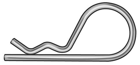

These are the types of cotter pins that were on the tractor
I can easily pull these out and have lost 3 so far and thats how lost the check chain. Seems that going through some of the brush and twigs they just were yanked out. The expandle cotter pins would work well but would be a pain to remove. I have wired about every pin I could find since I keep loosing things.
/ Box blade will not completely lower #30
Those are NOT the correct pins that should come with the tractor, and thus why you lost your chain. They correct pins are (snap type spring loaded) lynch pins: Set of 10 Tractor 3 Point Hitch Linch Pins 7 16" | eBay
And I would get your dealer to give you the correct hardware for the entire 3PH, AND the needed pins, AND a new chain. Their bogus hardware is what caused you to loose your chain!:rolleyes:
It's no wonder you're loosing pieces- have them replace everything with the gold colored hardware- it's treated, unlike the clevis end?,(U-bolt) and bolt on the left side support for the 3PH arm, too.

BTW, great follow-up pic of the corrected 3PH setup!

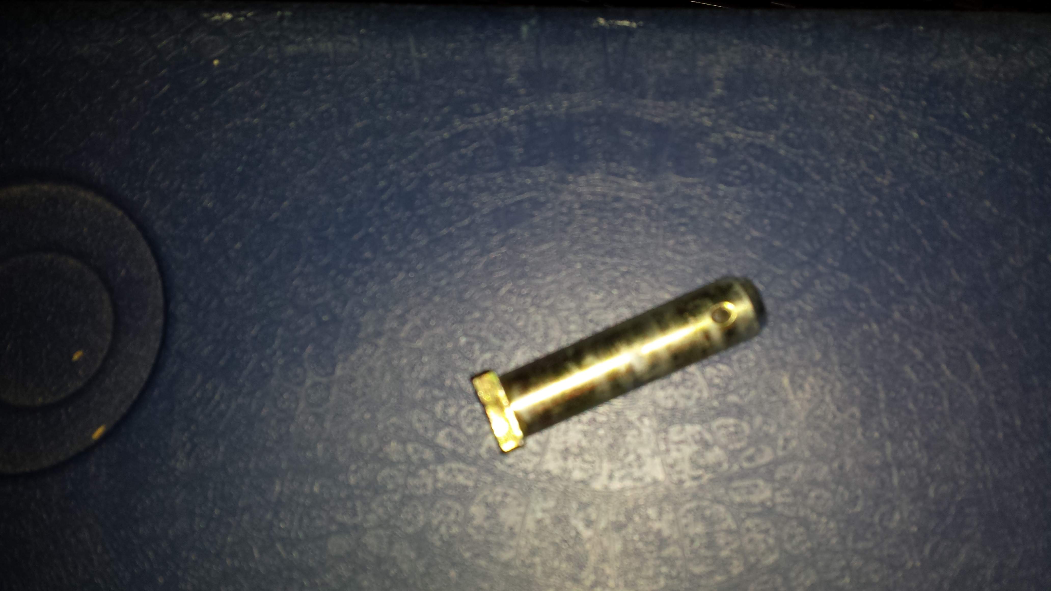

Coyote machine, you asked about the bent pens. That was the first casualty of a missing cotter pen. I think this is what you were talking about
I could not find any of these so I replaced both of them. I have been going over the machine and so far have not found any other items. I did have a backhoe attached so maybe they had a newbie reattach the 3ph. But the cheap cotter pins are what realty throw me. I wonder fanyone else with a new model ck3510 can take a look and see might have been used for theirs.

Yes, those gold color square flat head pins are the correct ones for the place you currently have the bent ones.
