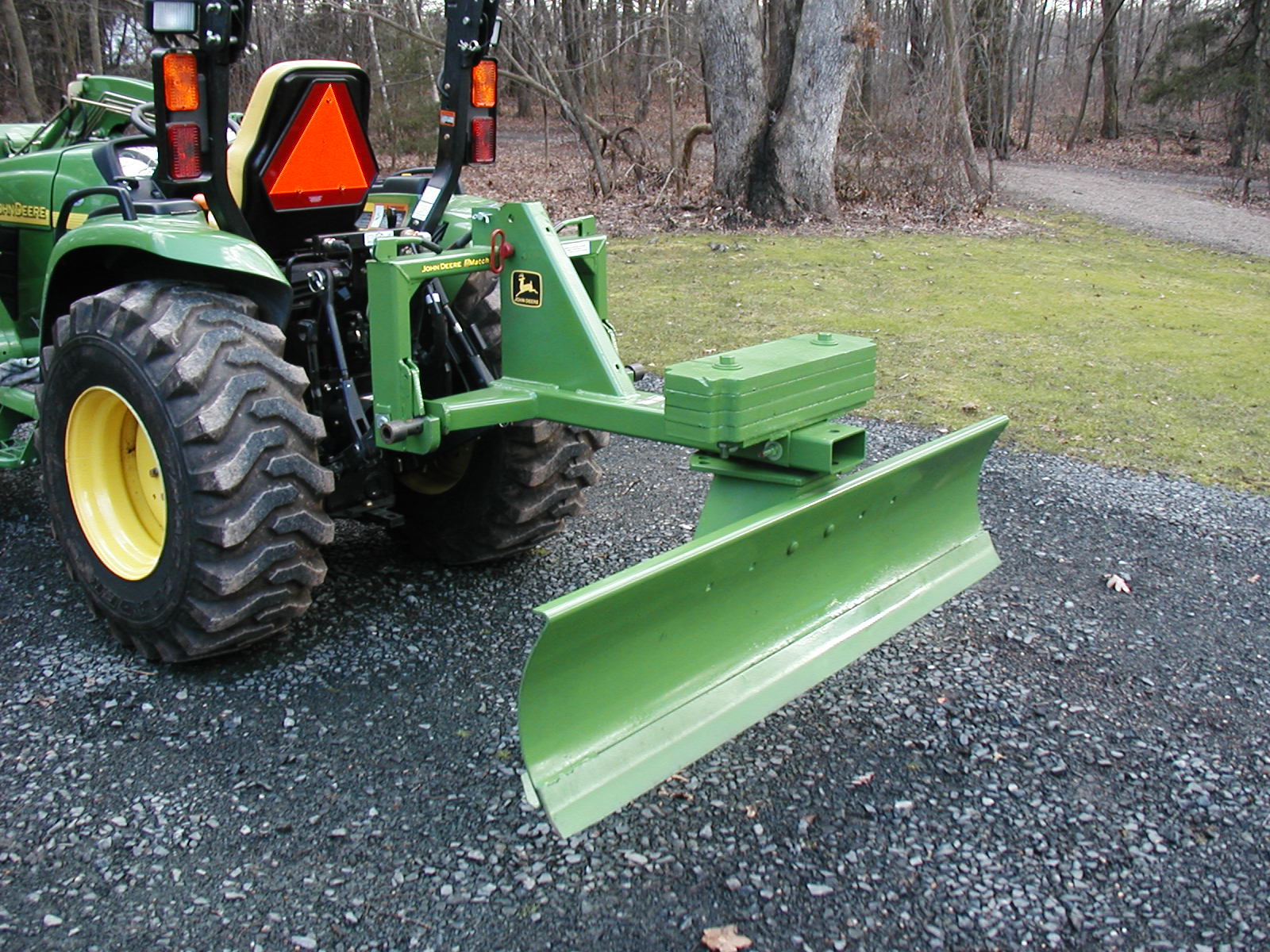

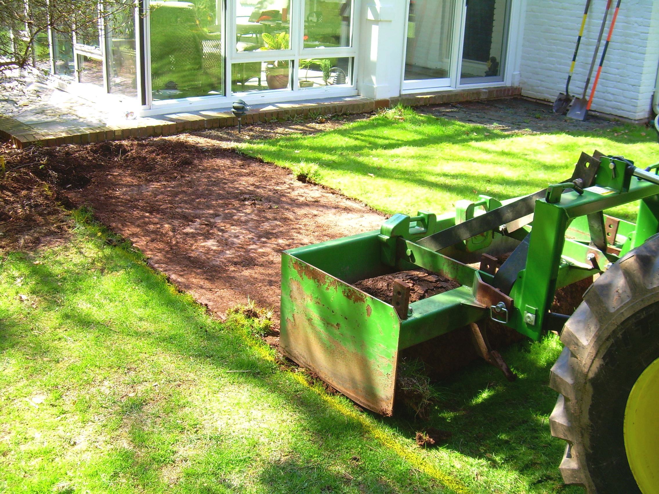

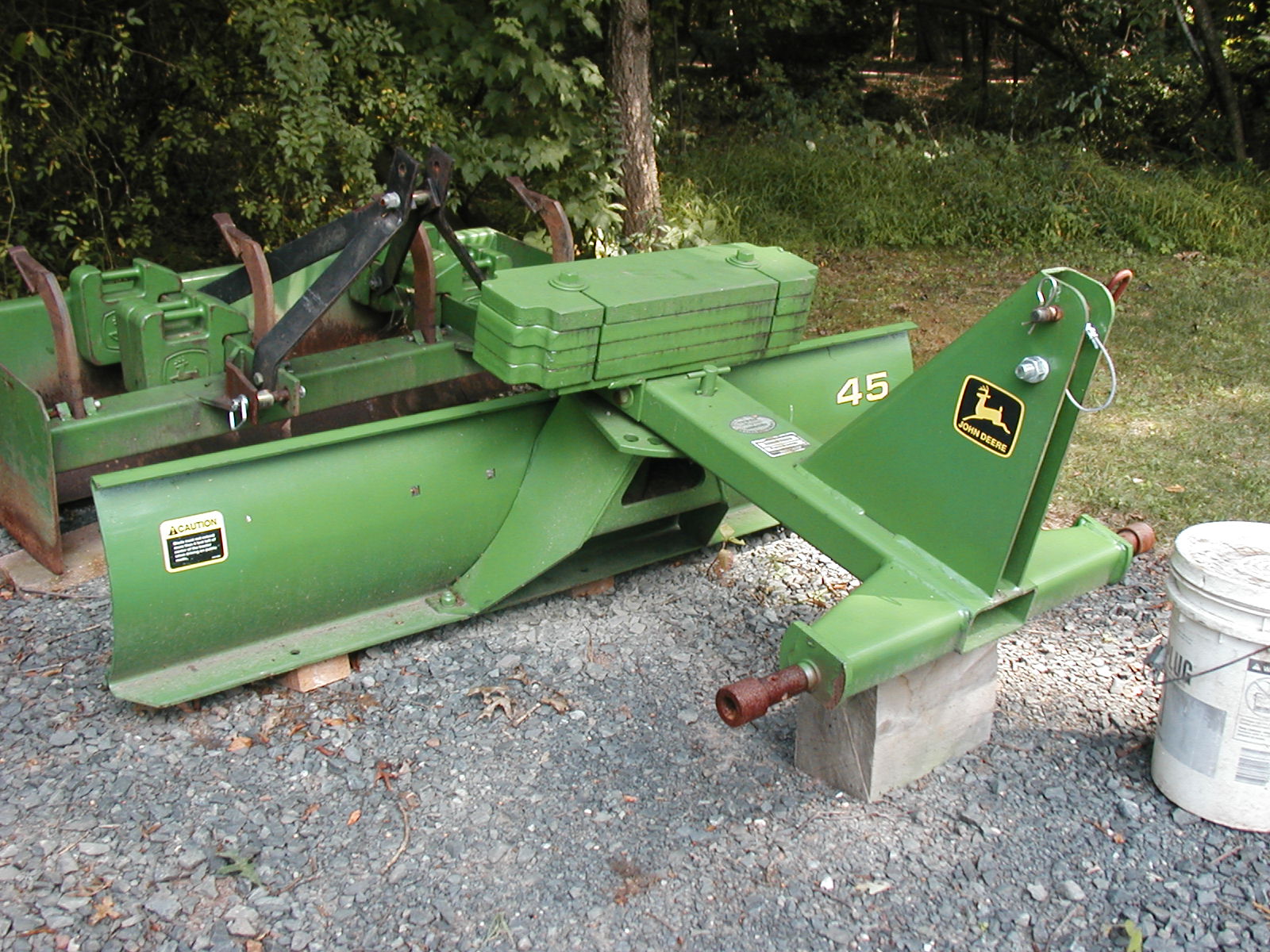

I put weight on my box scrapper and rear blade, a necessity for me with hard ground and packed snow and ice.
What I found more effective than weight on the box is a Hydraulic top link, with the ability to change cutting angle on the fly...
Starting with overly aggressive angle to get it to dig down deep then leveling off when you reach your depth.
Box scrapper and HTL were made for each other.
