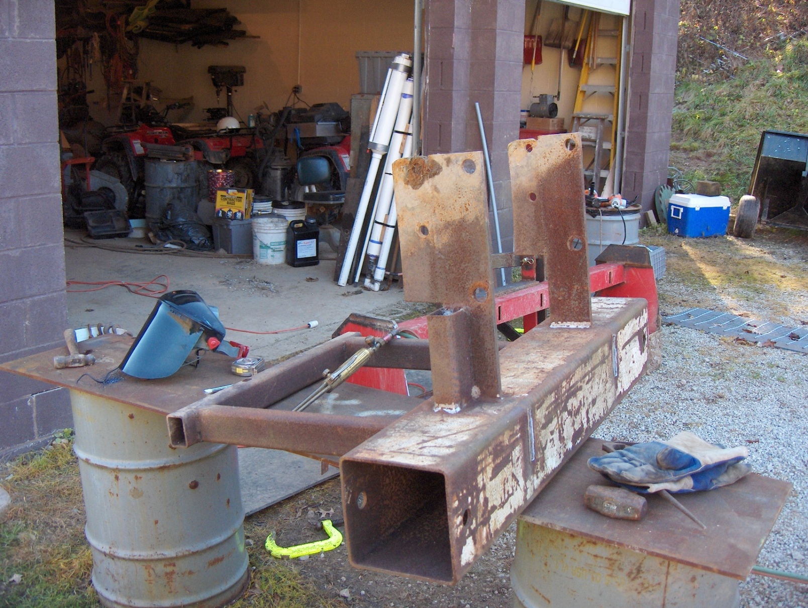

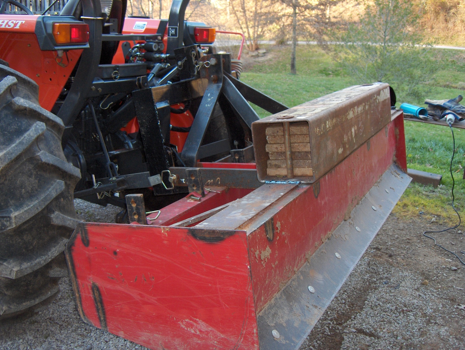

I have a 7 foot BB on my L4400 Hst and I have found that if I am doing any aggressive work it needs weight to heelp it into the ground even with the ripper shanks. Do any of many members add weight to their BB or am I alone here. I added a 8" Box Tube off of my old tractor onto the BB to use as a weight box here are a few pics of yesterdays work. I will have to wait for it to warm to paint though.

Weight is your friend when it comes to box blades. You will find that many many users add weight to their box blades.
How much do you figure your blade weighs and how much weight have you added?
Just wondering. :confused:
/ Box blade weighting, do you add weight? #3
That should help you alot, what do you think the total weight is now? I know my 7' boxblade weighs about 1250 lbs.

I have 6 plates that weigh 84 pounds a piece. I add or take away as needed. the box blade is a no name brand that have beefed up quit a bit and I would say it weighs about 600#. I figure fully loaded its about 1100#.

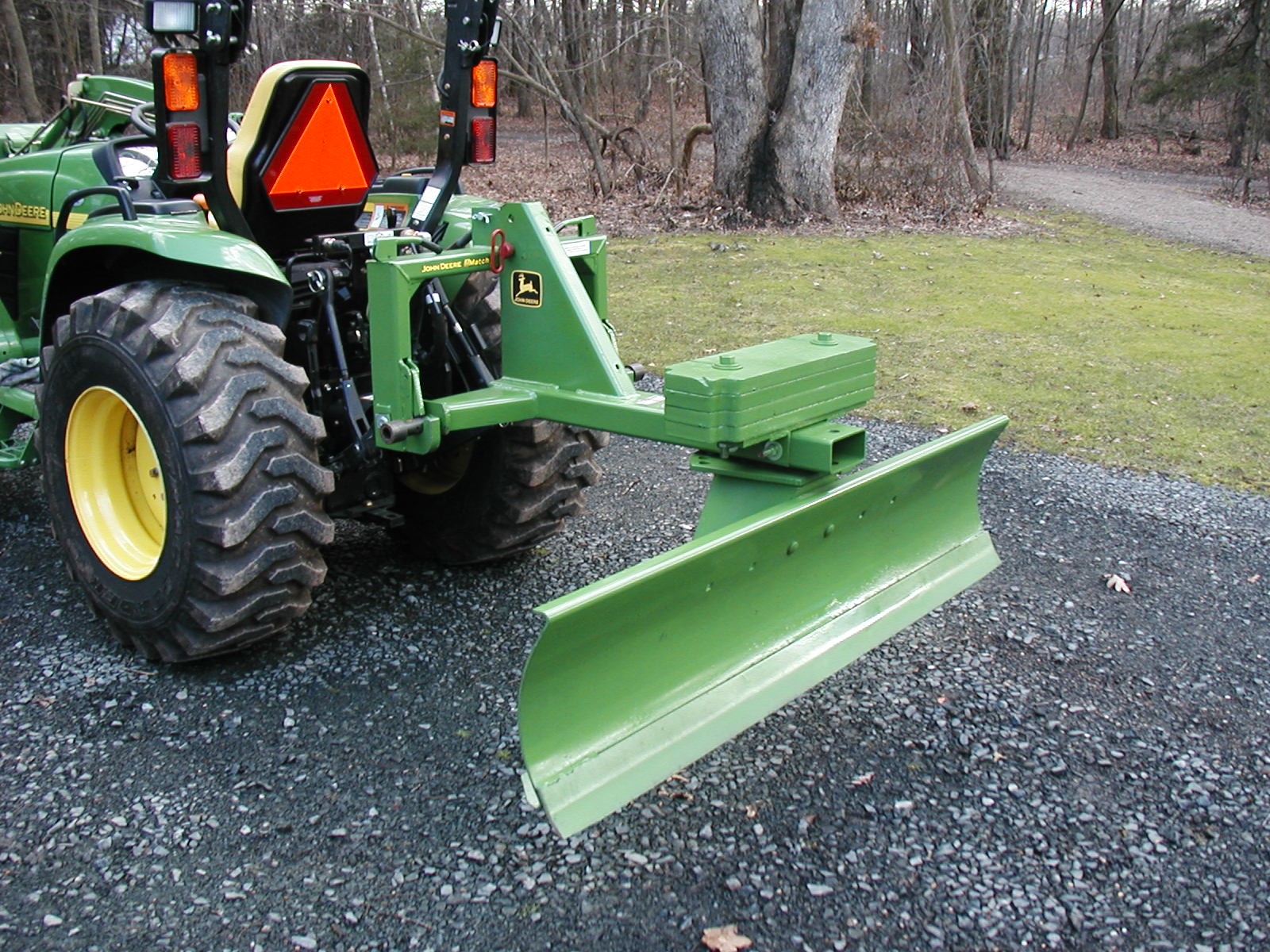

I think adding weights is a good way to fix up a lighter box blade but given the choice I prefer to have this weight add to the structural strength of the implement. Here is a picture of my 4520 and boxblade.
#14
I agree I have beefed mine up a bit. I laugh when I think about something my son said to me when he was 7, I brought home a brand new log splitter and he said when are we going to work on it to make it better? I about busted a gut. From his perspective everything needs beefed up.

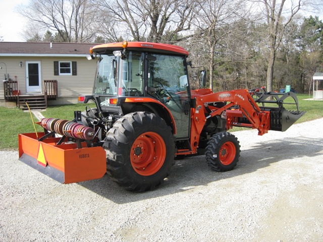

I use the suitcase weights that suppose to go of the front bumper, although
now with the weight of the FEL I find myself having to weight down the rear, I have 3 of them I need 1 more to make it even weights, but I think the box coulod hold total of 6... 3 on each side
I know they will be in the way once ever use the box scrap but they do put easily on and take off,;)
/ Box blade weighting, do you add weight? #20
The weights in your picture shouldn't be much of a problem and could be easily raised with the addition of a piece of flatbar on each horizontal crosspiece. I suspect they would be a real help blading hard surfaces.
