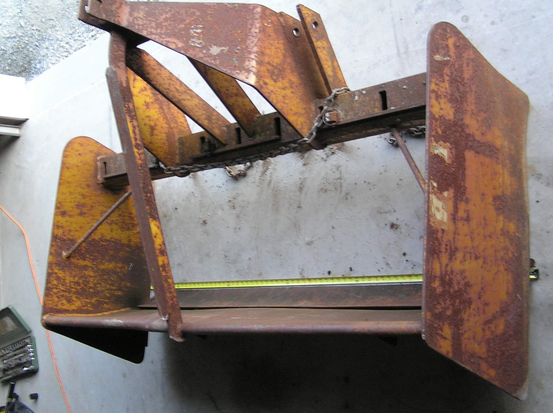

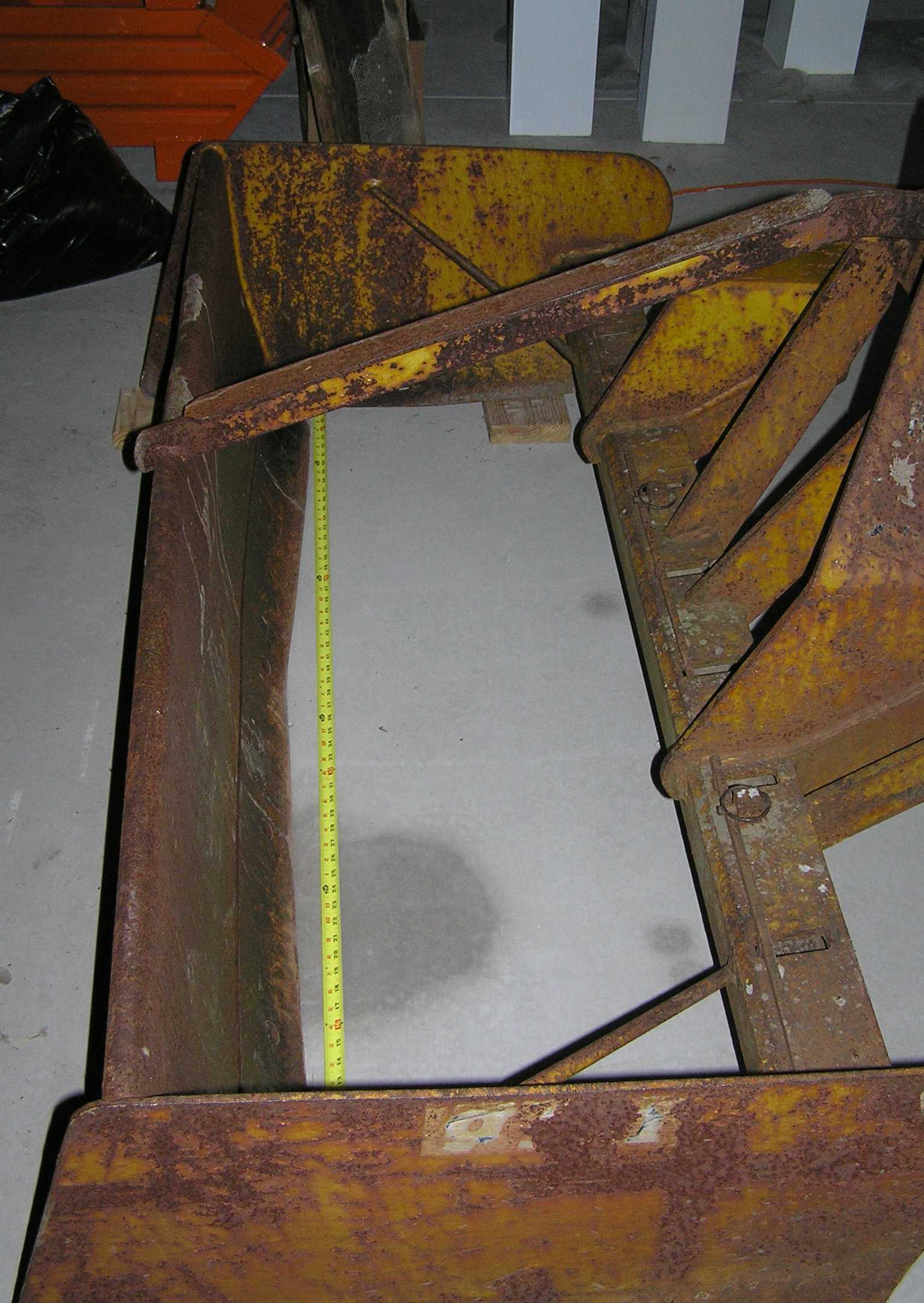

The bottom edge is well worn. I think a lot of the wear happened after the blade was bent. So even is I straighten it the edge won't be straight. I'd like to flip the blade because the other edge has not been used. But as it is, the bends would end up in different places.
Giddyup:
I saw your pictures. The hardest part of fabricating a back plate is getting bends that accommodate the blade just right. I also wondered about all the different support pieces you have on your back plate.
You said your holes are broken out. On mine it looks like the holes go through the back plate (1/4" and the angle (1/2"). Do you have an angle welded to the back plate? And did the hole break through the angle also?

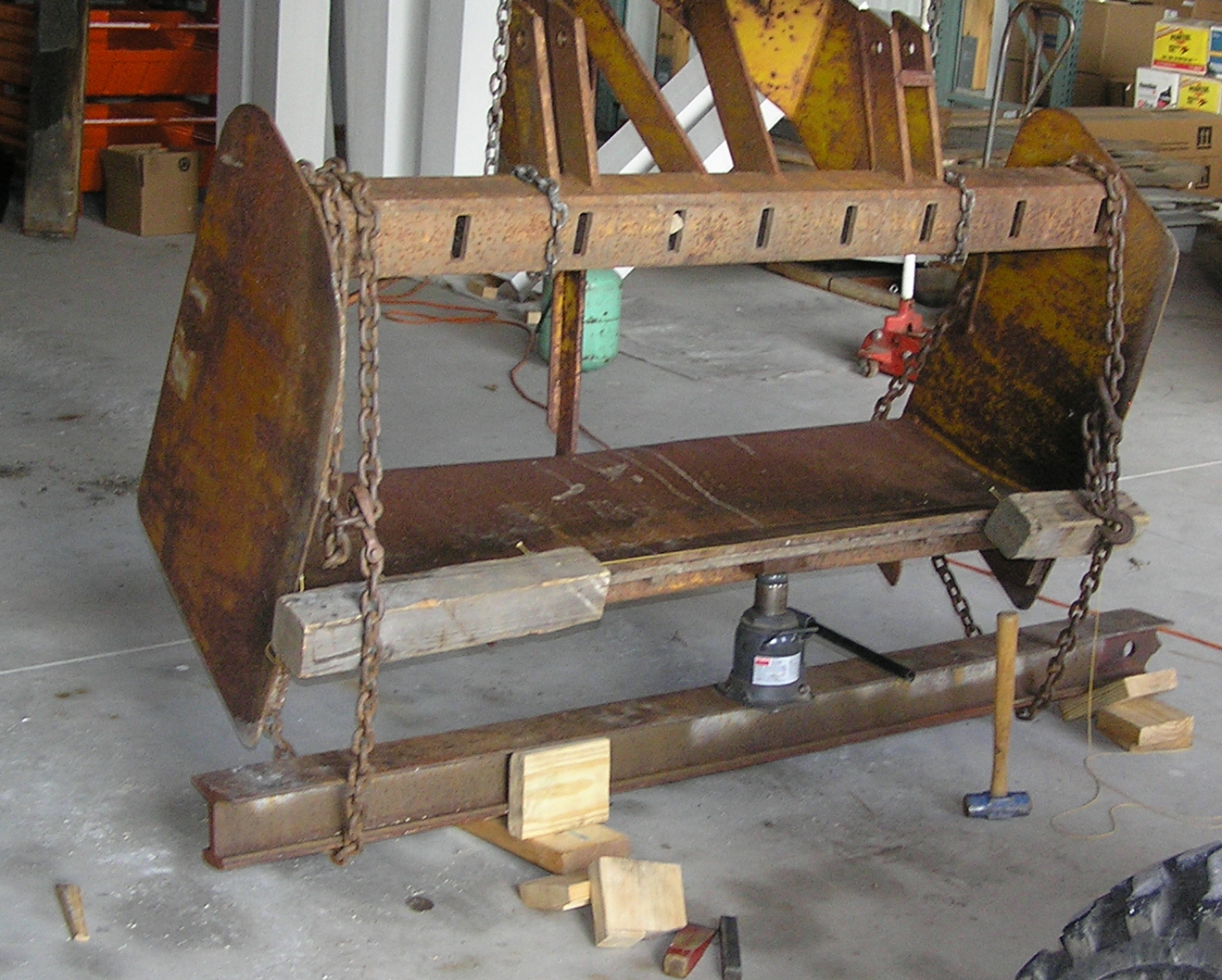

Kebo: I was kind of thinking the same thing. Bottle jack versus some immovable object.

The holes that are broken through on mine are for the front blade. And yes, they are broken through both the thin face plate as well as the thick piece in the wedge. I couldn't tell this until I cut the bolts off and removed the blade. Yours looks more intact in this area.
There is no heavy backing for the rear blade, just the 1/8" hinge plate. Holes are fine, as you can see, with just a few bent up places. My new rear blade has made it to the dealer. Plan to pick up tomorrow.

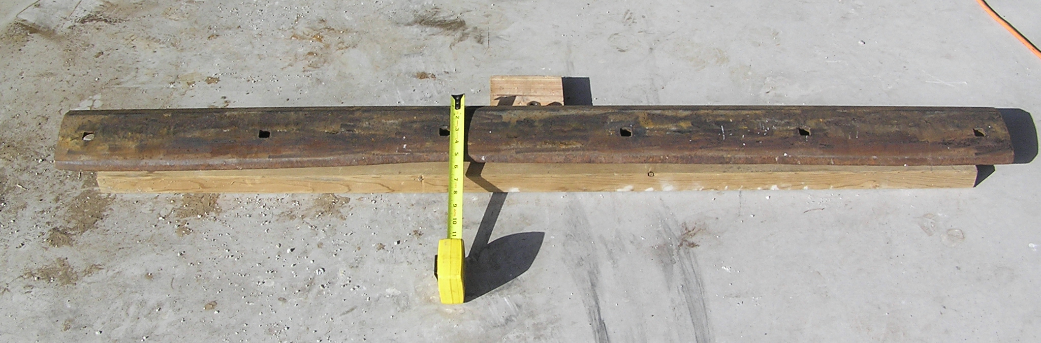

Well I had a chance to work in the box blade. First I heated the blade to about 100- 150 oF. (warm but not to hot to touch.) It was very cold in the barn and I was afraid the blade would be brittle and break if it was to cold. Then I took an old railroad rail (100lb/yd) and chained (3/8" grade 8) it to the box. (see picture below) I put the bottle jack between it and the bent blade. I had to put the 4x4's behind the chain in front of the blade in order to keep the jack pushing in a straight line against the bent area. I jacked it until it was about 1/2" - 1" past being straight, so that when I released the jack it came back to straight. I was looking at the angle Iron behind the blade for straightness because the cutting edge of the blade was severely worn. (see picture). In fact it had 1/2" worn off at the ends and 1" worn off in the middle.
When I finished I took the blade off, flipped it over and bolted it back on. See the last picture. I was pretty pleased with myself. It went from abot 4" out of straight to about 1/4" out. (Full disclosure: It took me several attempts and about 2-3 hours to get that far.)
