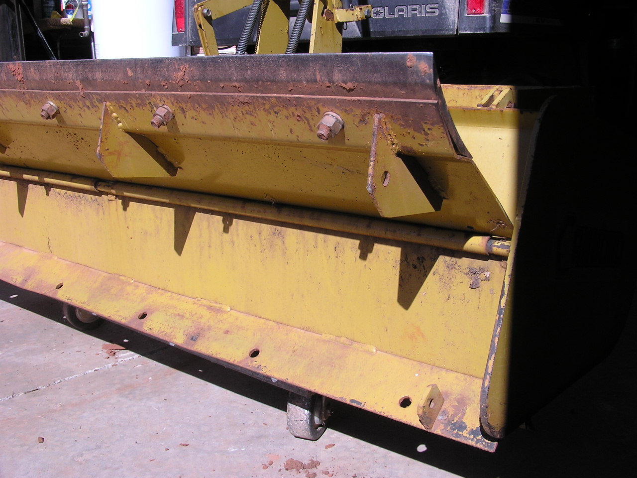

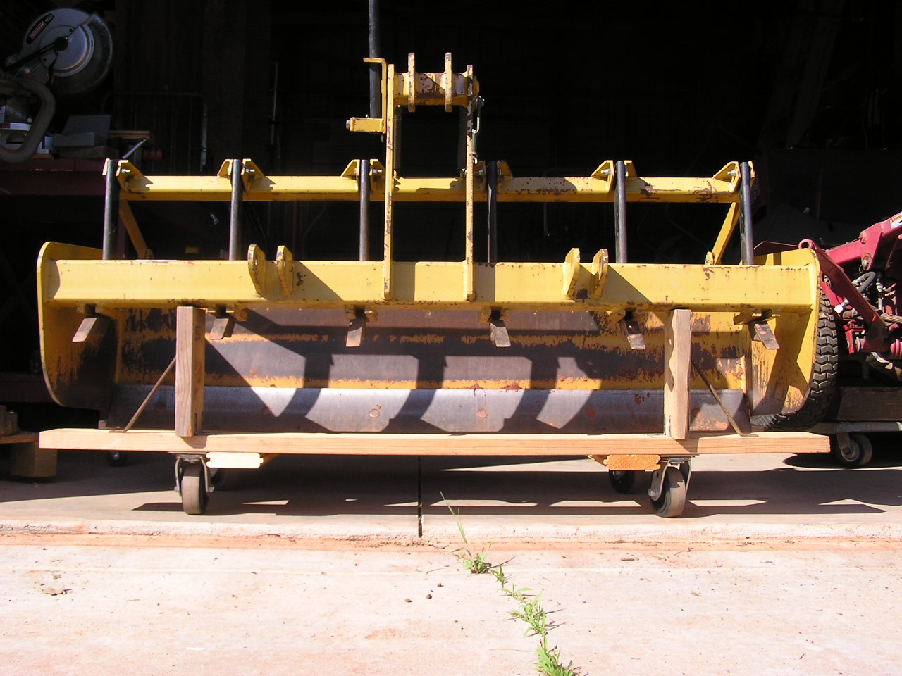

My 6 foot weighs about 650 pounds, has a lever to raise and lower all the rippers at once. They latch all the way up or all the way down.
430548-box-blade-question-ripper-teeth-p6040002-jpg
430550-box-blade-question-ripper-teeth-p6020014-jpg
430551-box-blade-question-ripper-teeth-p6020024-jpg
It has the hinged rear blade that can be pinned solid.
430552-box-blade-question-ripper-teeth-p2130002-jpg
That's a cool looking set-up. I especially like that flip-up blade. Mine is on a hinge so I can see another project for this winter in my future.
Well not exactly a "flip-up blade", guess I should have used this picture.
430560-box-blade-question-ripper-teeth-p2130009-jpg
Or this one. :D
430561-box-blade-question-ripper-teeth-p7030017-jpg
