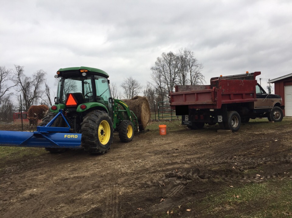

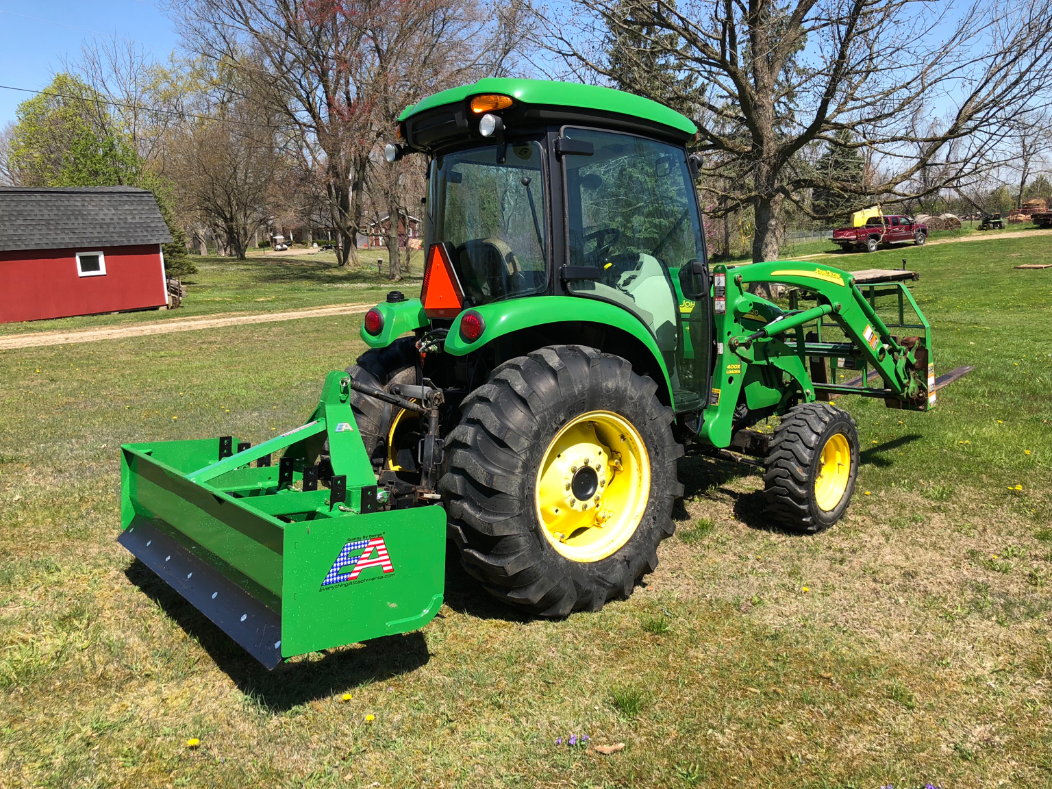

The first thing I bought after I picked up my tractor was a used 6ft Ford blade, I painted it back to the original Ford blue color. I gave $125 for it I think.
I used it on my gravel driveway to shave down the hump like what you have, I put 100lbs of chicken feed on top of the blade so it would dig better.
I rutted my pasture over the first winter when it was stupid muddy outside, in the spring I tried to grade it a bit with weight on the blade and it didn’t really do well, the dirt was too compacted, it was better than before but far from smooth.
Every winter so far I have been able to get away with just the rear grader blade. I wouldn’t sell my blade, it’s worth having it vs what I would get out of it.

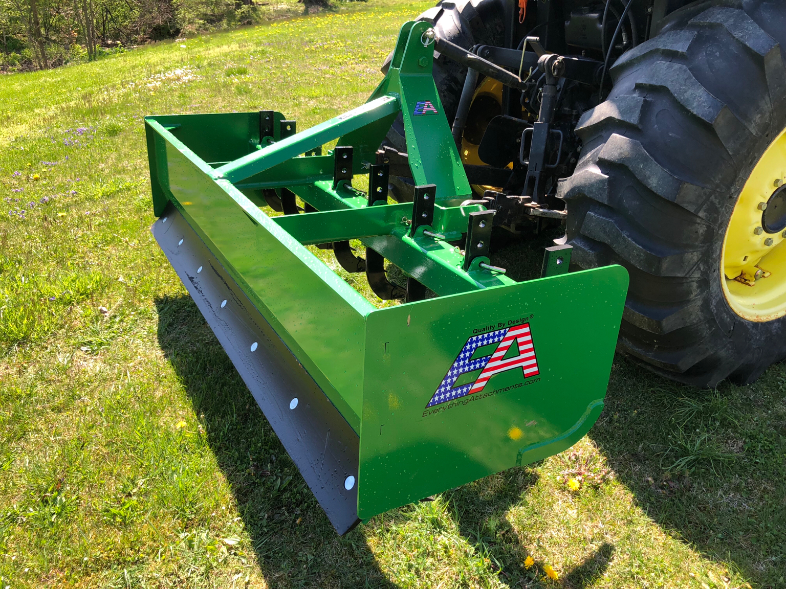

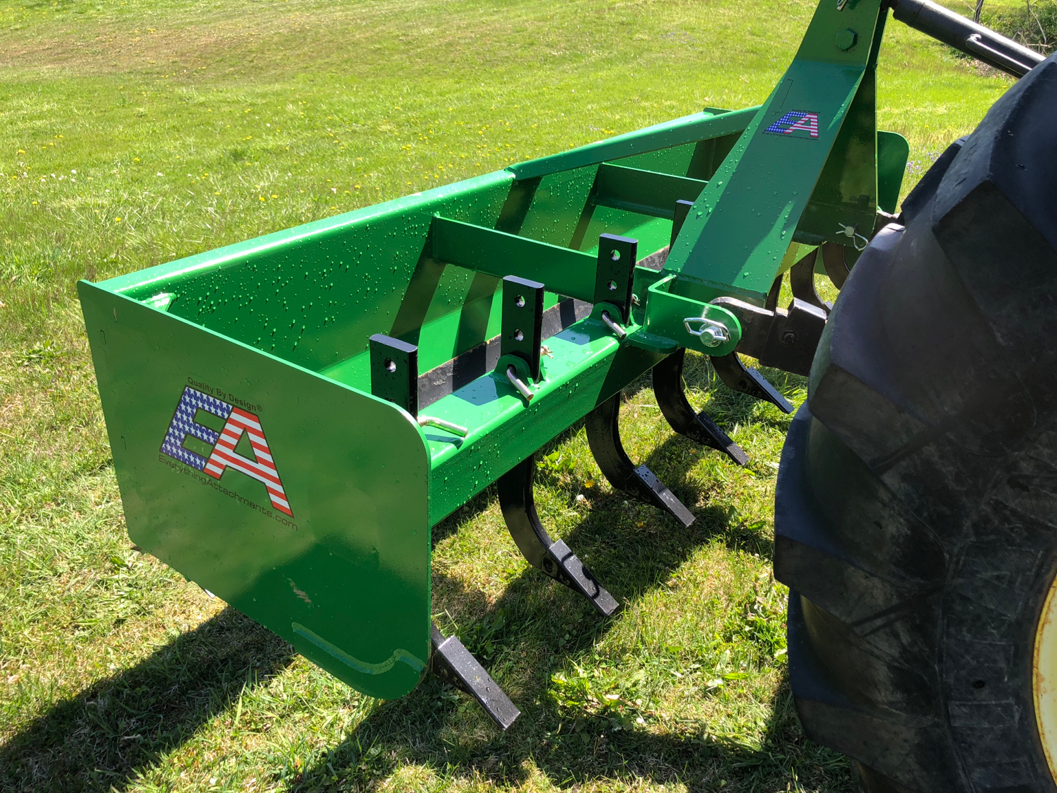

Almost two years after buying my tractor I had some money, I got it in me that I wanted a box blade so I searched CL, I was shocked how much people wanted for them used, most were in the $500-600 range, so I started shopping for a new blade, hand wrote out basically an excel file with 28 different brands of BB’s I believe. For the money it was down to Woods, EA and King Kutter pro line.
I chose the Everything Attachments XTreme 78in and had them paint it green. 100% made in USA, I had to wait a little over 5 weeks to get it, but it’s a very well made blade. Gave over $900 for it, can’t remember exactly, was under $1000.

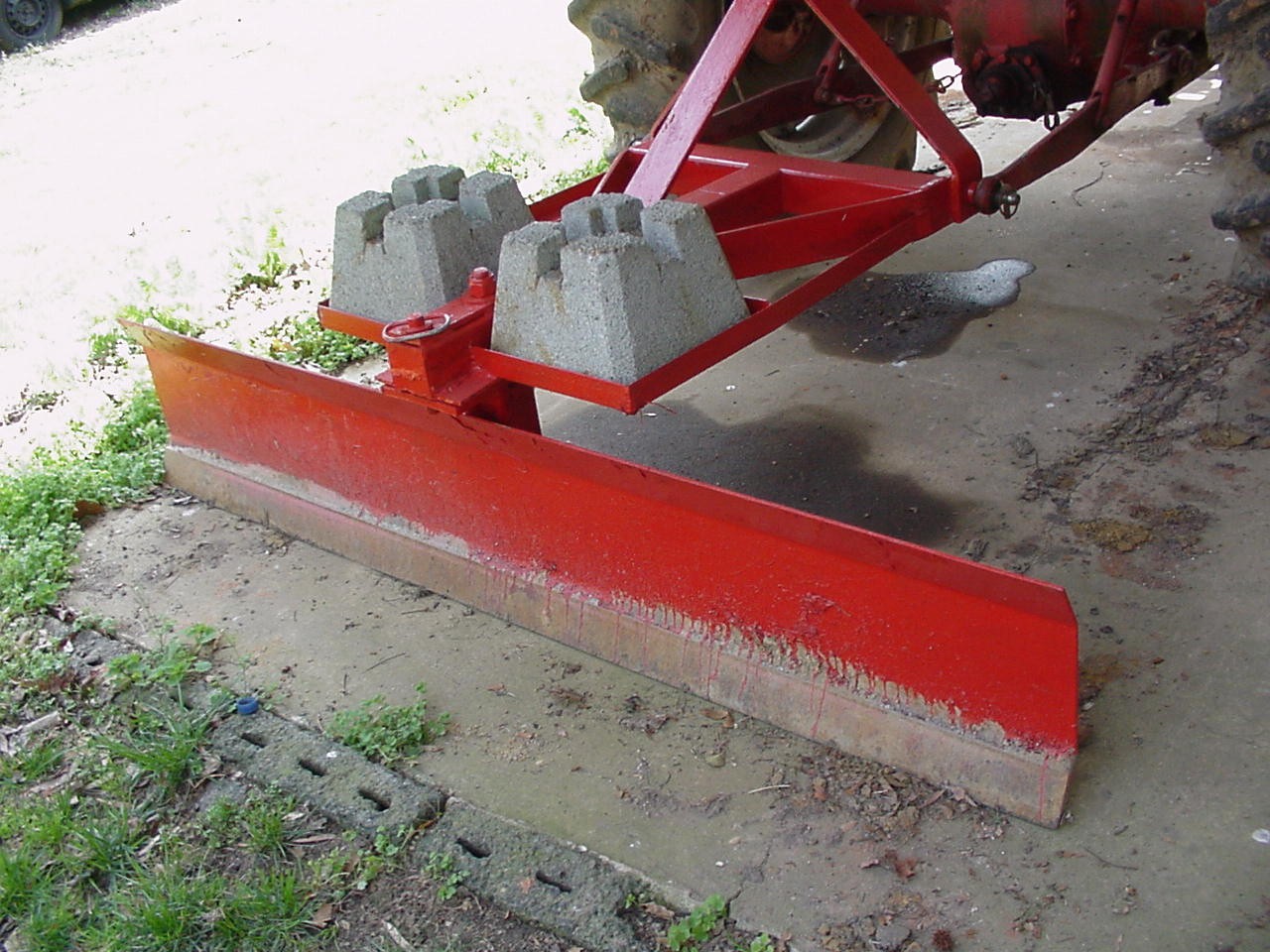

Used rear blade and some bags of sand and you will do most of what you need ok, that won’t be as good as the job a BB or land leveler will do on some jobs, but over all a grader blade is more versatile. EA has fancy ones that offset and tilt, would be great for ditches.
I think they make one that has wings that fold in to move material like a BB, haven’t looked into them much yet.
Another trick to grader blades is they smooth better by being drug backwards, they don’t dig that way, they don’t pick material up but just smooths the surface. You can get rear blades all day long for $100-$150 used in good shape, the old Ford blades are solid little suckers, I was gonna paint JD decals on my blade and paint it green, it’s worth more as a Ford blade so it was painted blue lol.
