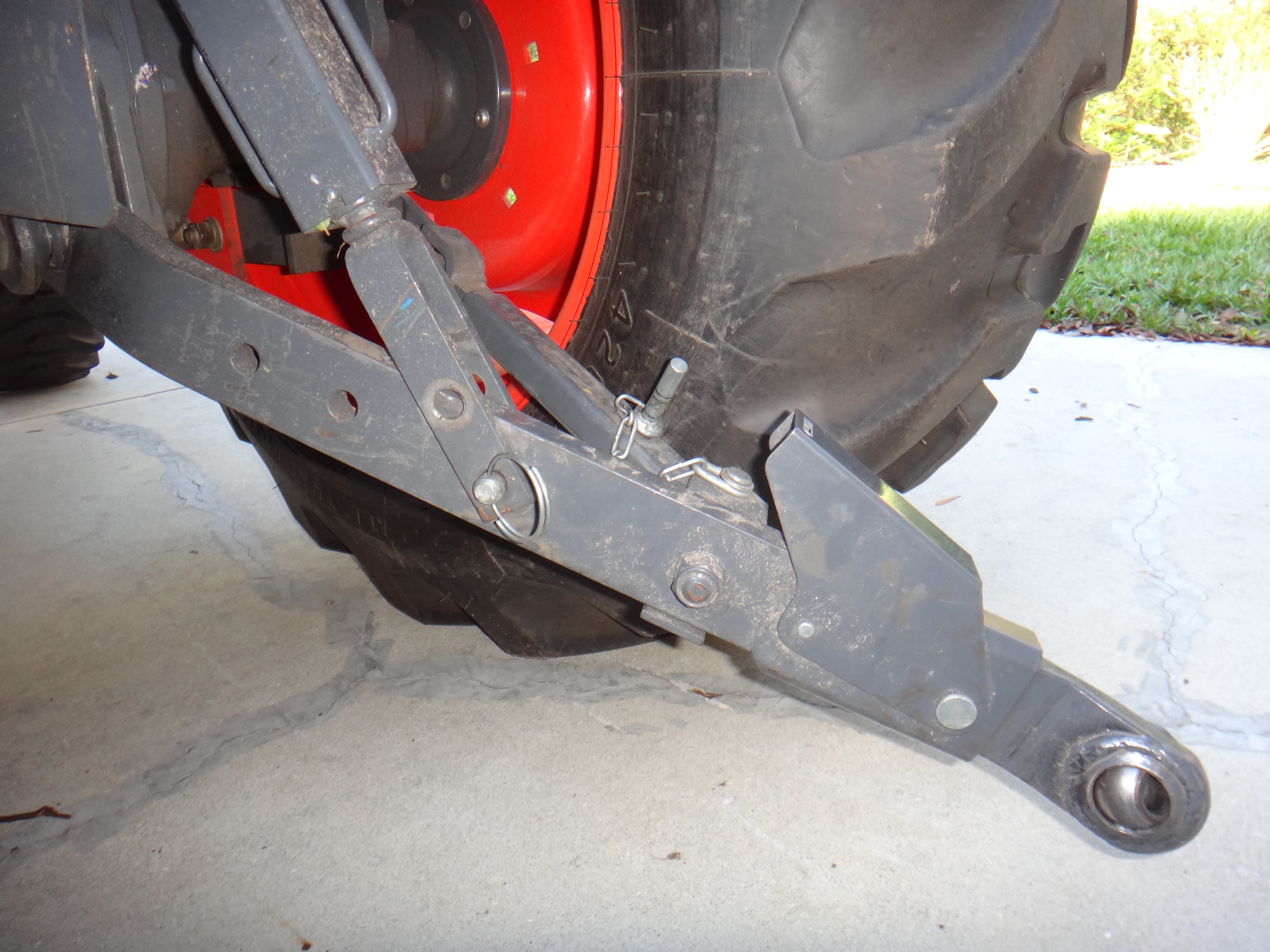

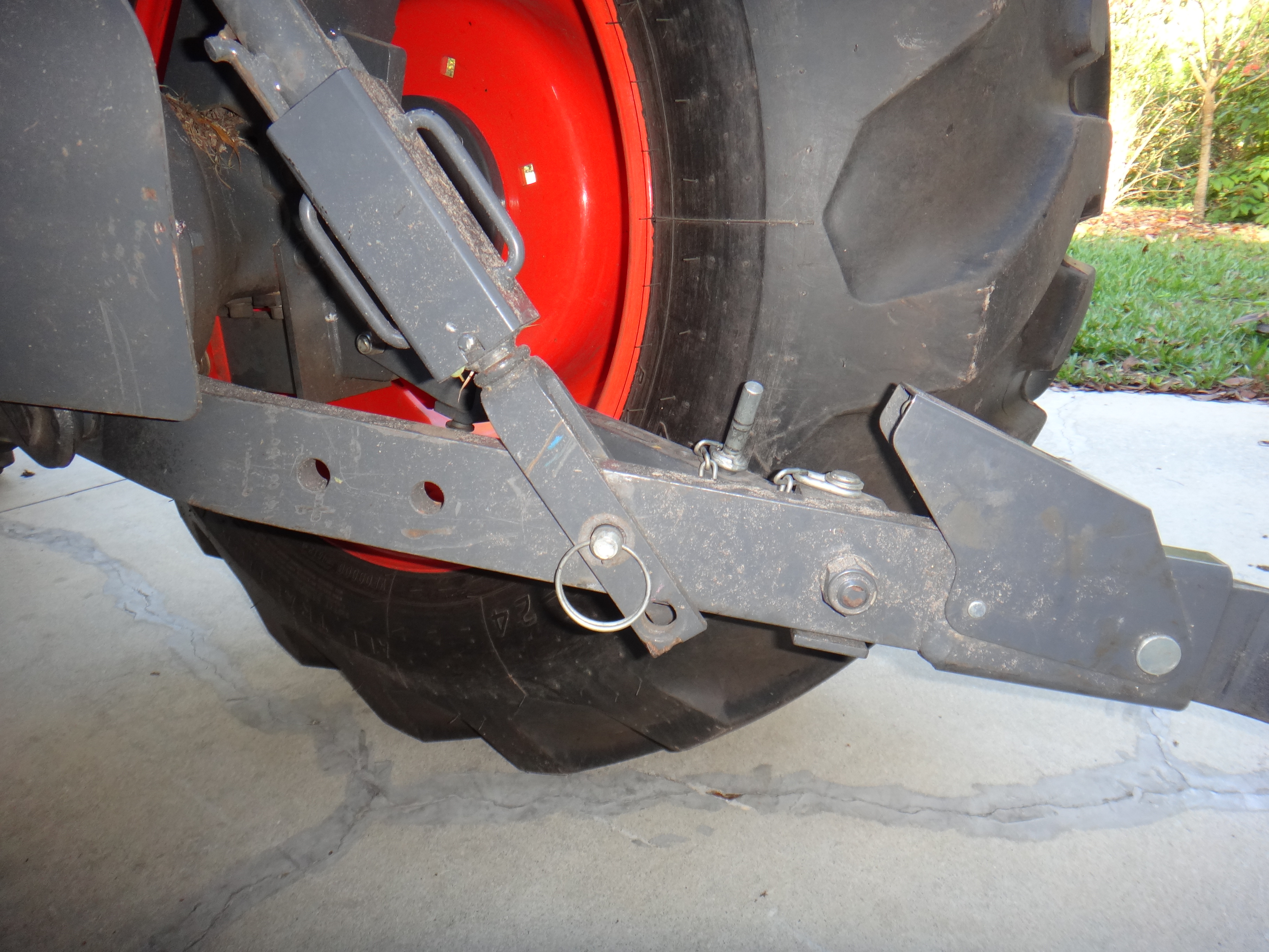

Kubota L3560 photos:
#1 Standard position for Lower Link, stirrup pin in UPPER adjustment hole. Note Lower Link angle.
#2 Optional position for Lower Link, stirrup pin in LOWER adjustment hole. Note Lower Link drop.

When pulling down hill with a Box Blade this 3-Pt. adjustment may be helpful:
The solution is to move the adjustment pins for the Three Point Hitch right and left Lifting Rod stirrups, which attach to the Lower Links, from the TOP hole to the LOWER hole. This will allow your Box Blade to drop down 3" to 4". Then play with Top Link length.
Removing pins is easy with implement off. Grease pins lightly. I use anti-seize compound but any grease is fine.
This pin adjustment is useful when using a Box Blade, Landscape Rake, Rear Blade and/or Turf Thatch Remover.
Jeff9366 - I understand what you are saying, but I'm not sure why that makes any difference. If I'm pulling downhill, the tractor and the 3 pt hitch are tilted down the hill right along with my box blade. The geometry of all of this relative to the ground still remains the same. The only time I could see this making a difference is that brief distance when the tractor transitions from level to down hill, but the boxblade is still back on the level ground. I guess it's possible that the boxblade might not lower enough to engage the ground until both the tractor and the implement were on the downhill slope (though I've never experienced this problem myself: my box blade still seems to have plenty of downward range of motion).
Am I missing something in what you are describing?
Not it does not. The cutting edge of the Box Blade will be 3" to 4" lower, that is why there are two stirrup holes.
It is easier to try it than to type about it. Give it a go.
