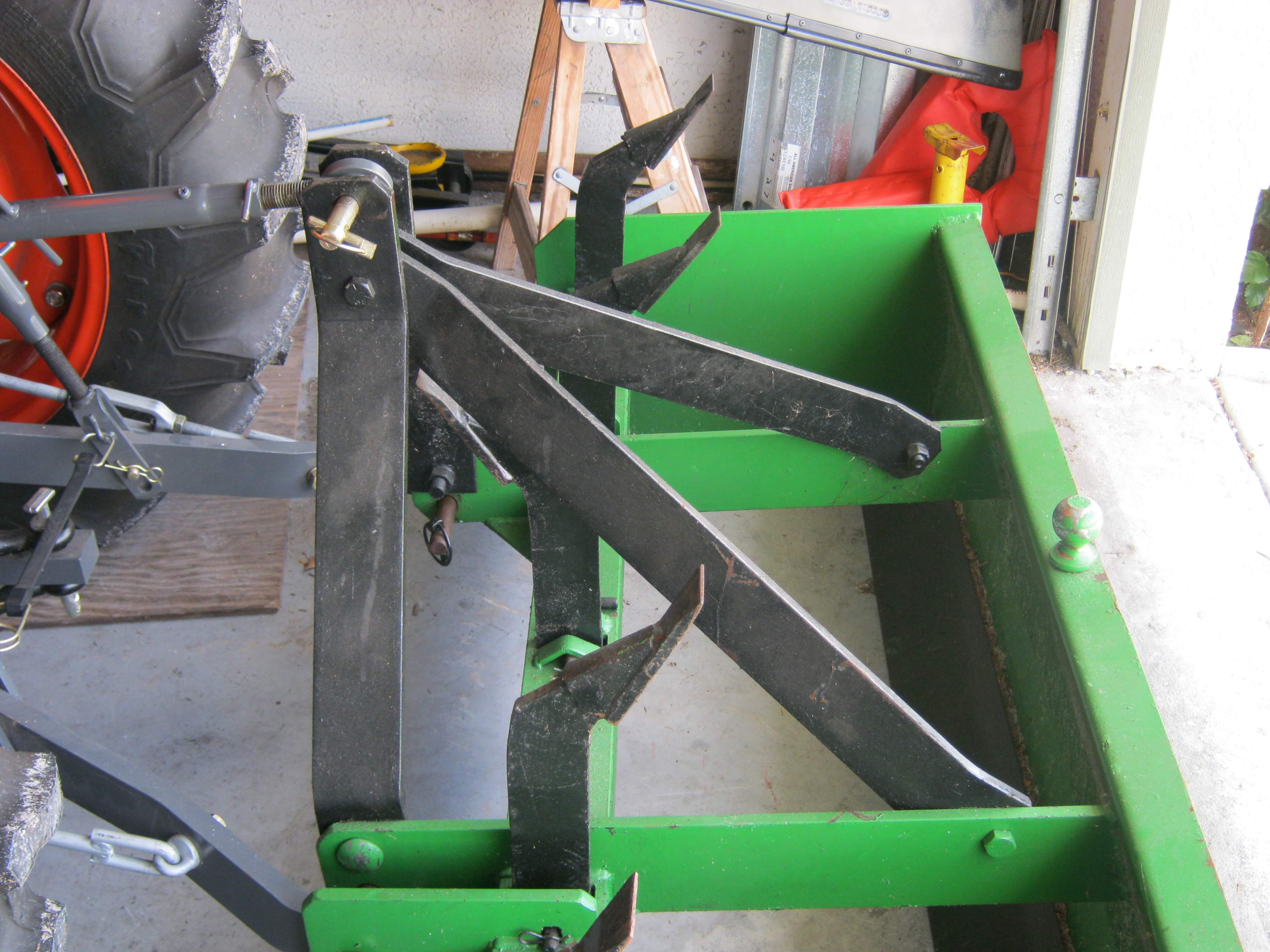

Anyone else ever use their box blade to move goose neck trailers with? I mounted a 2 5/16" ball on the back of my Frontier 5 1/2" box blade by drilling out the existing center hole to 1" and mounting the ball there. Seems to work pretty well.
Any thoughts or suggestions?

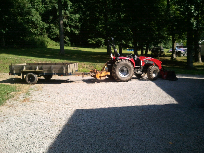

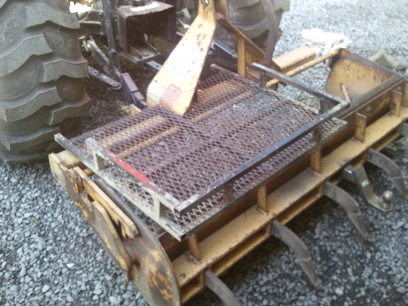

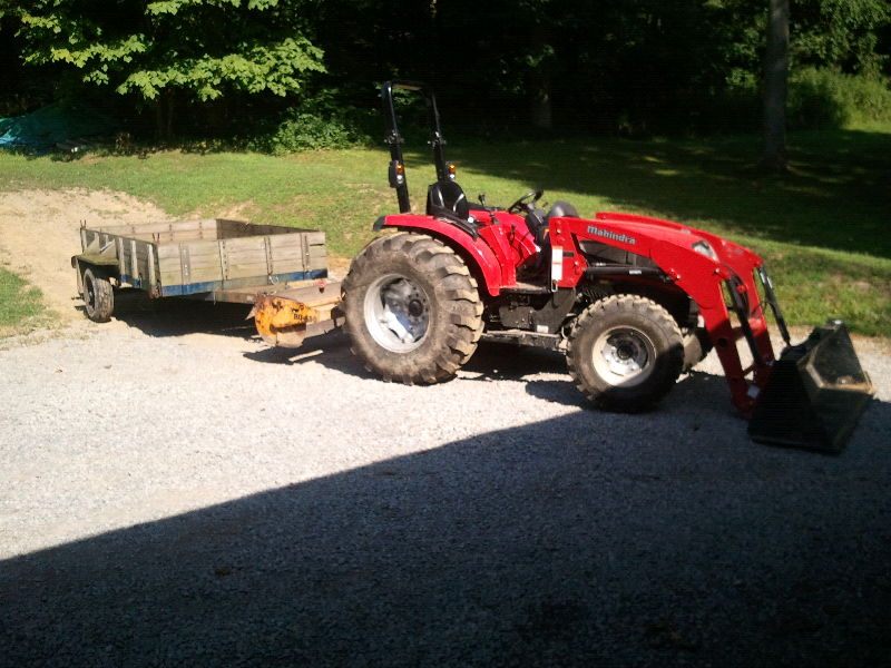

I welded a reciever on the back of mine. Saves me taking it off

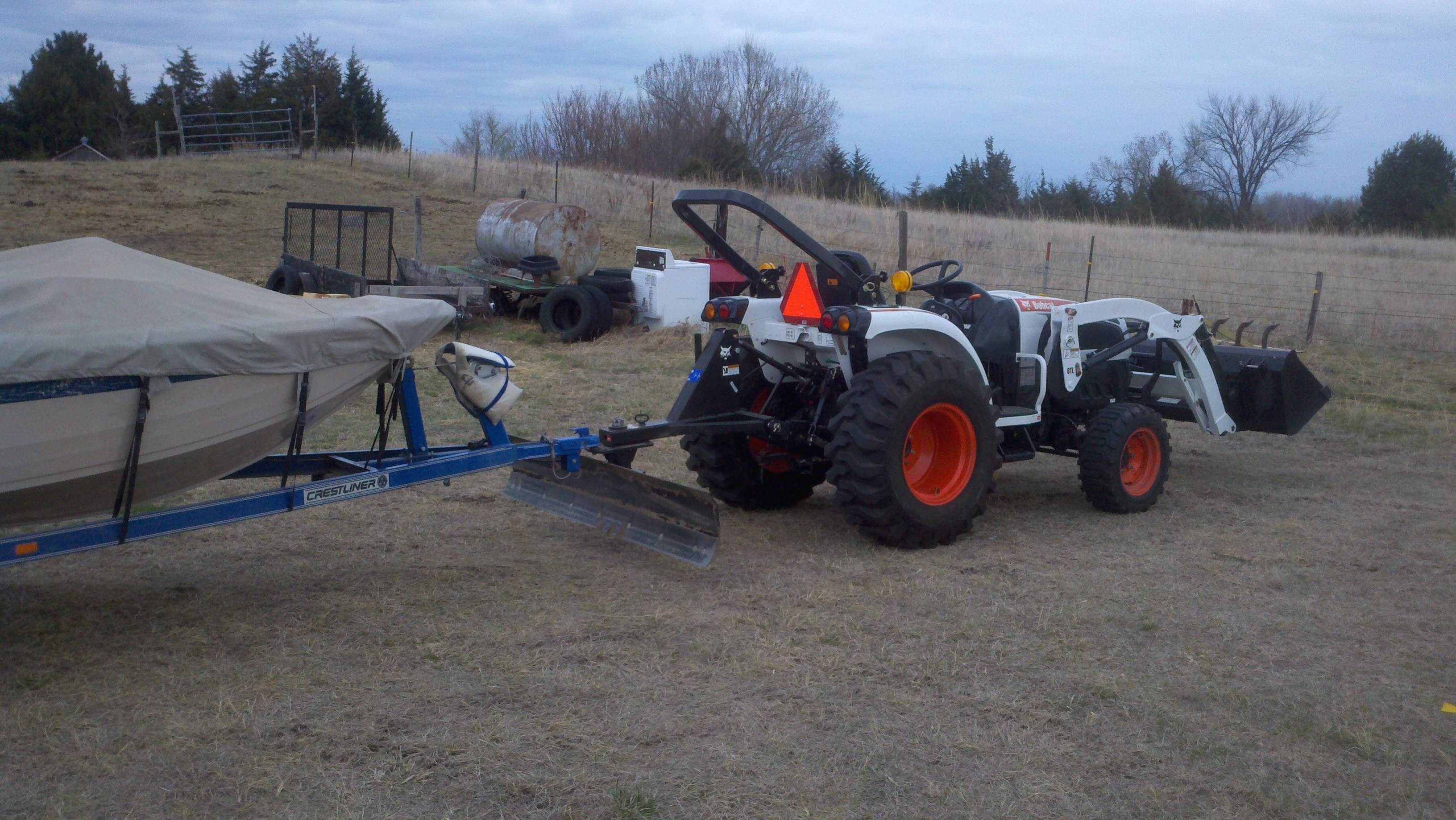

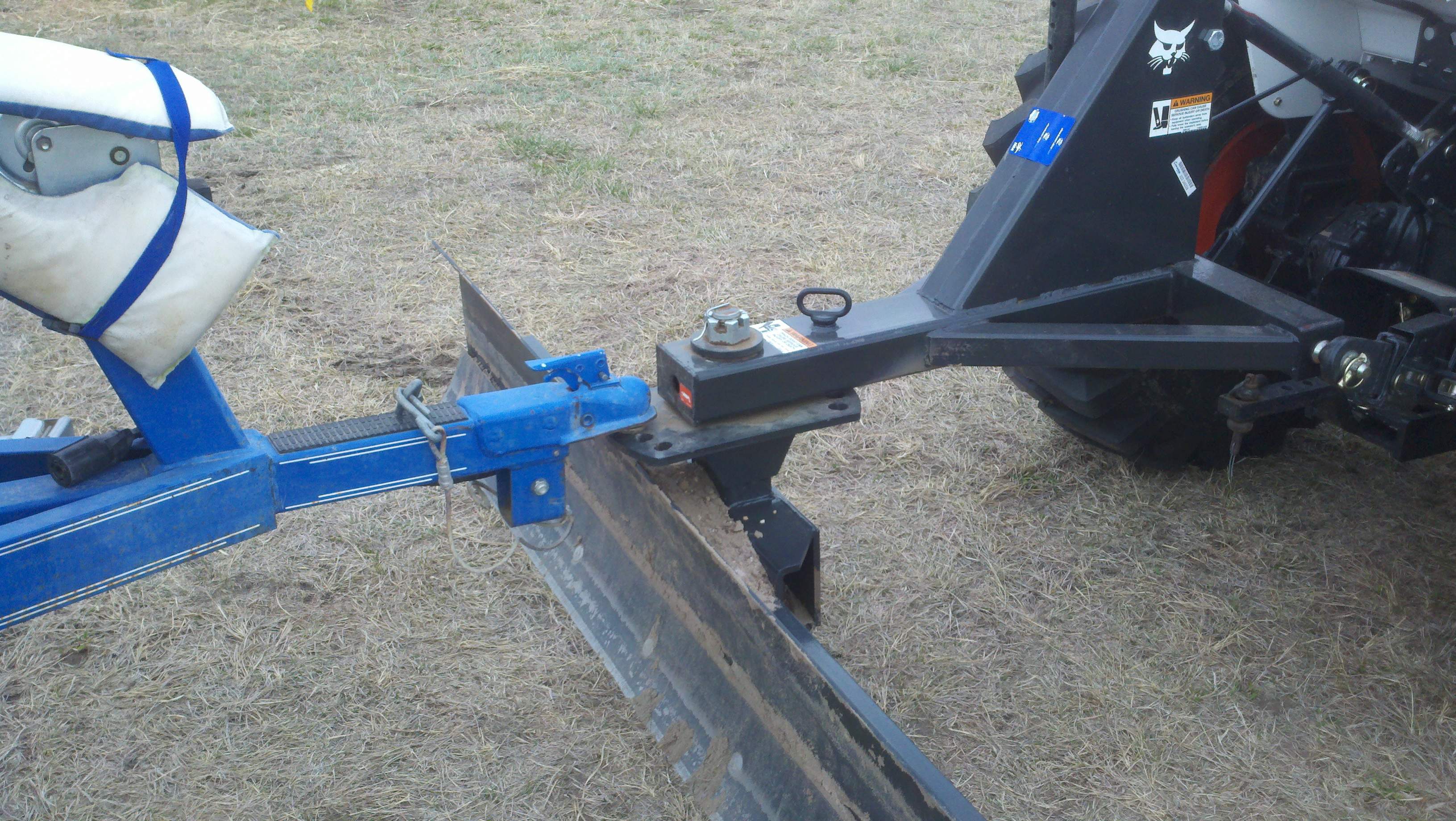

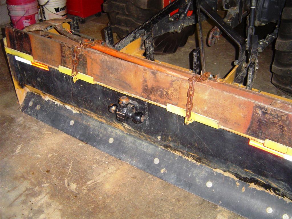

I never use my box blade but i do use my rear blade alot to move trailers sure make's it fast and easy.

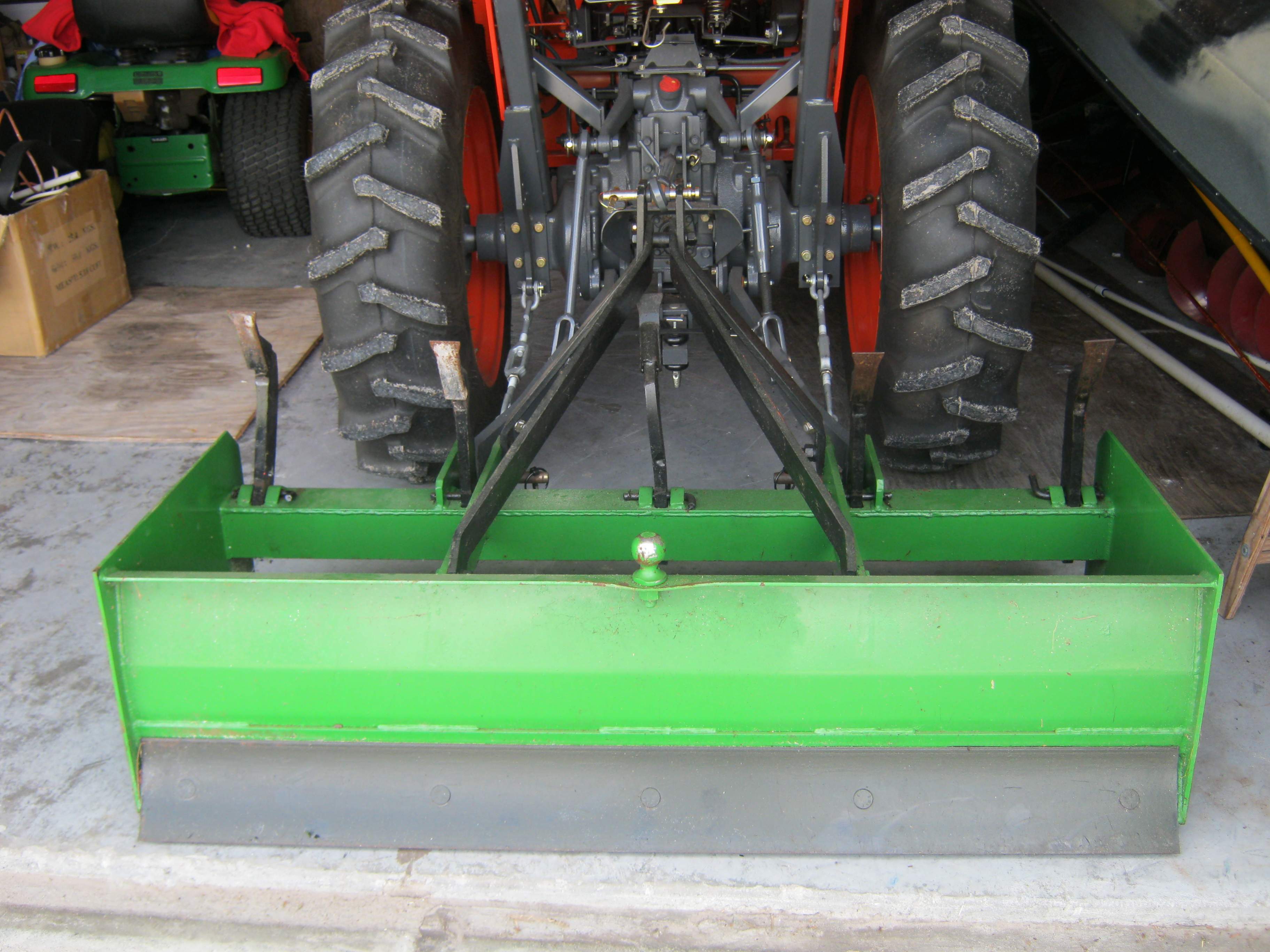

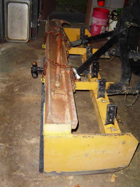

Here's mine.
Boone

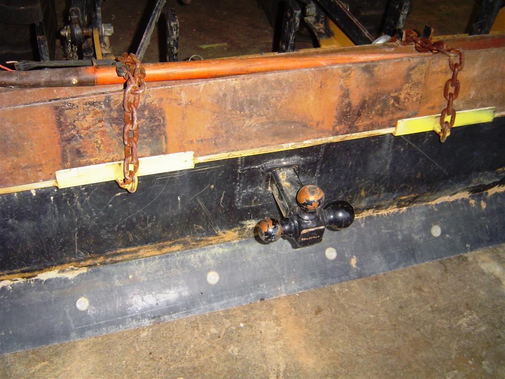

I also welded in a receiver...
