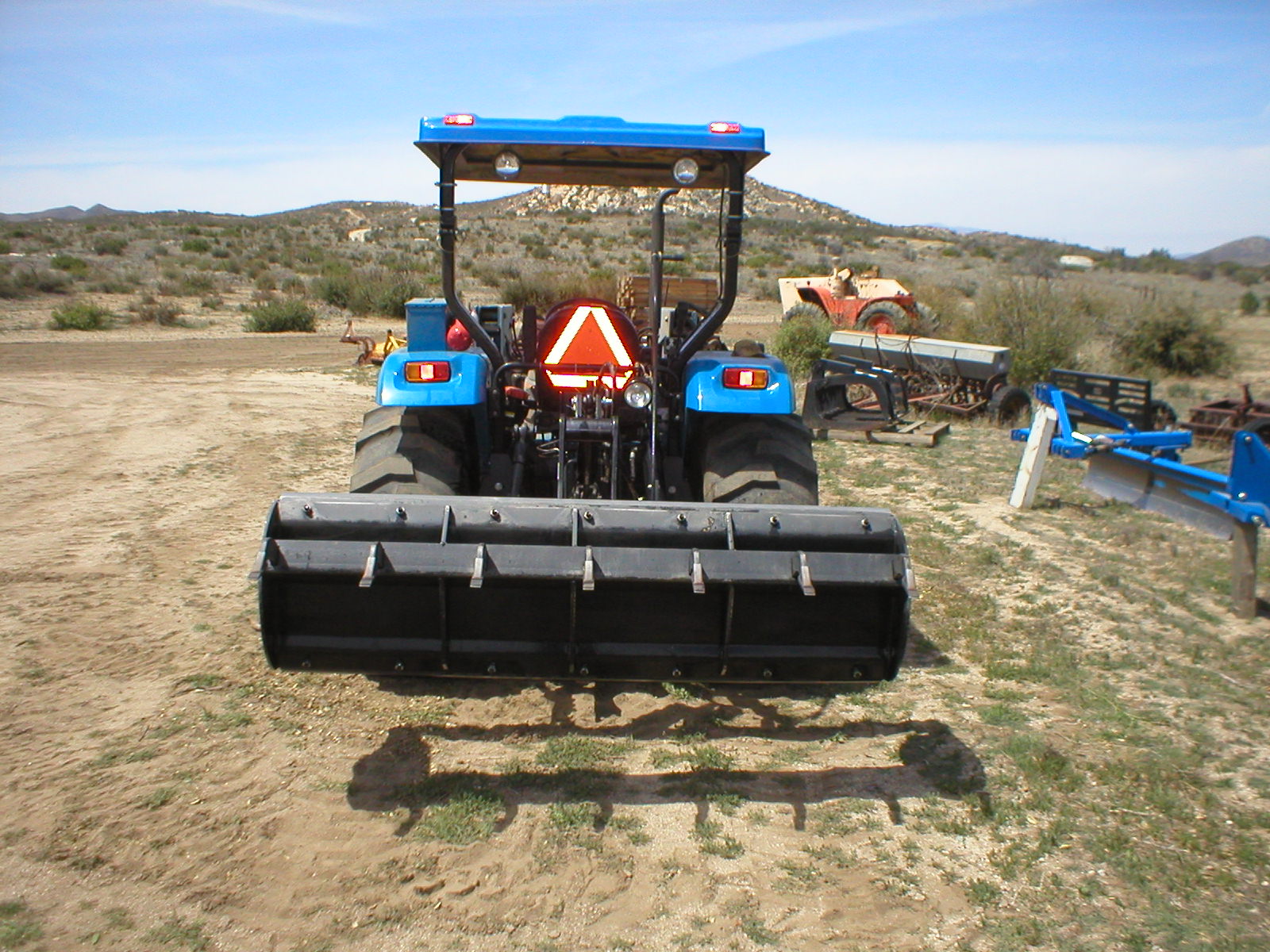

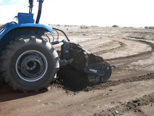

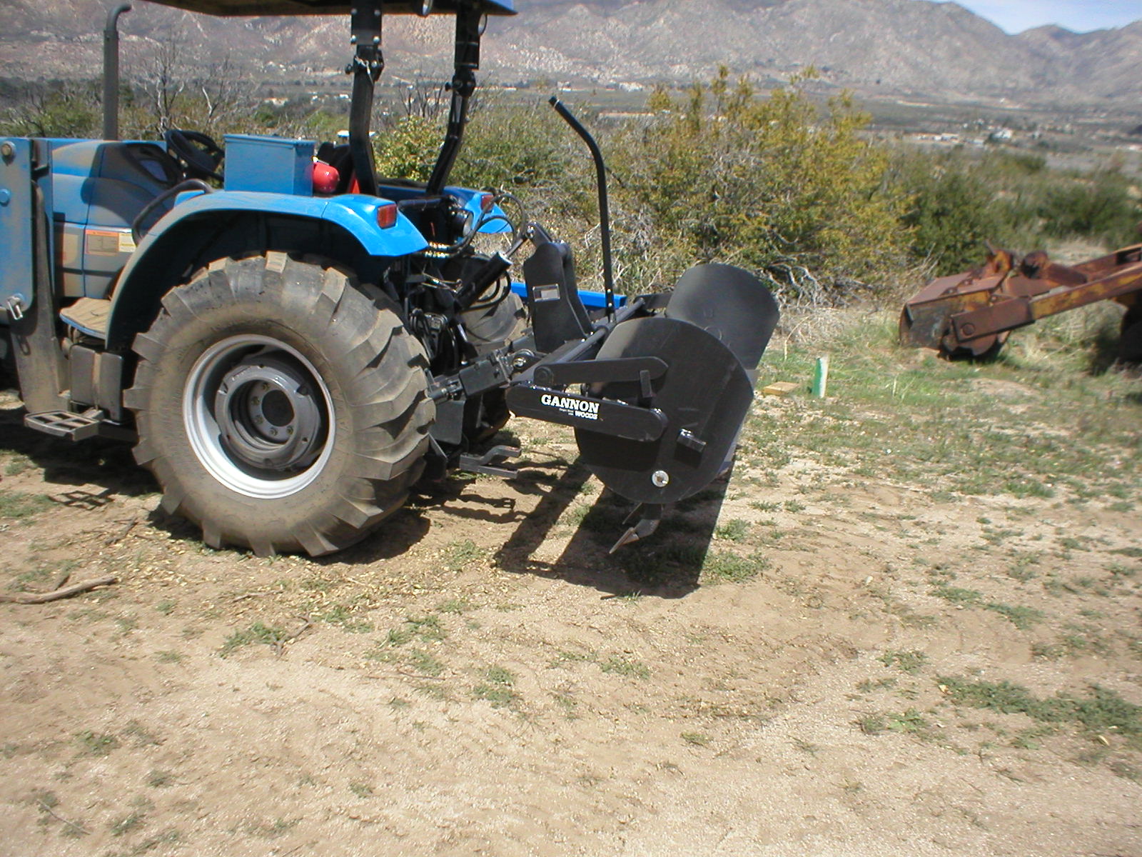

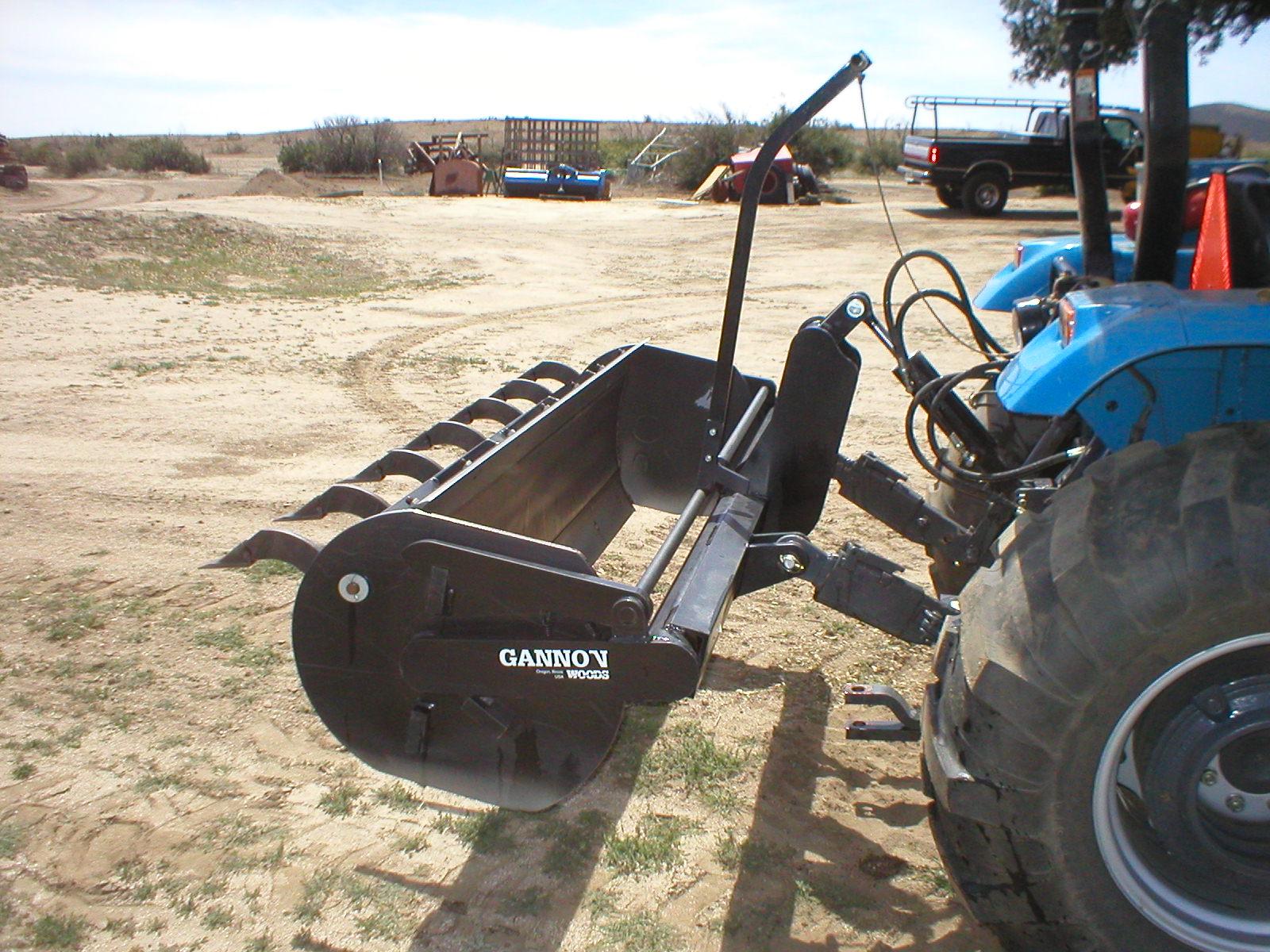

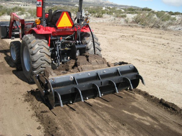

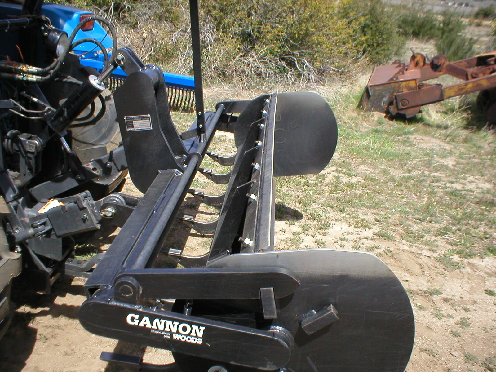

A lot of people that have ROBBs would never have any other kind. They work differently than the std box blades and take no top link adjustment once the top link is set. A std type box blade requires a lot of top link adjustment to be most effective. Thus the need for a hydraulic top link.
I happen to have 3 Gannon ROBBs.
An 81" unit at 1000lbs.
A 65" unit at 800lbs.
And a 36" unit at 140lbs for our garden tractor.
Gannon discontinued them in 2006.:(
Before the hydraulic actuated scarifiers came about, the ROBB box blades were the deluxe units that most every commercial user would have.;)
