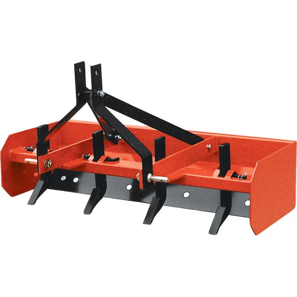

Hi group. I've read a number of posts about box blades and I think that I could get some good uses out of one. For example, I just (finally) finished digging out a 65 foot walkway with my backhoe, but it seems that a box blade would have actually been more efficient to use. We have many more walkways to do over the next few years, and we also have lots of land that we're going to need to flatten out. (Already have a normal grader blade that helps somewhat with that.) So, my questions are:
1. Is the Kubota box blade (48" BL7548) really not the best one to get? I've read that it's lighter than many others and also a bit more expensive than some other solutions. I like the idea of getting the Kubota one, because a) it'll be nice Kubota orange :), and b) it seems that when it comes time to sell the tractor, it'd be a good thing to have all Kubota attachments to go with it.
2. I see that not all box blades have a hinged flap in the back. What are the advantages and disadvantages to having that?
Thanks to anyone with experiences and knowledge to share!

The hinged back cuts the wear on the rear cutting edge while pulling the box blade with the rear lower then the front for grading. To some it might mean a lot as far as wear on it but for average home users it doesn't make much difference. The 48" box blade on the back of a BX is a hand full for the tractor to say the least. To fill it you might even need to load the front bucket for ballast to help control wheel spin. I don't mean to say you can't, it just means it will work the tractor pretty good.

I've got the Farm Force BB from Tractor Supply for my BX2350. It's definitely heavy enough, and built very well. As a bonus, it's a beautiful color...

I also have (and like) the box from Tractor supplyl. One quick comment on it though, if you plan on stressing the shanks (I had to loosen up some compacted gravel), you will probably want to reinforce the points where the shanks impact the cross bar. On mine, the square holes in the started to tear. If you are going to be in dirt most times this will not be a problem. The gravel I was going through came from the millings when the highway contractor re-did the road and there is some asphault mixed in that really glued things together in the sun. I would not hesitate to buy another one.
