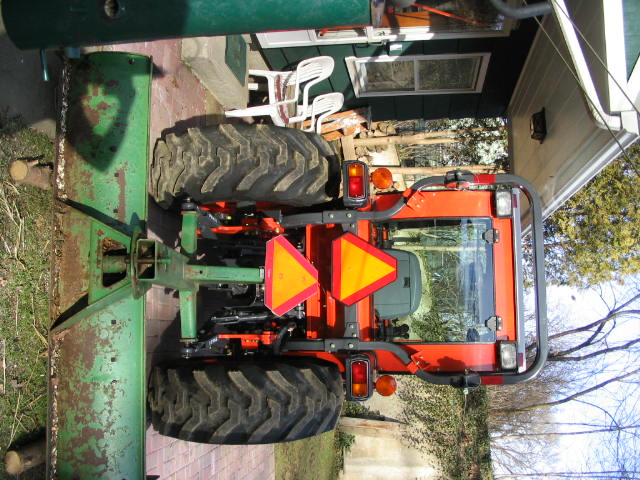

Hi...
I had 2 removable wings made for the angling grader blade... so I can use it just as a blade... or a box blade... or a combination with 1 wing on... see attachment...
I always use it for snow removal... whether with the loader bucket on... or a front snow plow...
I pull snow with it... and also push snow when I'm backing up even with the blade facing forward... works great...
Dave...

Grader blade wings...
You can see in the attached picture there are only 3 bolts/nuts holding each side wing... 2 at the wing's "L" flange... 1 holding the cross brace...
The wings have a 1/2" wide "skid" shoe the full length of their bottom that rides on the ground...

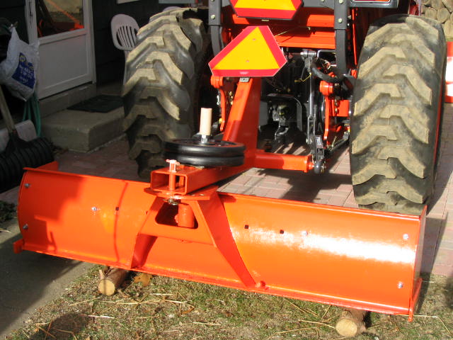

I refurbished this John Deere blade shown in the following post...
This blade is holding up well... I bought it used ~7 years ago... my sons used it snowplowing about a dozen driveways for 3-4 years... It was then on a Deere 750 with a front snowplow...
The past 2 years I use it for 2-4 driveways with a front loader on the Kubota...
Dave...
/ box blade and snowplowing #10
Before...
Dave...
