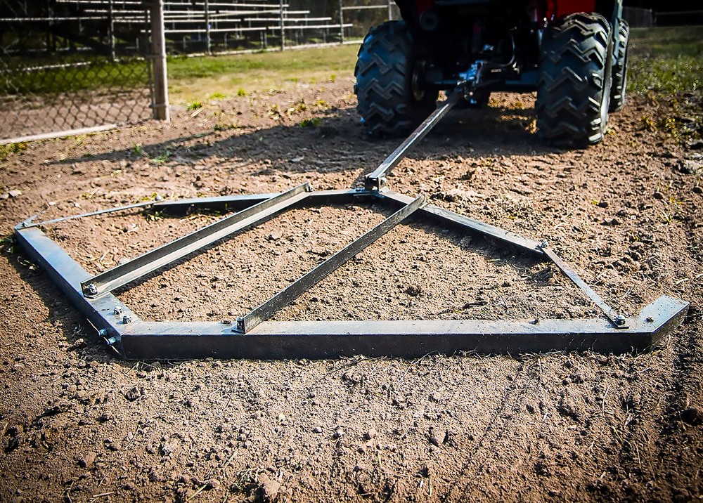

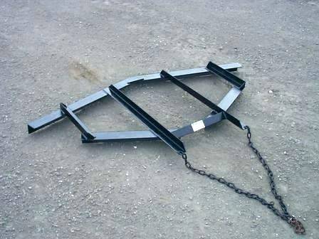

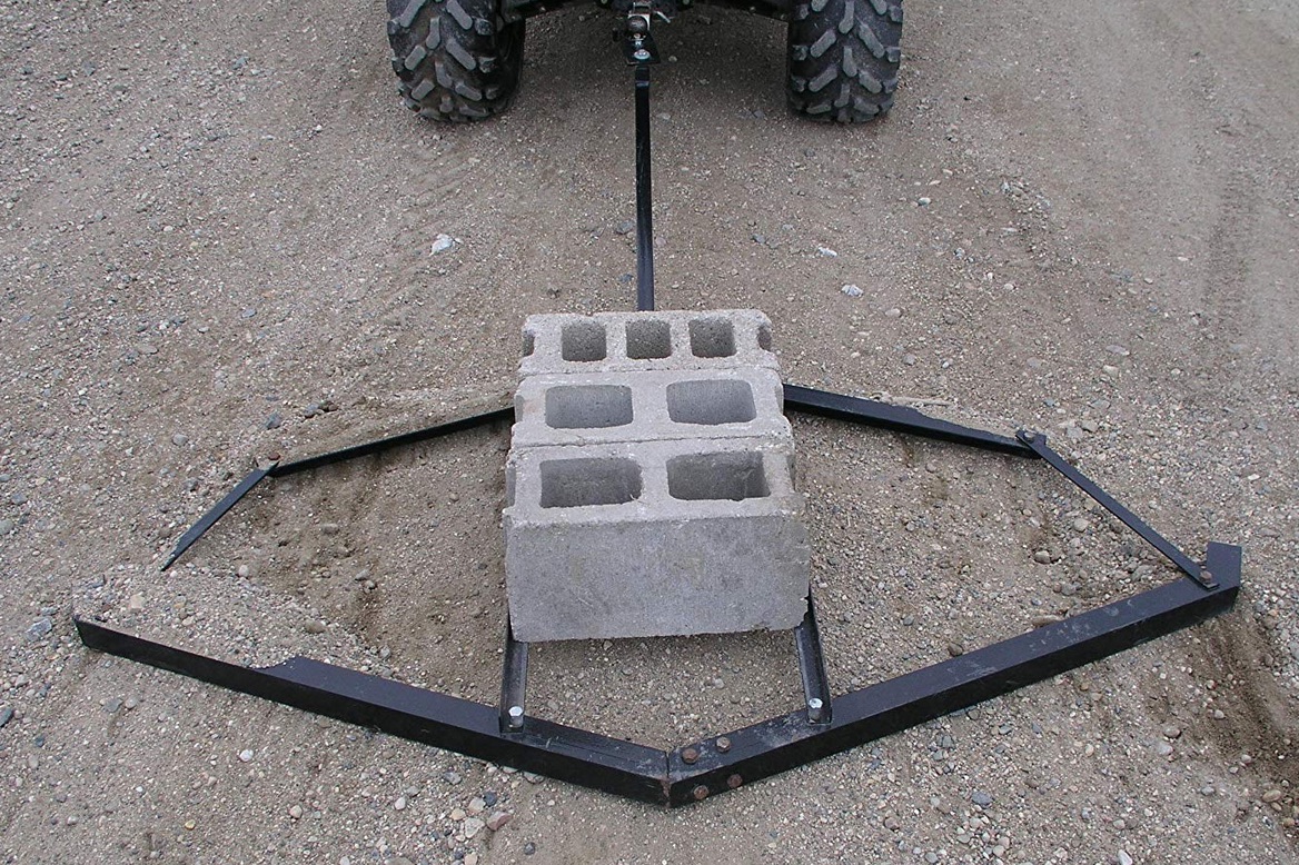

Make this style, with width and weight designed for either ATV or tractor. It should cut the center hump and pull in side material.

That looks simple and effective, gonna have to make me one of those...
