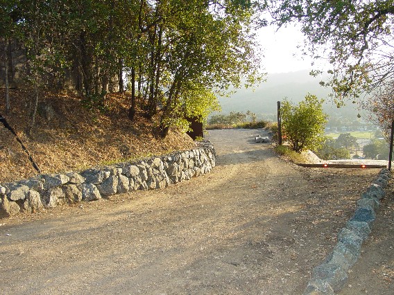

Good point Mark. If you're lucky you'll hit the rock wall, maybe knock out a few rocks and come to a stop. If you're un-lucky you'll go over the shear drop off on the right. The single row of rocks on the right is supposed to prevent that from happening.
Actually this is the beginning of my neighbor's property. The rock wall straddles the property line with about 75% being on my side. I paid about $500 for the rock (almost half of that was delivery). The neighbors offered to pay their share but I told them "forget about it", the additional seat-time was payment enough. :) We're both pretty happy with how it turned out. It's prevented the hillside from washing out and covering the driveway in mud for six years now.

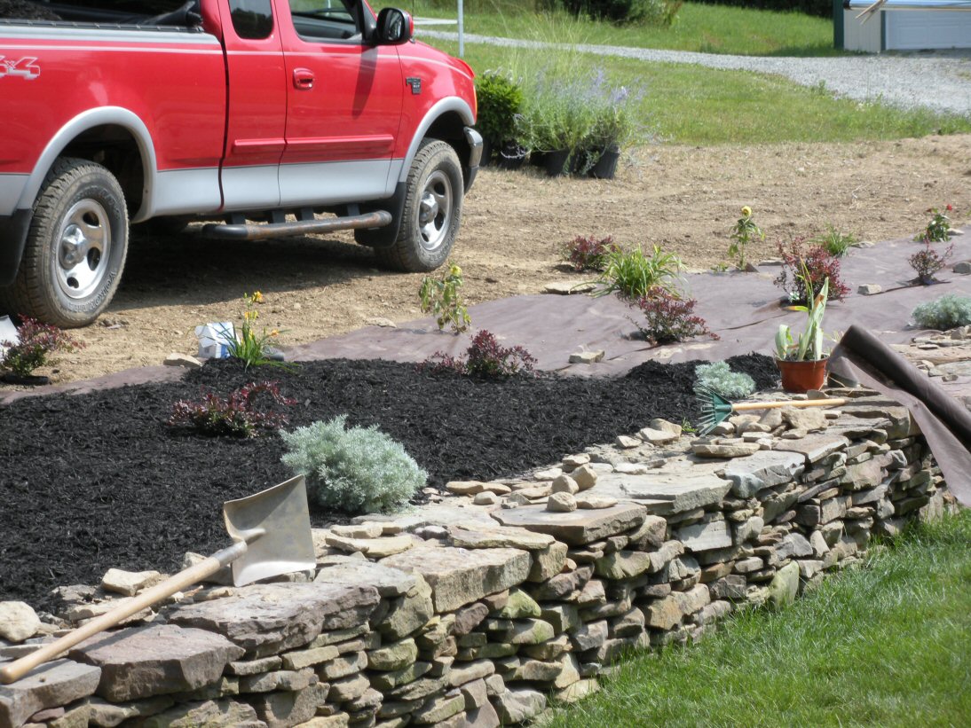

Builder, You leave out a lot of information, such as location, which has a lot of bearing... the wall's purpose, soil type, frost, freeze, heaving, rains, etc. I've built a number of stone walls, which have included some small boulders as well. Water will move "through" a stone/boulder wall, until it turns to ice, which will move the biggest "boulder." Is the wall'
purpose to hold back soil and re-direct water drainage, or just a decorative wall. So many questions and little info. HOWEVER, I always build mine in NE PA with 2B (driveway) stone base for drainage, some 2B stone at the wall base, inside the fabric, the 2B stone behind the fabric 1/2 or slightly more of the wall height, then soil. But we need more info.
http://www.tractorbynet.com/forums/projects/58265-splitting-rock-5.html#post1515165
Plus near done now......
Customer asked me to build a simple, economical, stacked boulder wall to retain ~4' of fill dirt for a large garden. It's about 120' long. As you all know, odd shaped boulders don't stack real well. I trucked in about 15 loads of 24"-48" boulders.
I started out by skimming off a level ledge for the first courses to sit on. I doubled/tripled up on the 2 bottom courses so the next course will stack on top without falling off. Looks more like a boulder "berm" than a wall. Second/3rd course is more challenging.
Would you use fabric behind the wall to keep dirt/mud from coming through the front openings left because the walls are not perfectly sealed? I was also considering a 3" stone vertical layer behind the fabric, then folding the fabric over the top and behind the 3" stone, but cost/complexity is of concern. Can't get too carried away on perfection-it's not supposed to be a work of art, or cost like a work of art. However, don't want smaller rocks being pushed off or mud oozing through.
I'm more used to building stone/mortar or interlocking block wall with proper pipe/drainage behind it. This thing looks like it might be a problem in the future.

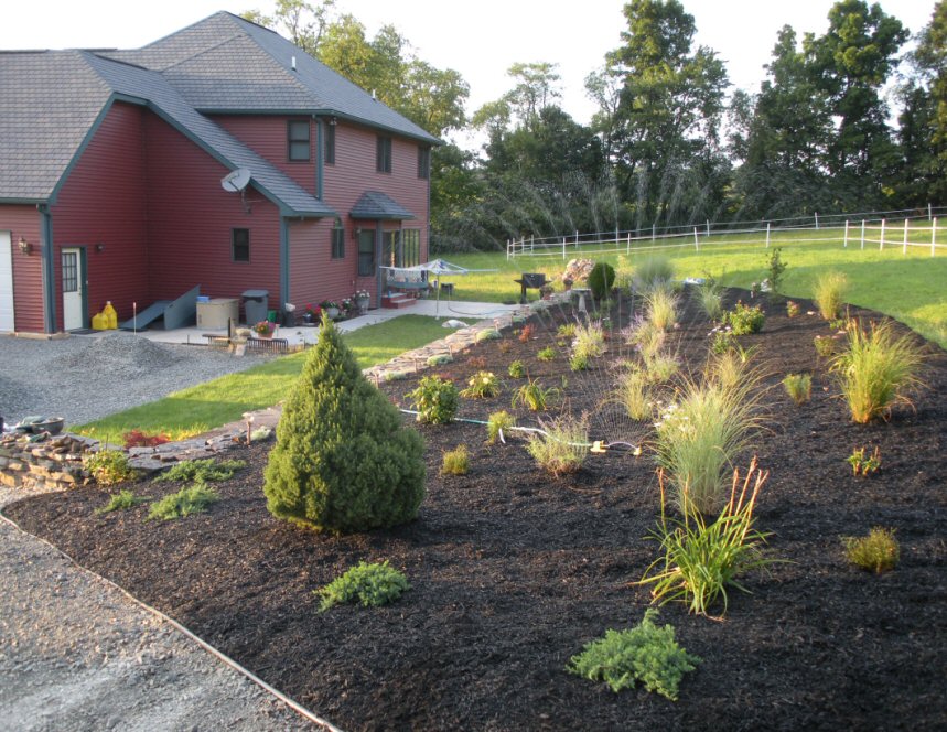

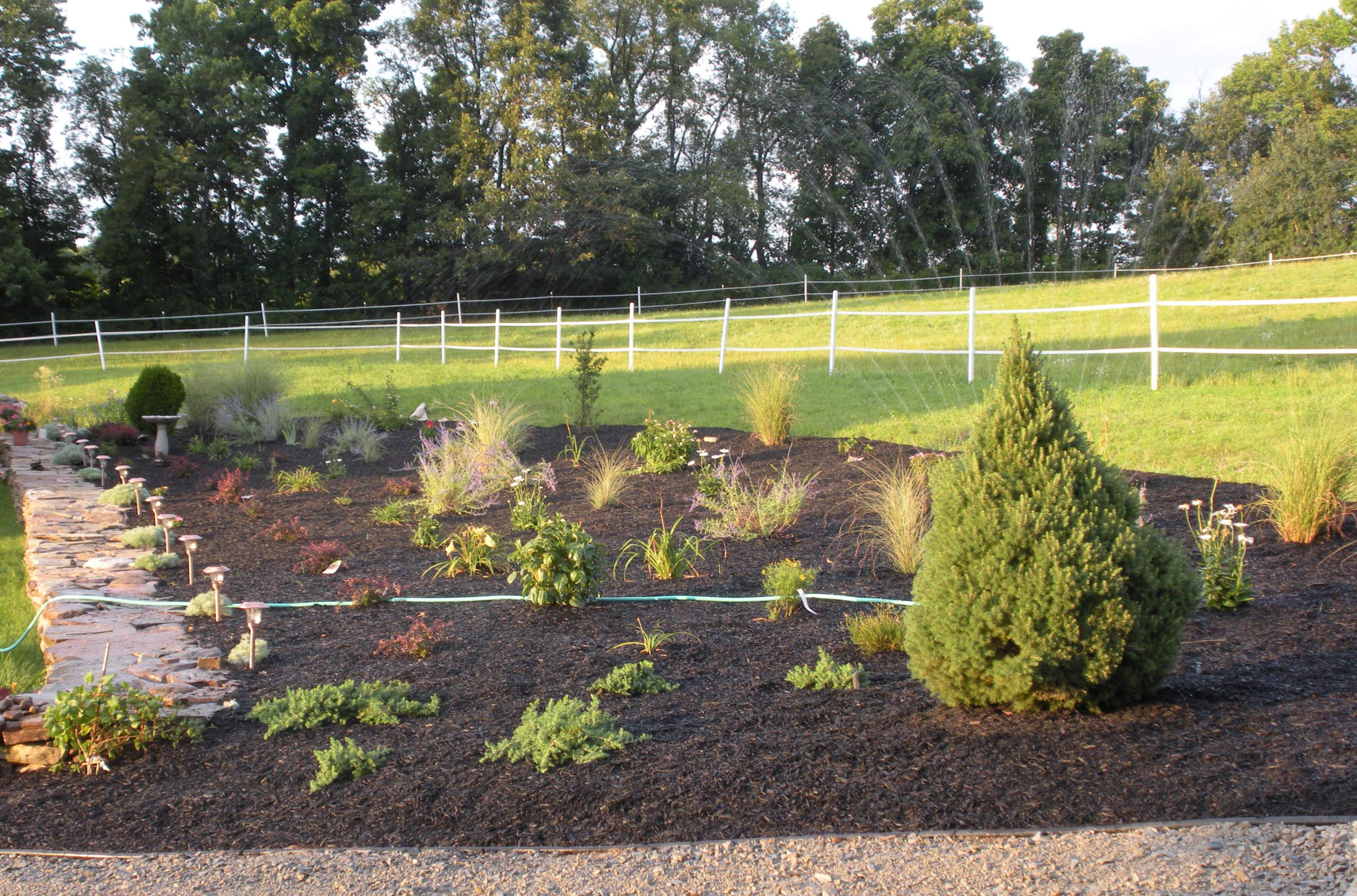

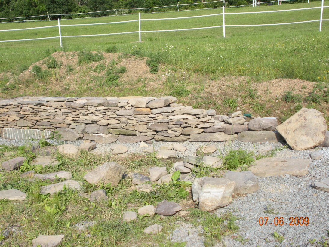

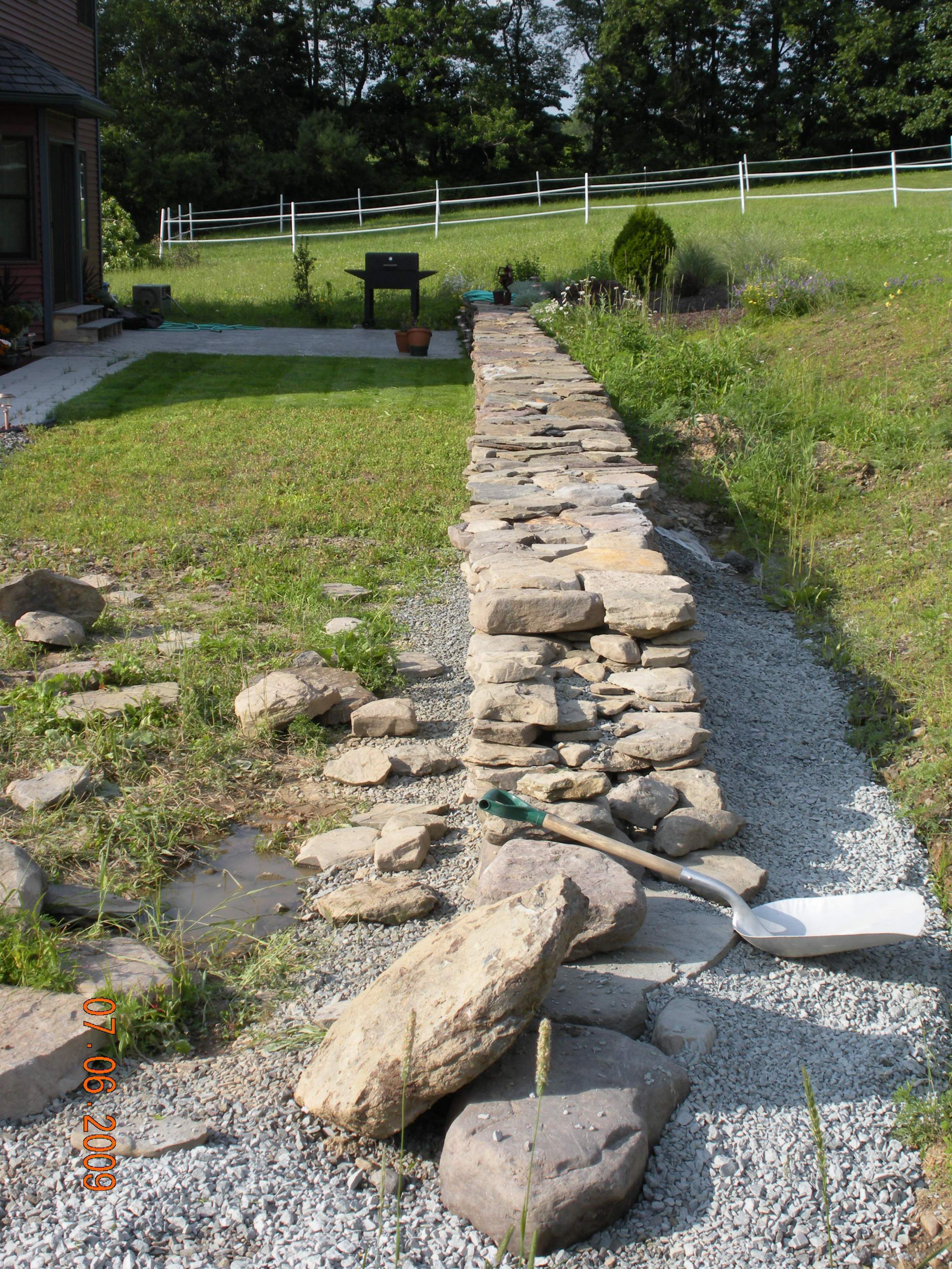

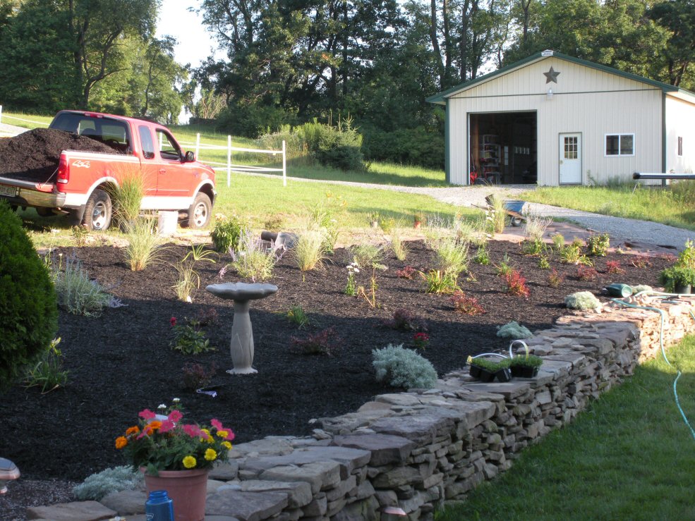

Those little flat stacked stone walls are a totally different situation. Your's are very decorative. Mine is more functional. This one I'm doing is like a boulder "berm" stacked about 4' high. I took pictures, but need to post them up when I get some more time.
