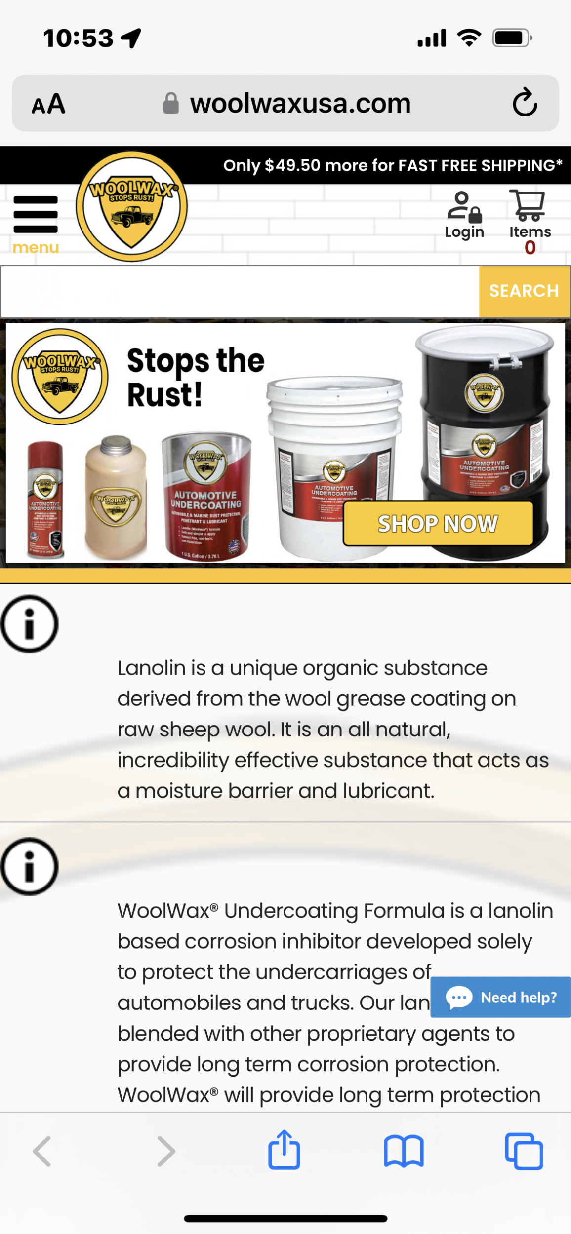

Wool wax, fluid film + dusty road have worked well but I don't drive anything that fancy.
