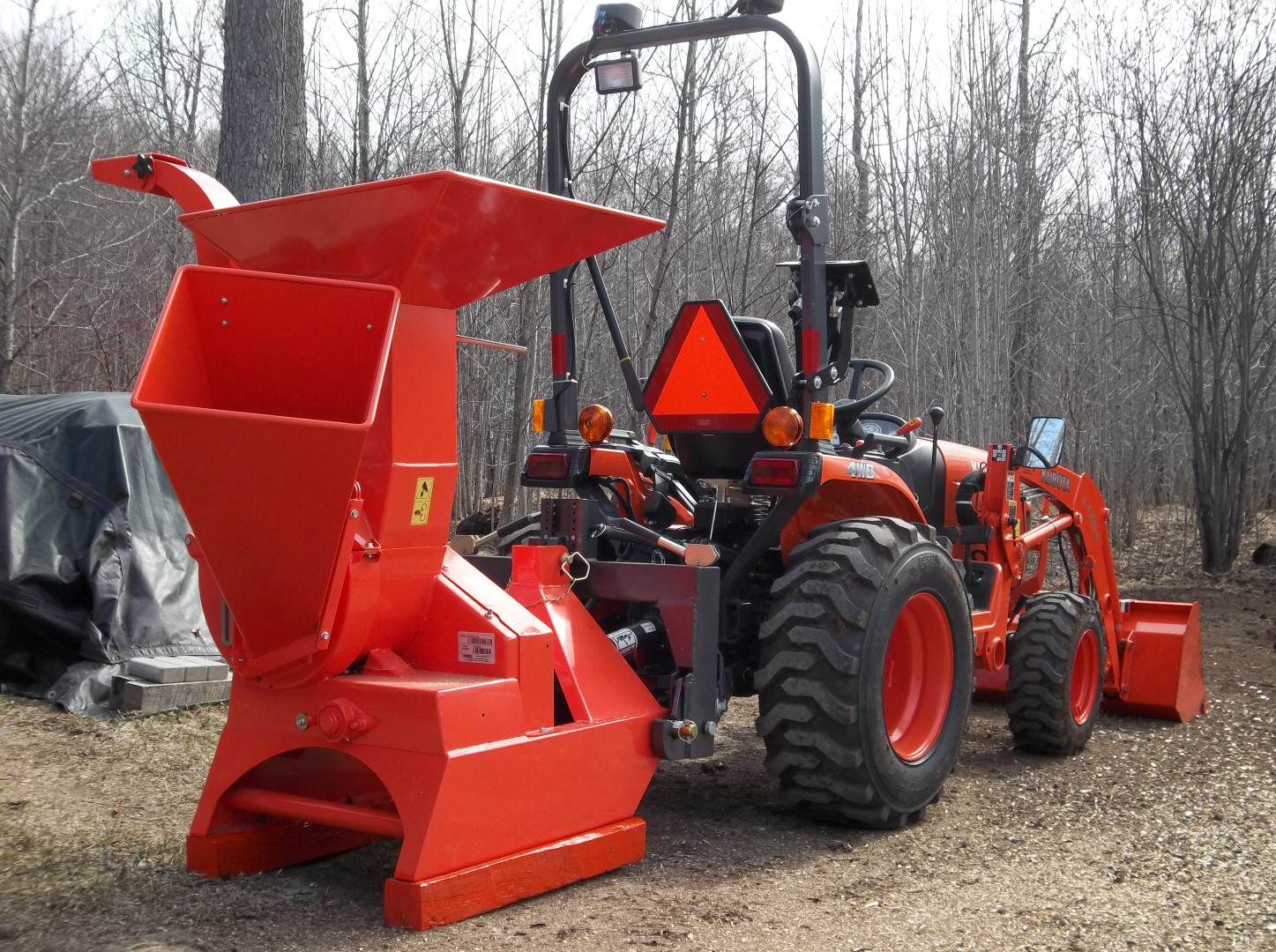

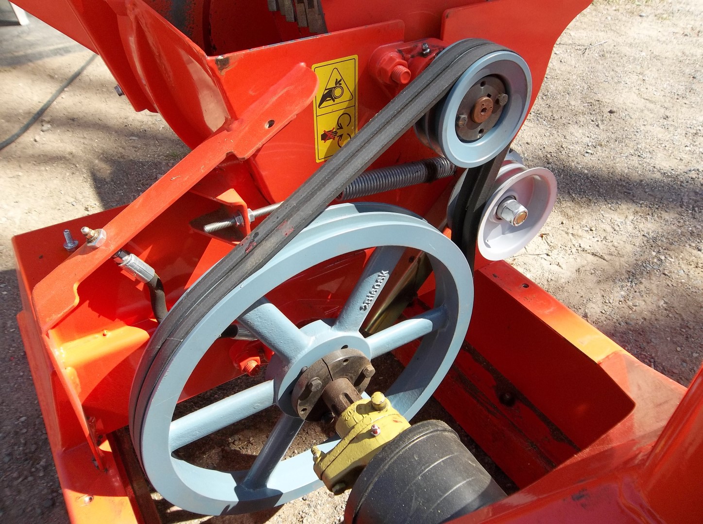

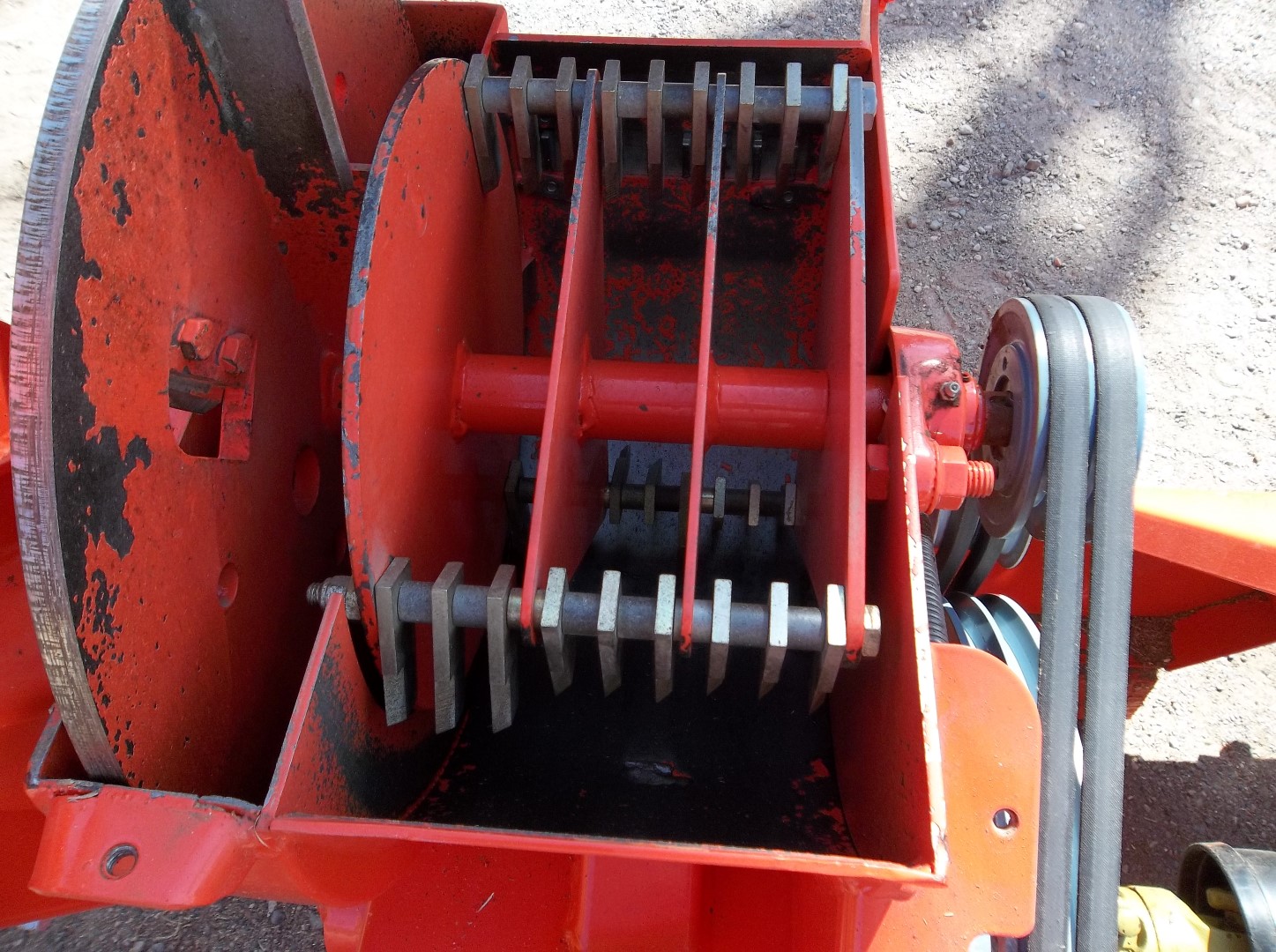

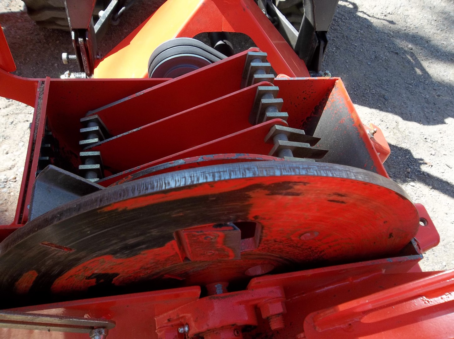

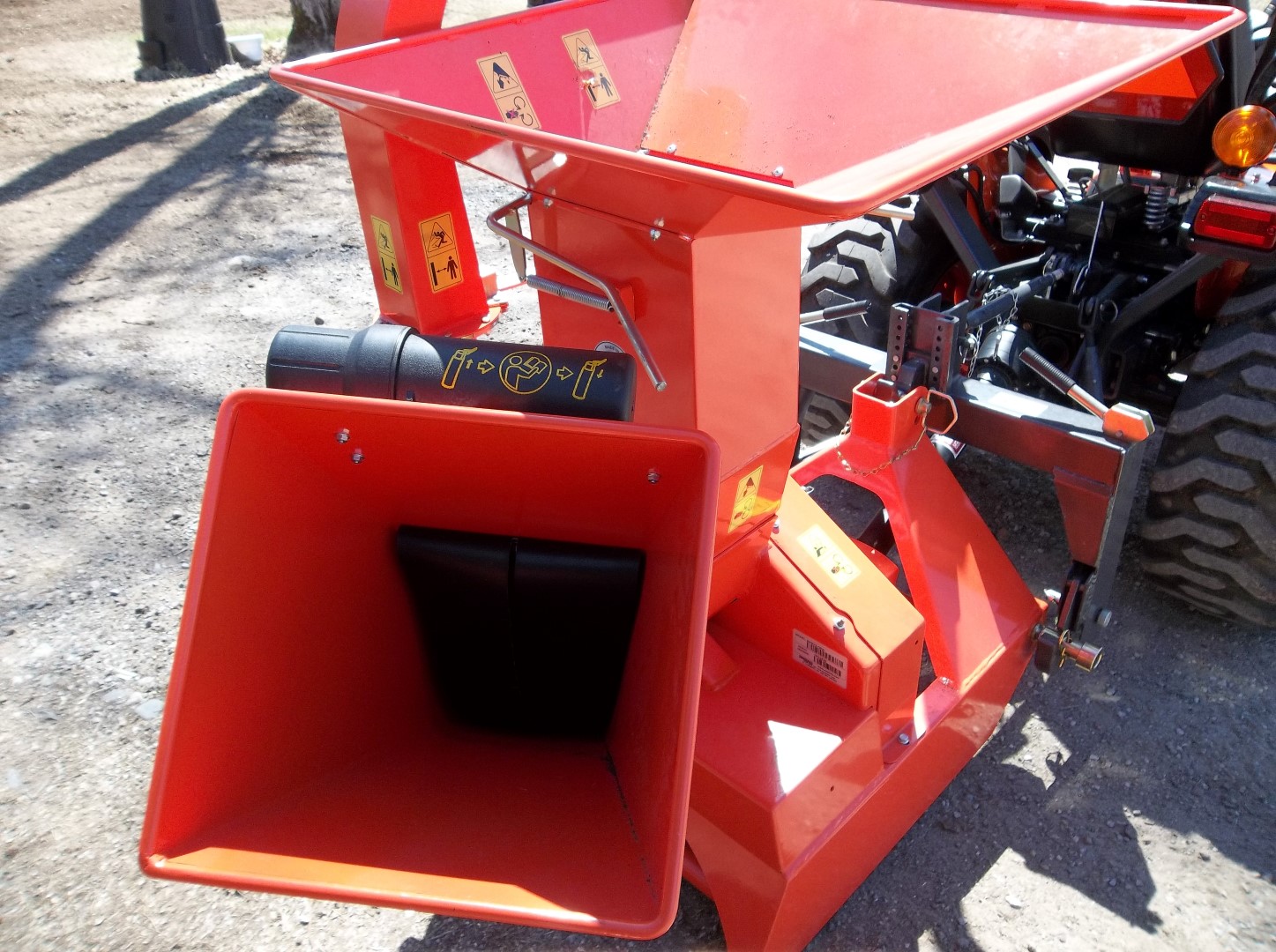

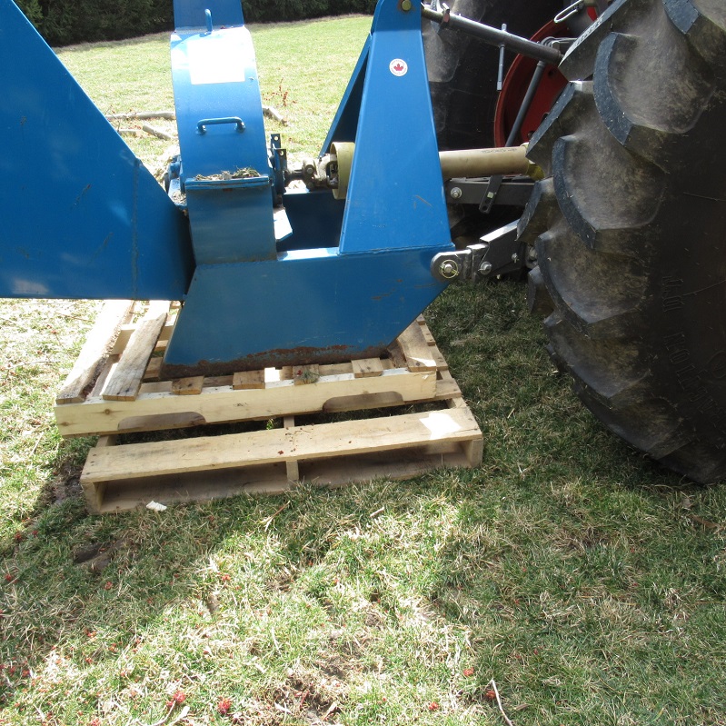

Here's some pics on an M7040 Kubota. With the bigger tires it's higher off the ground so I stuck two pallets underneath to keep the driveshaft straight when I set it down. I cut down two 30 ft soft maples today and chipped anything under 5-6". This Walenstein chipper chewed through everything and at an amazing speed. Almost no vibration either.
I've had other chippers years ago and even with self feed they sometimes plugged up. Not this one and I was surprised what I could stuff in it and how well it would feed. It folded limbs back and pulled the stock right through. No problem.
Anyway, this is one of the best tools I've ever owned.

That works but I could use the chipper on different tractors with different height lift arms. This way I can just add or subtract pallets.
