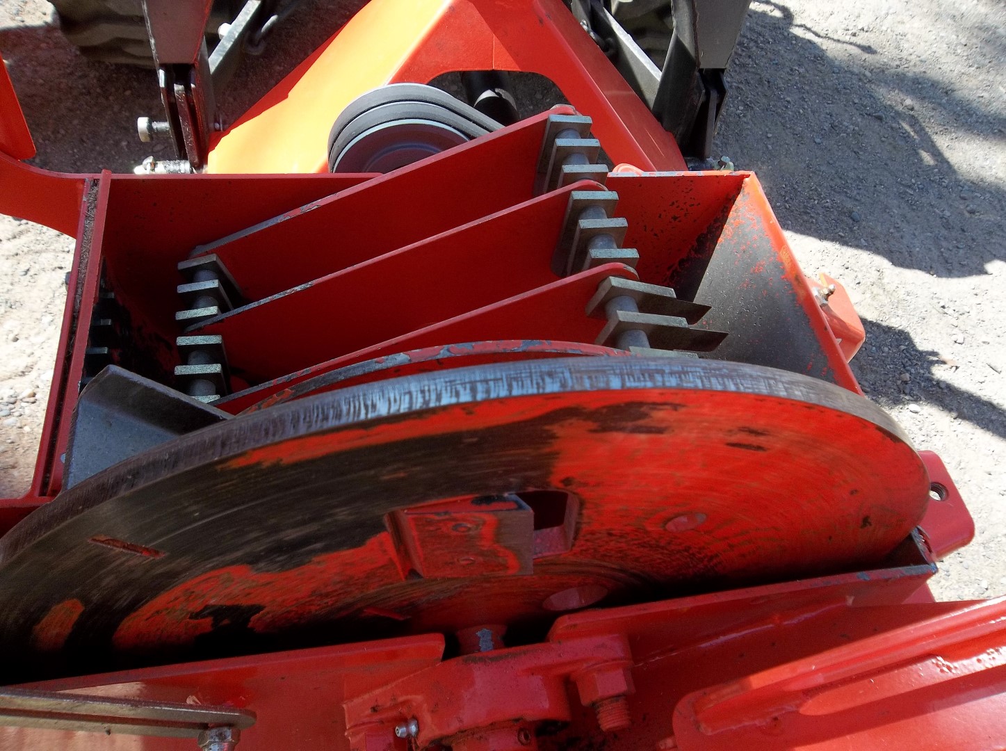

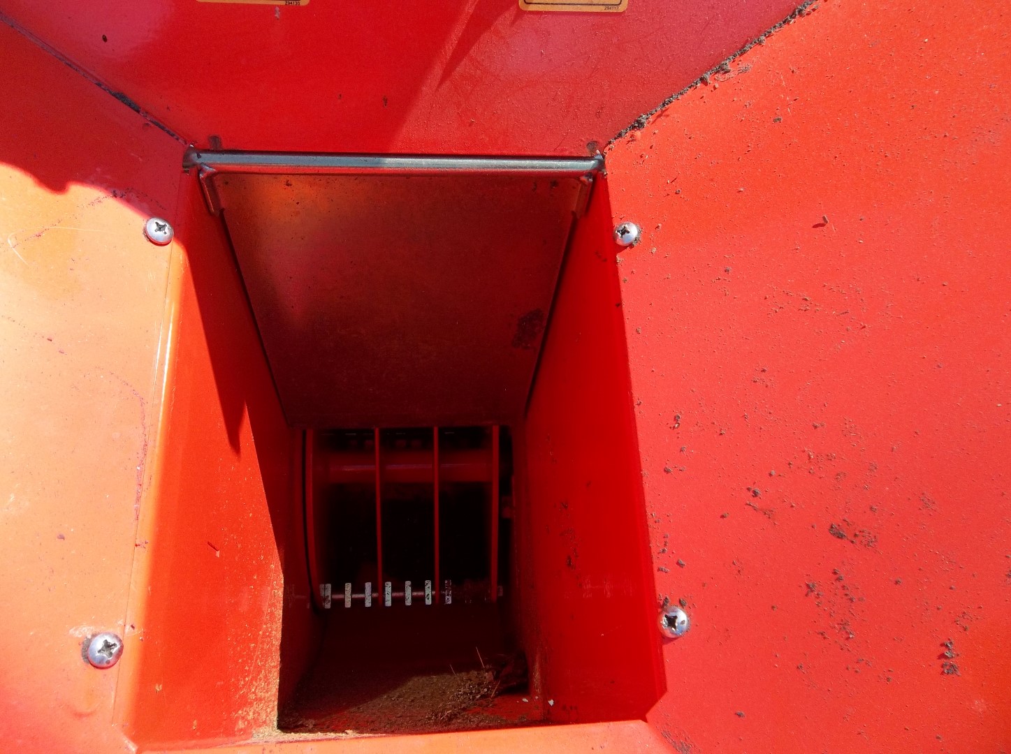

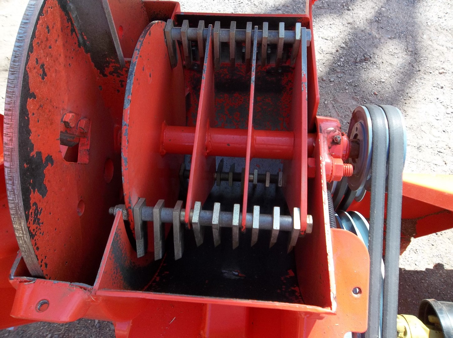

Here's a pic.
I hooked it up to my M7040 yesterday and it ran really smooth with near zero vibration. The last small chipper I had vibrated and rumbled. I didn't chip anything because I want to look inside first but I did run it to eject any water that may have gone in when I rinsed it off. I can understand why this chipper is so highly regarded. I don't have a lot of experience with chippers but I've been around a while and would say this is the best chipper I have ever seen and by wide margin. No wonder you never see them for sale.

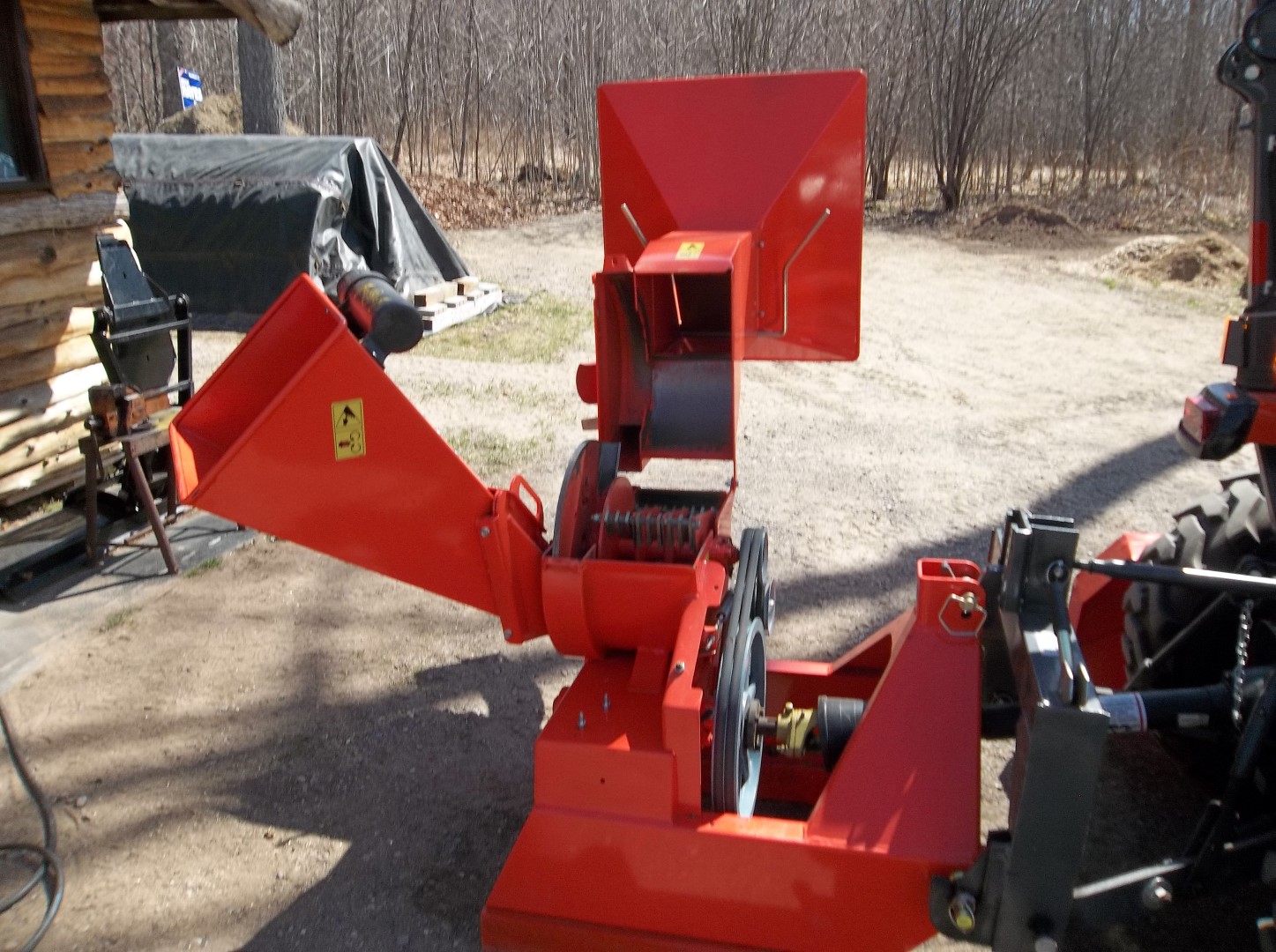

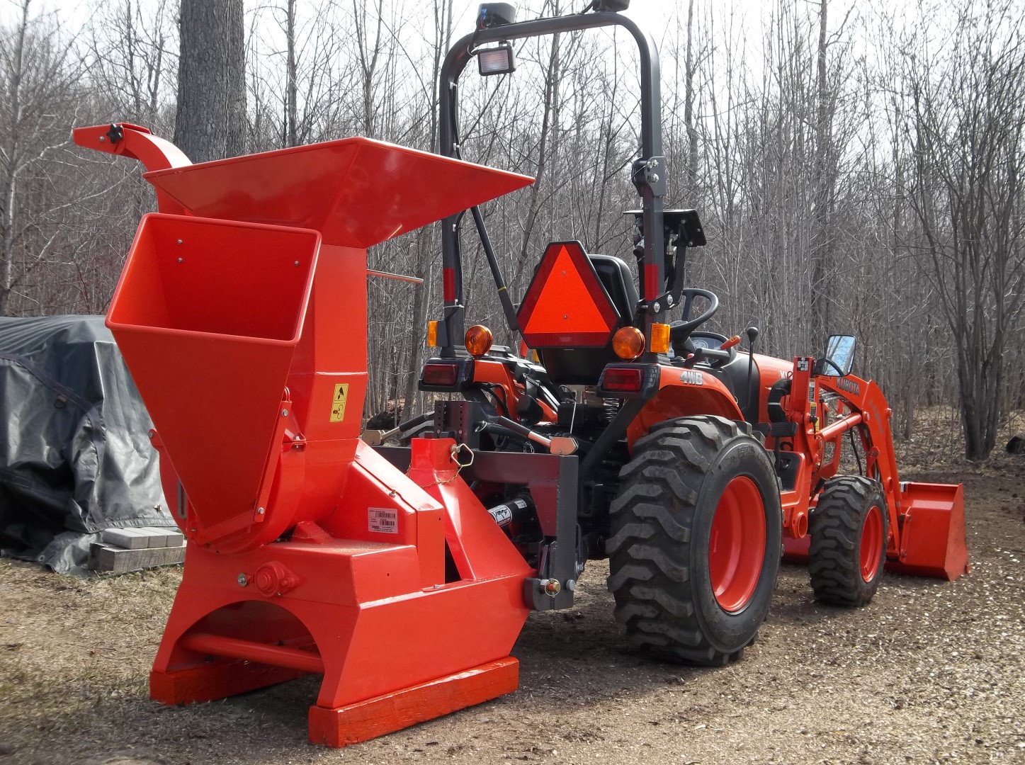

I put mine on the ground while chipping. But I also bolted some feet to it that I made from wooden blocks. This was mostly because without them it sat too low for my neighbors BX to be able to back under it with the quick hitch. You had to lift up on and tilt the chipper to get it hooked up. wasn't as bad with my B.
So I just raised it up a bit with the feet.

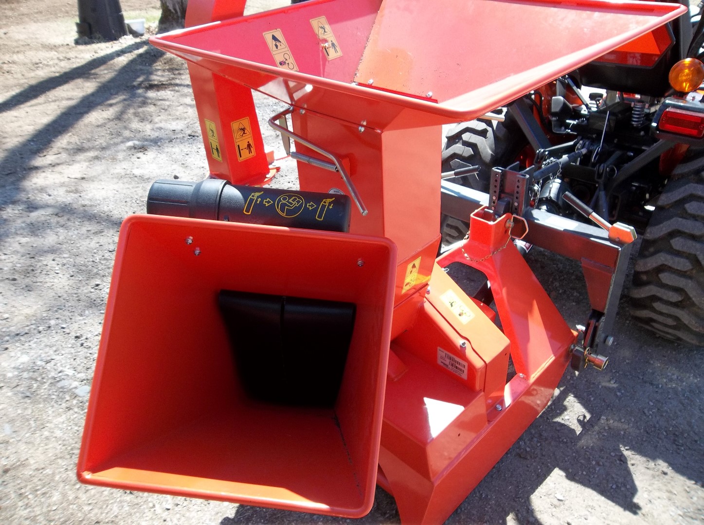

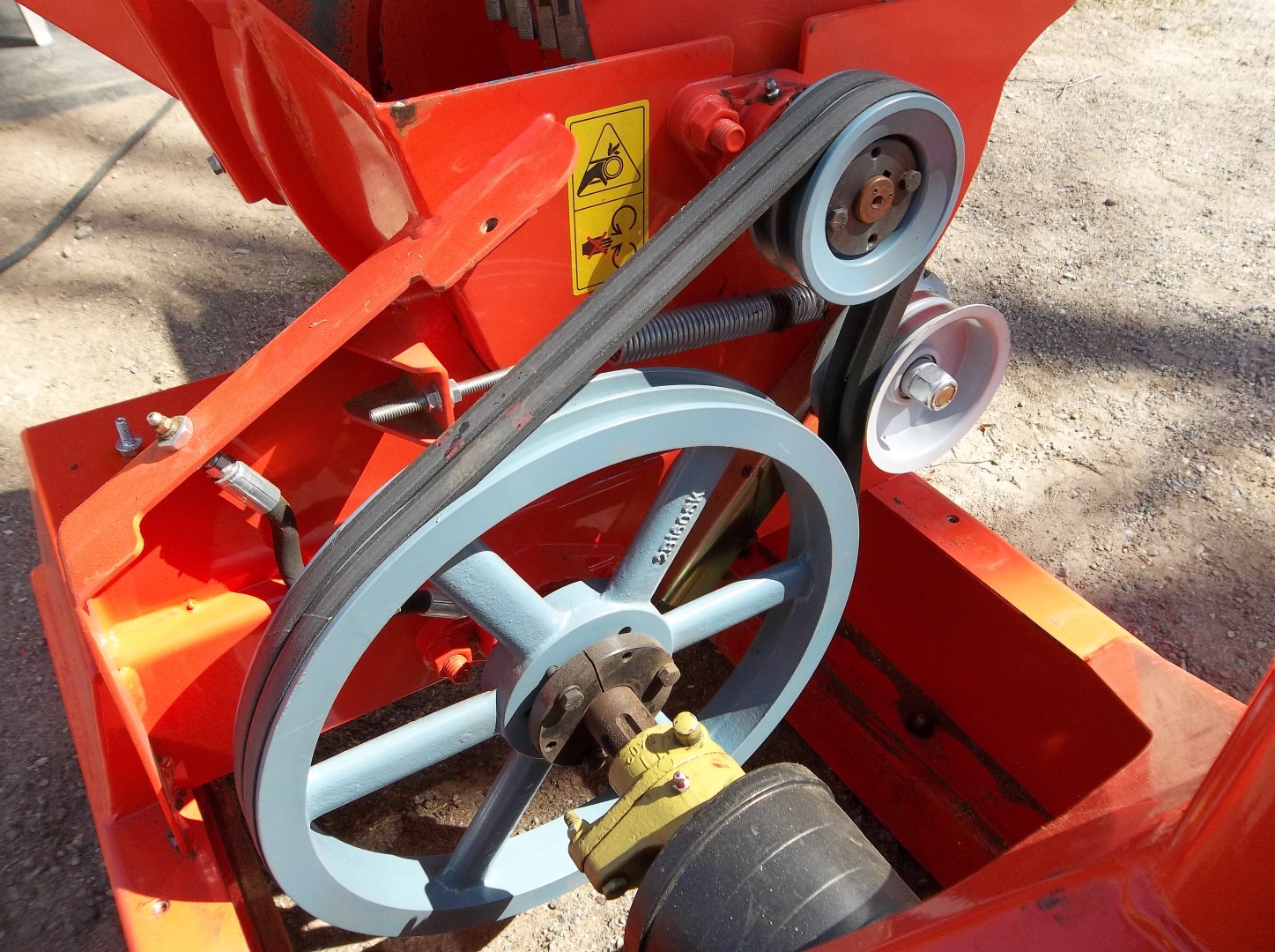

That is a great looking chipper and the feet are a great idea. What size or model is it and how does that tractor do with it?
/ Bought a Wallenstein chipper #20
Thanks. It is the model BXM32 chipper/shredder. It is rated for 3 inch through the chipper and one inch in the shredder, but I have run bigger than that through it. I have all hardwood maple here and I run anything that will fit into the feed holes and it doesn't work my 26 horsepower tractor at all.
It seems to self feed good and I haven't done anything to it yet other than greasing.
I love the shredder for doing leaves. It turns them to dust and I just blow it back over the lawns.
