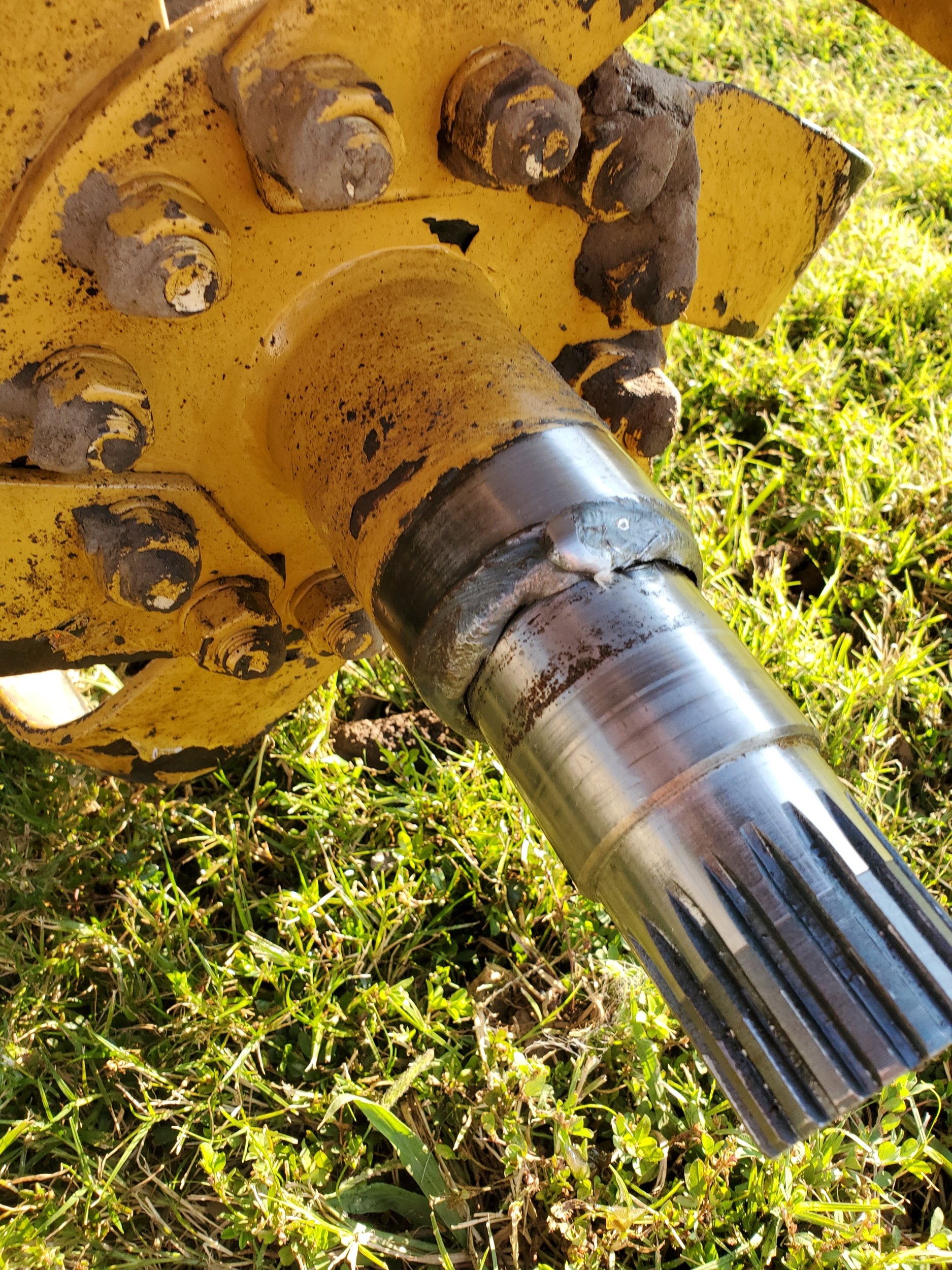

Just got this tiller yesterday and started tilling with it today and it broke. Rotor stopped turning. Tiller had about 5-6 hours on it so very little use.
After pulling it apart I find that the splined shaft that is inserted and welded to the rotor shaft broke at the weld.
Inspecting it shows the weld had almost no penetration on the splined shaft and was doomed to fail. I have a feeling this has been an issue for them.
Hoping my welder friend can fix this up and I can get back to tilling.

Looking at that weld, it is a machine weld, done with parts in a jig. The slip clutch tube slides over the toothed shaft and both are locked in place by a jig. An automated mig head then welds the joint as the jig rotates.
In this particular weld, the welder head location was slightly too far over the tube. The weld melted the tube without heating the shaft enough to bond with the weld. The error was probably 1/8 inch or less.
I wonder how many pieces they produced before their inspectors detected the problem? Apparently enough so the defective parts had gone to the factory floor and into production tillers. And they did not want to pull apart completed units to inspect the shaft and weld. Just sent them out to the customers and let them find the problem. Probably only 25% of customers have rocky soil, so 75% will never complain during the warranty claim period. That is a pretty good ratio in favor of King Kutter.
A mis set slip clutch should never be able to cause a failure like that. If that joint could fail with a slip clutch set too stiff, it should be redesigned. However, it did act as a type of shear pin for you. What would have broken if the weld had not failed? Make sure your slip clutch works.

Yea, my friend is a professional welder with decades of experience (oil & gas sector mainly) and he wasn't surprised by the crap weld. His friend who is a weld inspector was at the shop and said he was surprised it lasted that long (6 hours or so)!
We got it back together best we could but the weld will never break! We do have a slight wobble on the gear but it runs fine. Despite getting the shaft true the weld eventually pulled it slightly. I don't think it will bother anything and the fix was free!

Splined part is welded into the main rotor tube. Just a poor weld they let go.

I didn't hit anything with it. A few bumps and bangs like you'd expect in hard soil but that was all and it stopped working about 30 minutes after I started using it.
Previous owner said he hit a little sandstone but said it barely even "flinched".
I am glad I only had to fix the tiller and not the tractor.
Slip clutch was in good condition but has been completely dismantled, cleaned, reassembled and tested. Running just slightly loose. Hit some roots after repair and I could see the tiller blades slow for a second so it is good I think. I can replace clutch discs!
