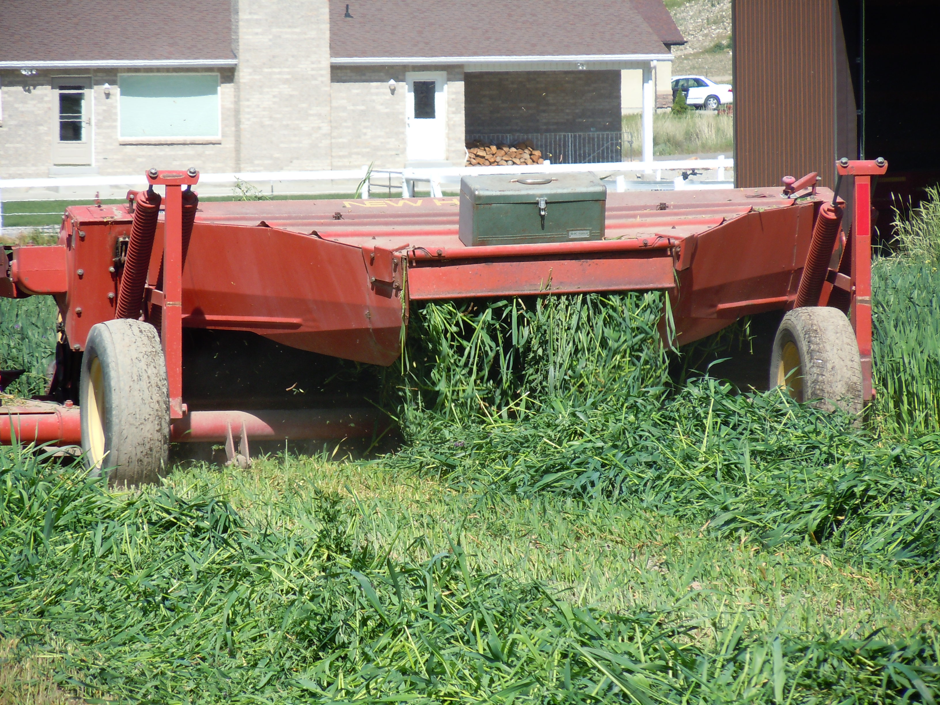

Looks like a good purchase;
I bought a NH 488 9' cut a couple years ago. I replaced all the guards and any knife that looked worn at all. Adjusted the chains and belts and it works great. Looks old and worn but it cuts great. Think I paid 1600 for mine. I even got the owners manual with it.DSCN2529.JPGDSCN2520.JPG
