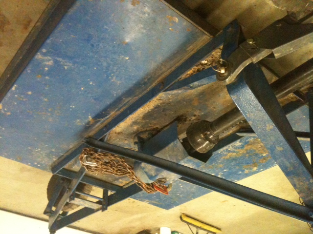

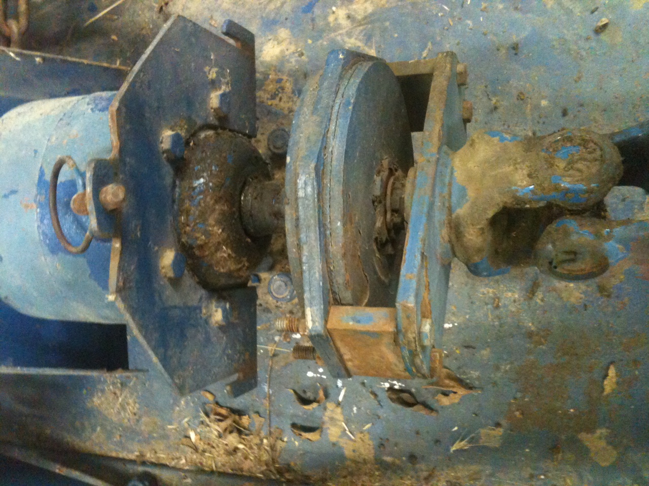

Hello, I am new to the site and have a question.
I just acquired an old Rotary Cutter. What do I need to do to maintain it and use it safely?
I am mainly concerned if this is a slip clutch or a shear pin set up?
Anyone know the brand/model? photo (1).JPGphoto.JPG
Thank you for your help, Bruce

Welcome to TBN. Might be a Ford, can you post pic of overall unit. Looks to be in good shape.

Looks to be a Ford. Father in law has the same one. Check U joints and anything that moves. Check often until you get some operating history with it.

Welcome to TBN orangebruce:)
Does look like an old ford cutter. Check oil in the gear box, grease the u-joints. Make sure nothing is loose, cracked and fastened securely. Blades should move freely but securely bolted down.

Looks like my Ford....shoot me a PM if you want the manual, in one of my posts I link a site you can download the PDF file.
/ Bought a blue used 5ft cutter #8
yep.. looks like a 951
you c an get the manual from the nclub
grease and check u joints. service slip clutch if available. dress blades/check for cracks, check input and output shafts.. drian gearbox, rinse with diesel.. fill with 85-140 gear oil.. service tail wheel spindle.. clean up.. re-grease.. check tailwheel hub seals and bushings.. servige or grease as needed.
check pins and bolts.. weld fix cracks.. wire brush.. shoot some paint on it.. use it another 20 years.. :)

just like mine except in better condtion...
the big nut on the back of the slip clutch i what you use to adjust it. if you ever get it broke loose, you may have a hard time getting it tightened back up satisfactorily.
do you have a stump hopper on yours or just a twin flat bar the cutters are mounted to?

Thanks all, Looks like I have a stump jumper on it. I will try to find the manual now and determine how to service the slip clutch. How do you tell if the slip clucth is fuctional? How do you loosen that big star nut? I see the hex head srew to hold it but don't have something bid enought to lossen it.

Usually you would need a Shop hammer, punch and safety glasses to remove the nut on the clutch. Make sure it does not have a set screw that you need to loosen? Ken Sweet

How do you tell if the slip clucth is fuctional? How do you loosen that big star nut?.
generally if its not slipping on you in rough use, its bound up and likely not functional. I loosened mine with a chain strap pipe wrench and 6' cheeter bar with my "spud bar" stuck in the hole on the top of the deck to keep the blade from spinning.
