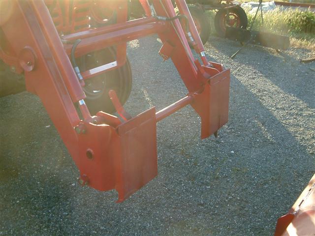

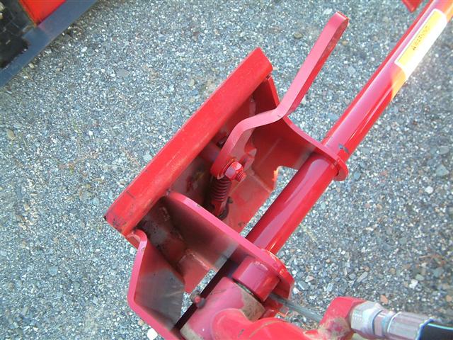

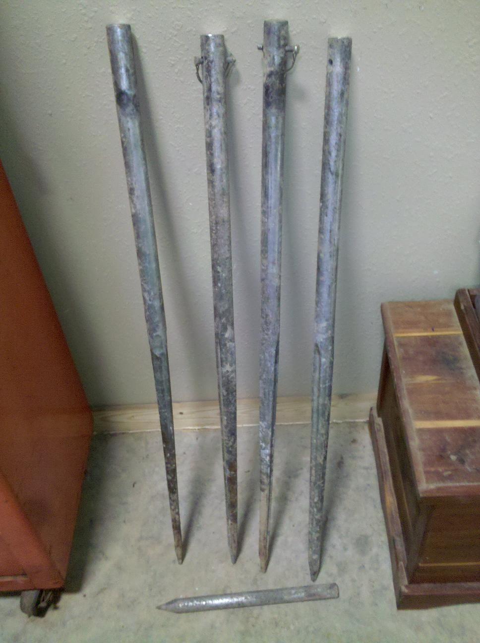

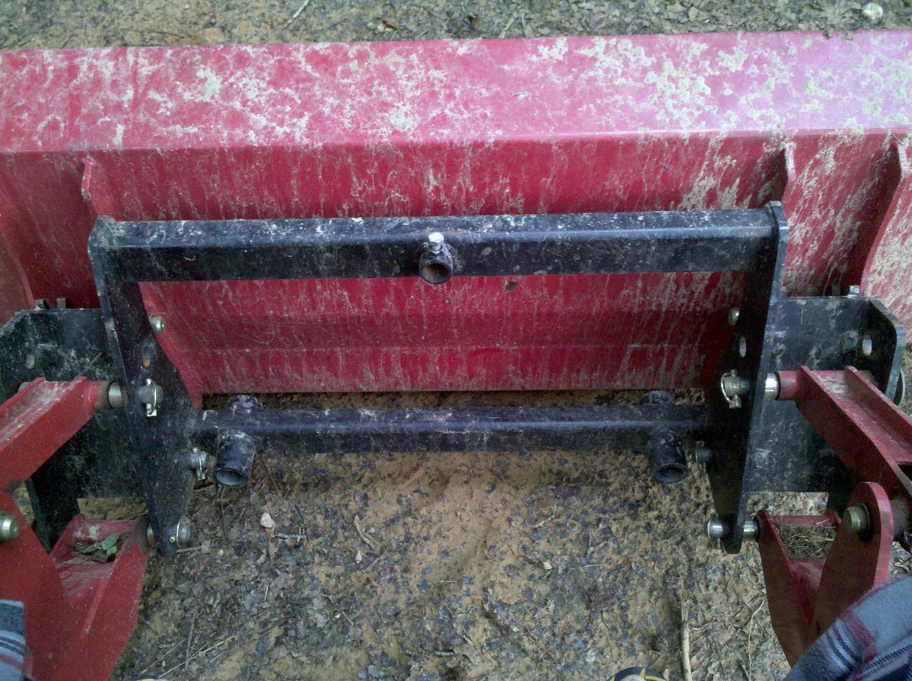

Flusher - Thanks for posting all of those pics, my pin on attach/detach is definately not like yours. :drool: Mine also has holes for hay spears. The guy also gave me the hay spears... I really don't need them. :confused: Maybe I'll talk to a dealer and see if they can give me some credit towards the SS quick attach, that is if mine is not skid steer compatible.
How would I go about finding if mine is SS compatible? I've attached some pictures I took earlier. Maybe someone knows what I have and can tell me that it is very valuable! :D

Check out what you can see in MtnViews photo and mine linked below.
ML 275 SK #1 - TractorByNet.com Photo Gallery
Yours is not skid steer compatible.
larry

Rusty, your QA is made by Ottawa. It is the same one as on my 4500. Bet your loader is a Great Bend.
/ Bought a 7520 #26
I dont know ... The loader shown in his picture is exactly like mine. A ML-275. Made by KMW as near as I no. Id check with Rback33 for compatiable SK attach parts. Mine has been rugged and trouble free .

Unfortunately, that configuration you have on the FEL is NOT skid steer compatible. Skid steer attachments have to meet industry standard dimensions and configuration like you see in the photos I posted earlier in this thread in order to be compatible with the large world of skid steer attachments that are available. I don't know what that thing is on the end of your FEL arms.
/ Bought a 7520 #28
The device on the FEL arms is a Quick Attach Adapter- Pin On. This link shows the one for the 15 series.http://www.mahindrausa.com/attachmentDetails.php?p_ID=98 You have to click on the attachments link. Mahindra didn't show the Quick Attack Adapter, pin-on style for the 7520, but I'm fairly certain this is what it is. It is compatible with the loader bucket, bale spear, and fork lift attachments.
