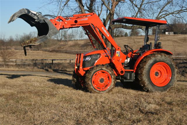

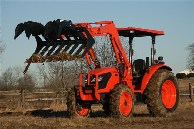

Well, I finally got my grapple rake installed a week ago and just recently got the hydraulic hoses to the 3rd function valve configured the way I want them. Some of you have asked me to post some pictures. So here they are. On one of the other threads I had stated that now that the grapple is on my tractor looks like some sort of prehistoric beast. I believe "Botasaurus" had already been used in the past several years ago so I chose "Botazilla" as a nickname when the grapple is on.

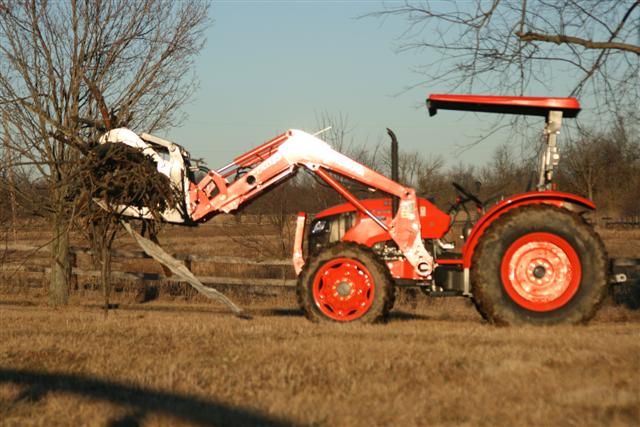

Here's a couple of pics of Botazilla "eating" some brush.

/ Botazilla is Born!! #3
Looks like Botazilla is a hungry monster. You better make sure you keep it well fed.
/ Botazilla is Born!! #5
That machine looks awesome and I can only imagine it performs the same way...Good job...........
/ Botazilla is Born!! #7
I got some fence rows you could feed that beast :D
/ Botazilla is Born!! #8
Nice Job.....

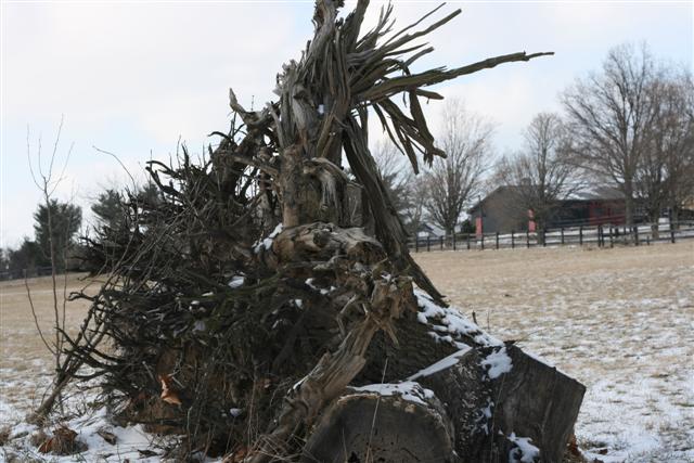

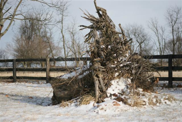

Thanks guys. I'll have to post some pictures when I decide to feed this big overturned tree stump to Botazilla. Of course, I'll have to cut it into bite-sized pieces with the good ol' Stihl first.

/ Botazilla is Born!! #11
Wow..that's one fine beast you have there Glowplug! I am so envious but I can't start rationalizing why I need to upgrade my B7800
/ Botazilla is Born!! #12
That's cheating. You have to at least try to lift that stump intact.:D
/ Botazilla is Born!! #13
Why upgrade the B7800? You can put a grapple on that easily and do 90% of what Glowplug can do (with a few more trips).
#14
Okay. I'll give it a shot. That WOULD be impressive if I could lift that whole thing. That would make for some nice pictures.

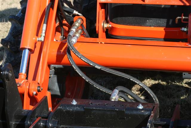

I know I have read numerous threads that you have posted to but what grapple did you settle on? Also what tractor and loader model do you have? Can you post a pic or two of the controls for the grapple? You added a valve so there is an additional control lever somewhere. I am curious how easy it is to work the loader and grapple controls as you position the grapple for a bite.

I got the Markham Welding HD-66. It weighs 806#. They DO have a light-duty model that is much lighter. But it is not on the website. You'd have to call or email.
My tractor is a Kubota M7040HD 4WD. Loader is LA1153.
For controlling the grapple I actually have the optional 3rd function valve. It is an electronically controlled optional valve for that loader. It is enabled by pushing a little button on the joystick. Then it is controlled by pushing two buttons on the side of the joystick with your thumb. I have it set up so that the top button opens the jaws and the bottom button closes the jaws. With that optional 3rd function valve the hydraulic couplers are mounted on the front cross-bar on the loader. All I had to do was plug in the hoses. I didn't like the hoses that came with it so I got different ones. They were a little too long for my set-up. With a set-up like this I can literally do 3 functions at once. After dumping a load I have been able to lower the loader, curl the bucket, and close the jaws simultaneously. Problem is, though it is very slow. There is just not enough hydraulic flow to do it that way realistically. So it's not really necessary to set it up that way. Easiest would probably be to just run from the rear remotes. You can also get a diverter valve.
I've posted some pictures of all this so that hopefully it makes some sense.
