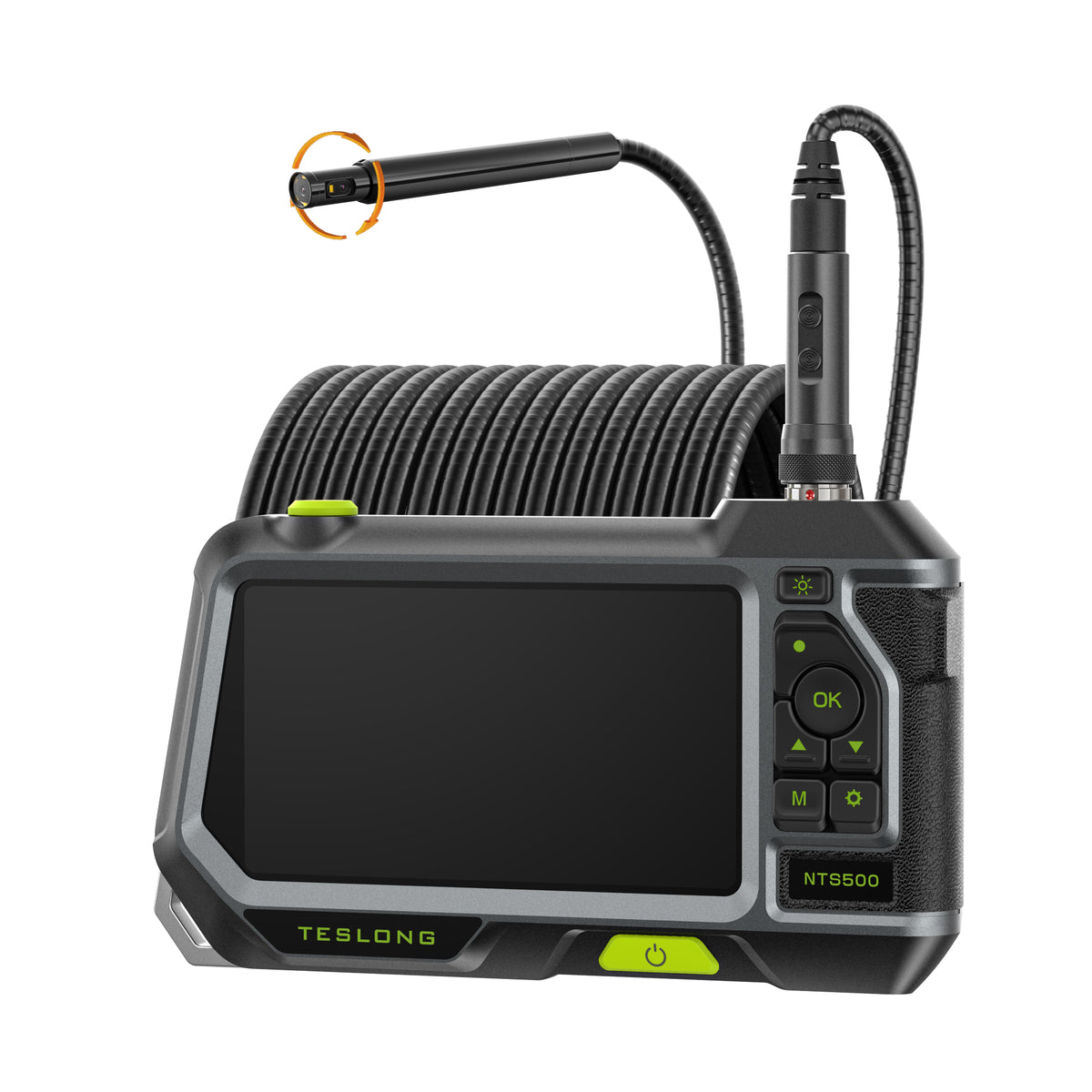

I bought a Teslong articulating borescope from Amazon a while back. They have a couple of different sizes/versions depending on your use. I've used mine to inspect engine bores and valves by going through the spark plug hole. Works great and is cheap to boot for what you are getting.

I have an older Teslong that has since been replaced by the articulated models. It’s well made for the price, has been very useful and I would buy another Teslong.
