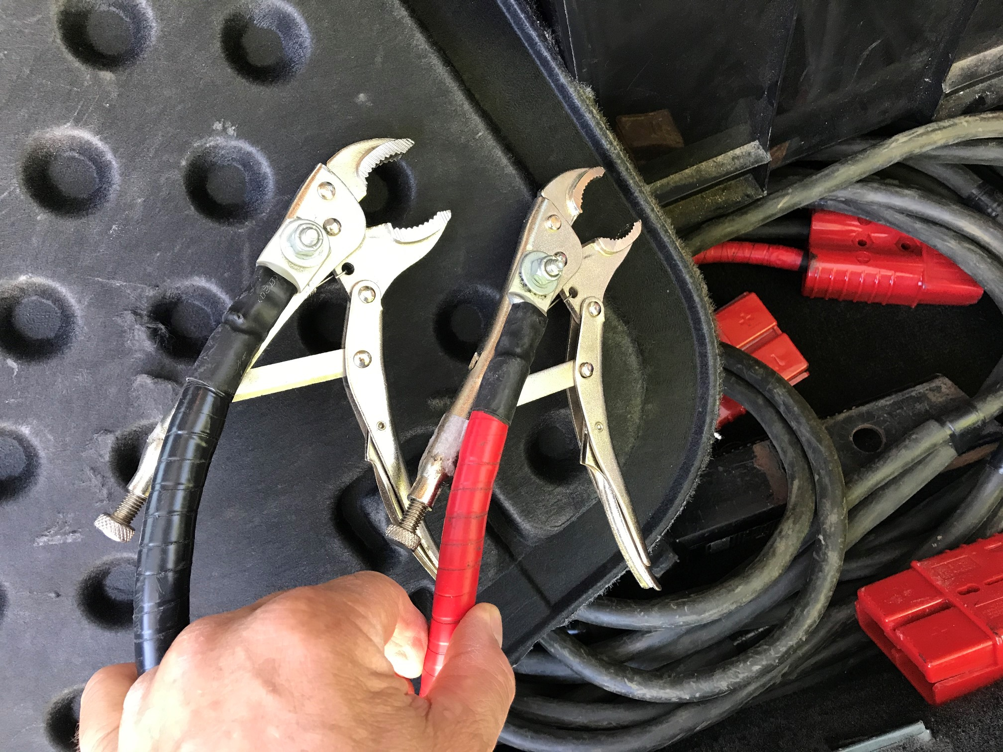

As mentioned, size and good contact matter with jumper cables. Some of the so-called "emergency kits" had wire as small as 10 gauge and clamps about as powerful as clothespins. The approach for powering my receiver mount winch addressed two things. First of all, it needed to get a lot of amps whether it was on the front of the tractor or either end of the Trailblazer. Second, my jumpers needed an upgrade.
Fortunately, this was before I retired, and there was some old 2/0 welding cable available where I worked. The tractor, Trailblazer and winches all have 350A Anderson style plugs permanently connected. I made up a 25' jumper with Anderson plugs on each end. Then the last item was a short 5' jumper with an Anderson plug on one end and Visegrips on the other.
If I can get the front of the Trailblazer near the front of the vehicle that needs jumped, the permanently-mounted cable on the Trailblazer plus the plug x Visegrip jumper are long enough to reach. So far there have been two times when it was handier to pull up behind the dead vehicle and use the long jumpers.

I like that idea using visegrips as jumper cables. clever idea!
/ Boosting question. #52
These are the second version of Visegrips. The first was a set with Visegrips on all four ends that used a double nut to hold the cable lug on the adjusting screw. While they held just as well, adjusting the jaw width was a pain. With the cable lug tight on the adjusting screw the whole Visegrip had to be spun to set the jaw width. On the more recent set, one of the rivets was removed so the lug could be fastened via a through bolt. That left the adjusting screw unmolested.
