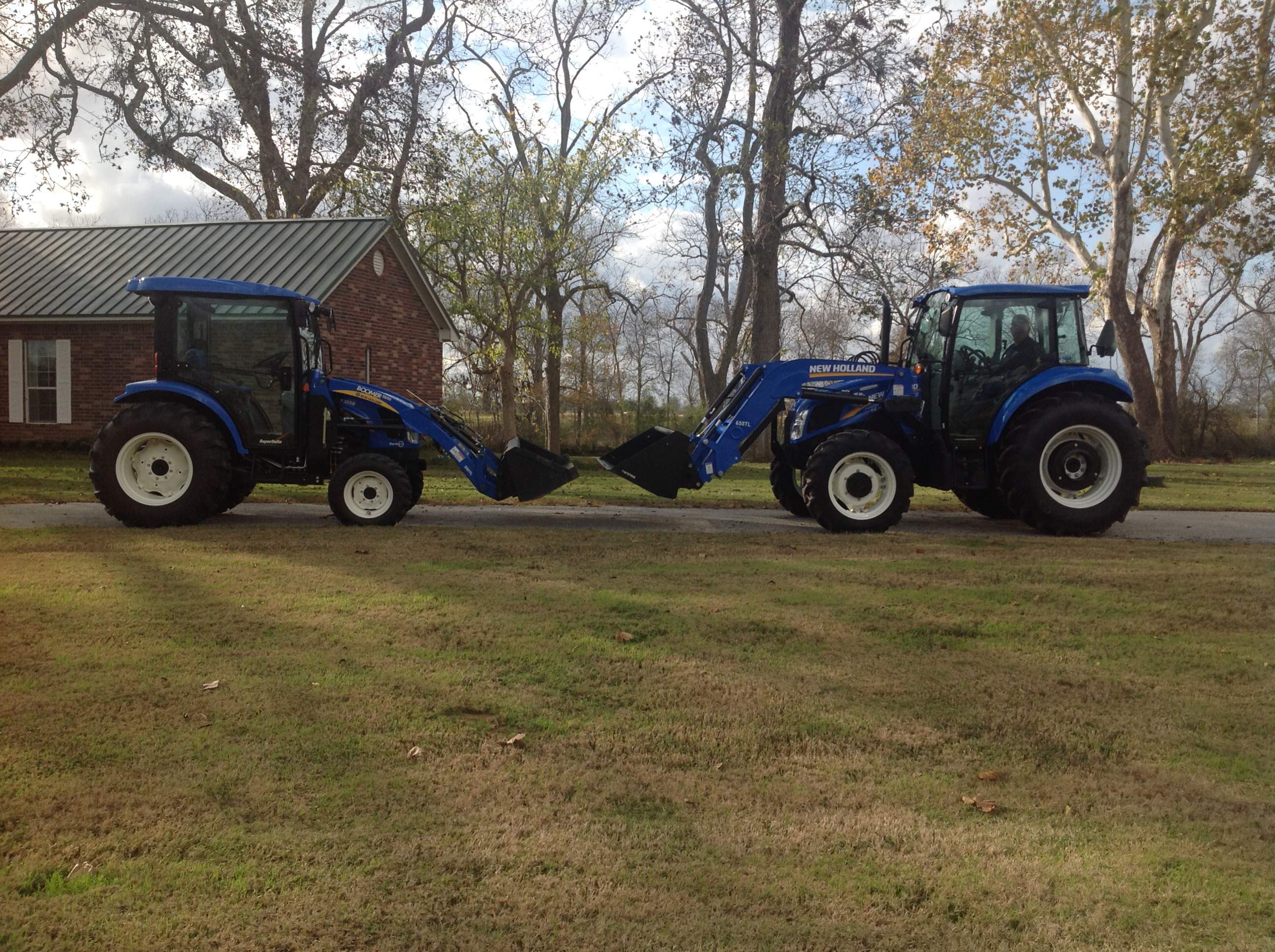

I have to agree that the Boomer 3050 has a lot of undesirable qualities and I traded in my 2013 Model after a year and upgraded to the NH T4.75 due to safety reasons. There are too many computer controlled electronics on the Boomer 3050 that try to over ride the operator and I hated having to use a toggle button to speed up and slow down the cruise control on every turn while mowing my orchard. Unlike the Boomer, the T 4.75 has a fuel tank below the door that holds triple the volume of diesel, a manual cruise control lever right near one's right hand instead of electronic cruise control and a free wheeling PTO a you can turn by hand when the engine is off.
Back to the safety concerns on the Boomer 3050. During one instance I had a 800 pound+ Tree limb being lowered after cut from a Pecan tree 8 feet above the ground and the tractor decides to go into " safe mode", puts itself into neutral and no gear movement works until the tractor is shut off, restarted, and the computer re-booted. I was at my wits end for a few seconds trying to figure out what was going on and the safe mode is not even mentioned in the manual.
On a second occasion I was moving brush near a 15 foot embankment where there is 20 feet deep water below. With a load of brush in the hydraulic clamps the slope of the land started the tractor to creep backwards toward the drop off. I quickly switched to " forward" and the tractor once again puts itself into " safe mode" and none of the gearing works. So here I am in a tractor induced neutral, standing on the brakes while I have to turn the engine off, re- start the engine and let the computer re- boot so that the CVT transmission can be put into forward gear. This incident was not acceptable and extremely dangerous. Any time a machine can put itself into a computer controlled safe mode without the operator having control is plain crazy. I have owned 6 Ford New Holland tractors over a 45 year period now and will never own another that is so computer controlled. The non CVT transmissions my not have a safe mode, I do not know.
PS- I realize the T 4.75 is not considered a compact but is ergonomically and functionally a much superior tractor to the Boomer 3050. As I stated above, I have owned both....
Attached is a picture of the day the Boomer 3050 left the property and the T 4.75 arrived...
/ Boomer 50 Comments #13
<img src="http://www.tractorbynet.com/forums/attachment.php?attachmentid=414456"/>
That's a very informative post ... I had heard complaints from the CVT users, but that does sound dangerous! What were the things that you "liked" about the CVT?
And just FYI ... He's talking about the BOOMER 50... The LS built ones, not the Shibaura CVT one like yours.
