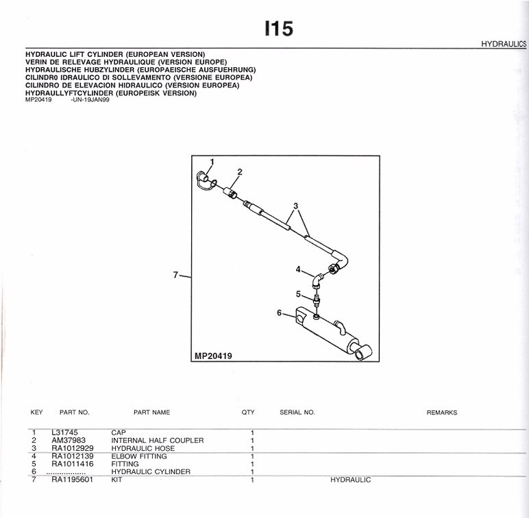

John
It's all set up for top link. Bird and I shortened this cylinder by 1 ½".
Here are the part numbers that I used.
They are from Birds post on how he installed Tip & Tilt on his tractor. Check out the thread on tip and tilt. It's one of the longest except for Chalkley Cup.
HTL2102 Top Link Cylinder
(2” diameter, 20” long, 8” stroke) $185.70 TSC
HTL2202 Side Link Cylinder $185.70 TSC
(2” diameter, 13.5” long, 3.5” stroke)

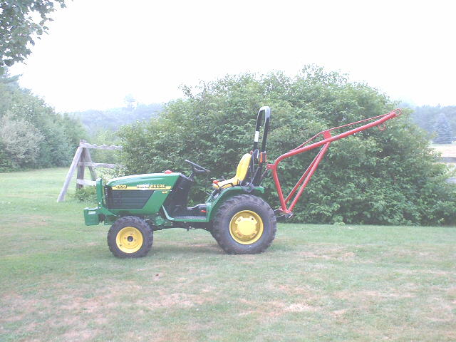

/ Boom Poles #26
Scruffy,
That is a good idea. I have a 12 volt winch kicking around somewhere. I might be able to weld a mounting plate on the end of the boom pole and create a "mini-crane".
Sounds like a good project for my spare time...if I ever get any/w3tcompact/icons/smile.gif. Still, I think I could do it for a minimal investment.
Thanks for the idea.
~Rick
/ Boom Poles #27
Rick, don't forget to add a pulley for the tip of your boom! Don't want to stress the cable more than necessary. You could simply add it your existing 'eye' with a sturdy chain link, or some such adaption, but keep it removable for lessor projects. Looking at your boom, a steel plate with the mounting holes drilled for your winch, and two ubolts welded on the back to clamp to your upright would do the trick.
Have fun with your new fishin' pole!
